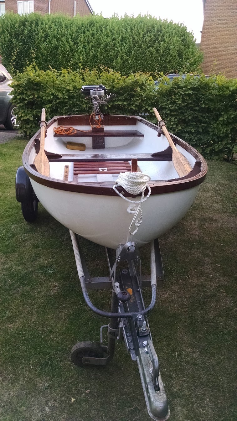

I recently bought these two despite no previous marine experience.
I'll be plaguing the life out of the brains on here during my fettling of my FPC701BB8 Seagull.
Intend on using them on local canals and rivers once done as there's not much coast here in Chesterfield.

Very handy a trailer with a launching trolley. Only snag with a direct drive is that when you start it ----- it goes. I have seen some exciting moments and been part of them.
Nice boat but it looks more suitable for a short shaft seagull. Just read the engine number --- it has a clutch.
Re: Nah then duck...
Thank you, yes it has a clutch and Ohskyetoyman wrote:Very handy a trailer with a launching trolley. Only snag with a direct drive is that when you start it ----- it goes. I have seen some exciting moments and been part of them.
I'm a newbie to this and thought mine was the shorter "standard" shaft as per below from a previous post.
There's isn't an "L" in the serial number and if I measure from tip to toe I get 37" which fits with in chart the info belowThe forty plus was available as a standard shaft or long shaft. British Seagull didn't designate any of their products as 'short shaft'
The maximun freeboard (top of transom to waterline was 16" for the standard shaft and 22" for the long. If yours is a long version there will be an 'L' in the serial.
I've test fitted and it looks like this...will it be ok or do I need to rethink my plan?
Cheers Pricey
The best way to tell is to put it in the water and see, also seating arrangements, are you sitting next to the transom, or four foot in front of the transom, kneeling in the gunnels, with baseball cap reversed for aerodynamic help!

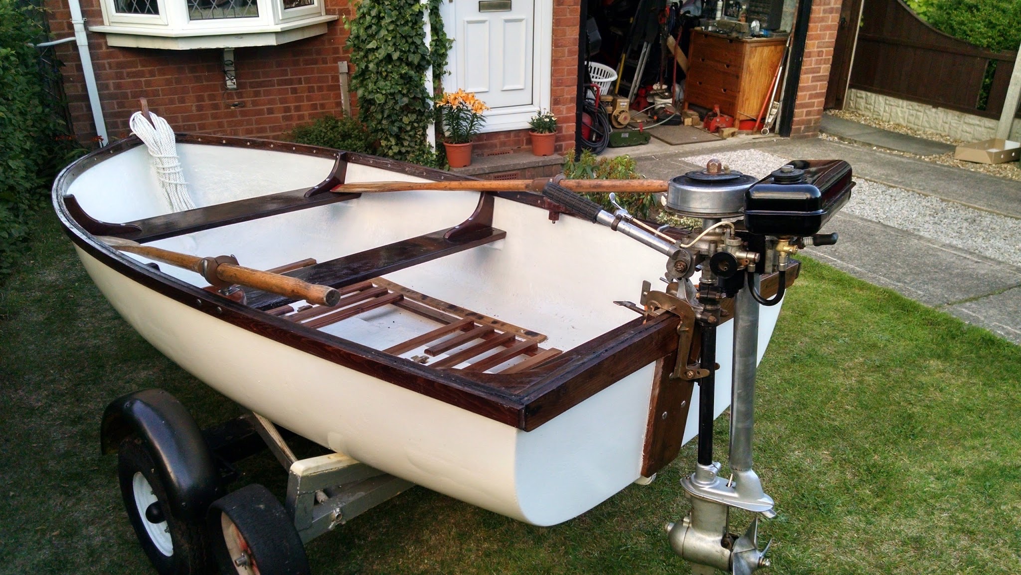

...well it's been a year nearly with work and life in general getting in the way of fettling my little dinghy and the all important Seagull outboard.
A bit rough around the edges but better late than never, eh?
Nice job, the clutched 40 is a great engine to own. We will look forward to further posts, you can never own just one...
