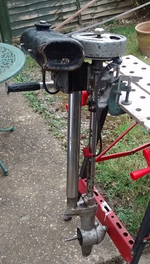

Hello, new to the forum. I have just purchased my first seagull for £15 at a car boot sale. From the website ID tool it is a forty plus model from April 1966. It is fitted with the Bing carburetor.
Initially it appeared to have a seized piston, as it is not possible to turn it, even with a big spanner on the dome nut. However having separated the cast iron block from the main alloy housing, I can pull the block away from the housing about 1/2", and the piston moves up and down in the bore. It appears that the crank itself will not rotate. The dome nut looks at a slight angle, I wonder if it has been dropped and the crank is bent. The propshaft wiggles very slightly so I do not think it is seized at that end.
It has the Bing carburetor, with a plastic float chamber, does this tend to run well or should I consider swapping it for the villiers? The air filter and choke flap is missing.
A few bolts will not come free so I am soaking it for a few days and will try some gentle heat from a blow torch. The head bolts came out very easily as they appear to have been replaced with stainless ones.
The head gasket appears to be four layers of copper, is this normal??

Thanks for your advice. As you can see from the photos I have a few parts to source. I have a little experience with classic cars restoring SU carburettors, so I am hoping I can get this seagull up and running.

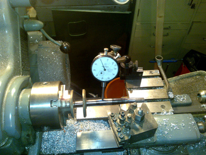

Re: Crank appears to be seized on a forty plus model??
Bent crank, replacements are readily available, and cheap.
Or you can have a go at straightening it.
Post some more pictures, we all like a few pictures.
You will need to do a total strip down to see what else is damaged, in the power head.
It sounds like it may have been for a swim.
They can be straighten easily if not twisted.

Yes I think a complete strip down would be wise. The dome nut looks like it was hit hard, the thread is bent as it exists the dome nut. I think this will require straightening aswell.
What level of runout can I get away with? and to straighten it, tap it with a soft mallet? any heat? I have yet to remove the crank. If I can get it out over the next few days, I am visiting someone with a nice lathe and a dial gauge which would be useful.
MorrisMan wrote:What level of runout can I get away with? and to straighten it, tap it with a soft mallet? any heat? I have yet to remove the crank. If I can get it out over the next few days, I am visiting someone with a nice lathe and a dial gauge which would be useful.
You will not need heat, give it a bash with a mallet, I managed about 1.0 thou, you will know when it is near enough when you get it back in the crankcase.
If the crankshaft is twisted or crankcase is distorted it may be harder to sort out.
Good luck, I have straightened a few and they work perfectly.
You can always pop a 5/8" reamer through the assembled crankcases if you think it is a bit distorted. Worth trying before looking for a new crankcase.
