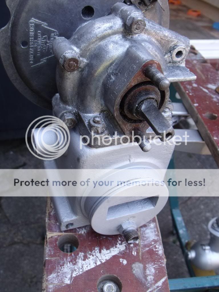

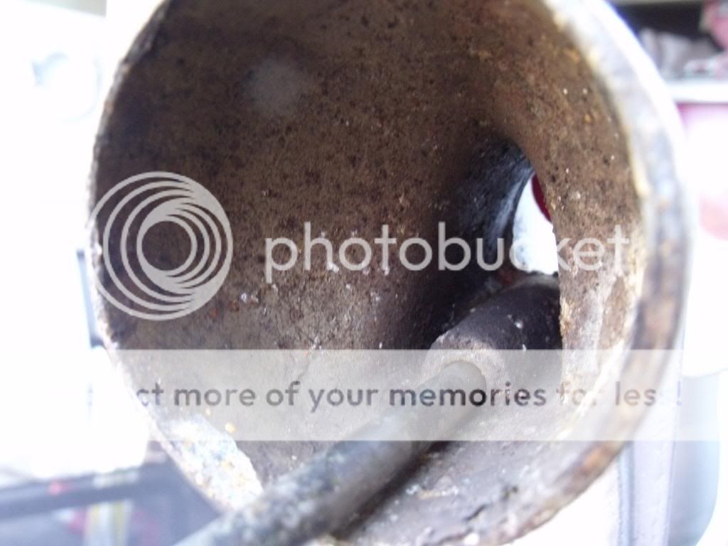

1650bullet wrote:It doesnt look like a crack to me.
The additional cleaning has shown up a vertical displacement along an irregular line, on a flat machined surface.
This is where they can crack, because of the pocket behind this area.
I could be wrong, crack detection spray would help, perhaps.

H-A. Just have a look again on page 5 of this thread. Ive just had another look and it seems all good on those pics. What do you think :?:

I am going to use it as i have seen much worse on other engines and on a previous page here HA put up a proper exhaust port crack picture - I am busy resanding the block and crack case as we type

1650bullet wrote:H-A. Just have a look again on page 5 of this thread. Ive just had another look and it seems all good on those pics. What do you think :?:
I have looked again, and stand by my original conclusion.
The machined face of the exhaust stub has a step in it, you can see tool marks on the low area and on the higher area.
The left hand portion is expanding outwards due to expansion of rust within the stub.
But it will still work, that is the beauty of Seagulls :lol:

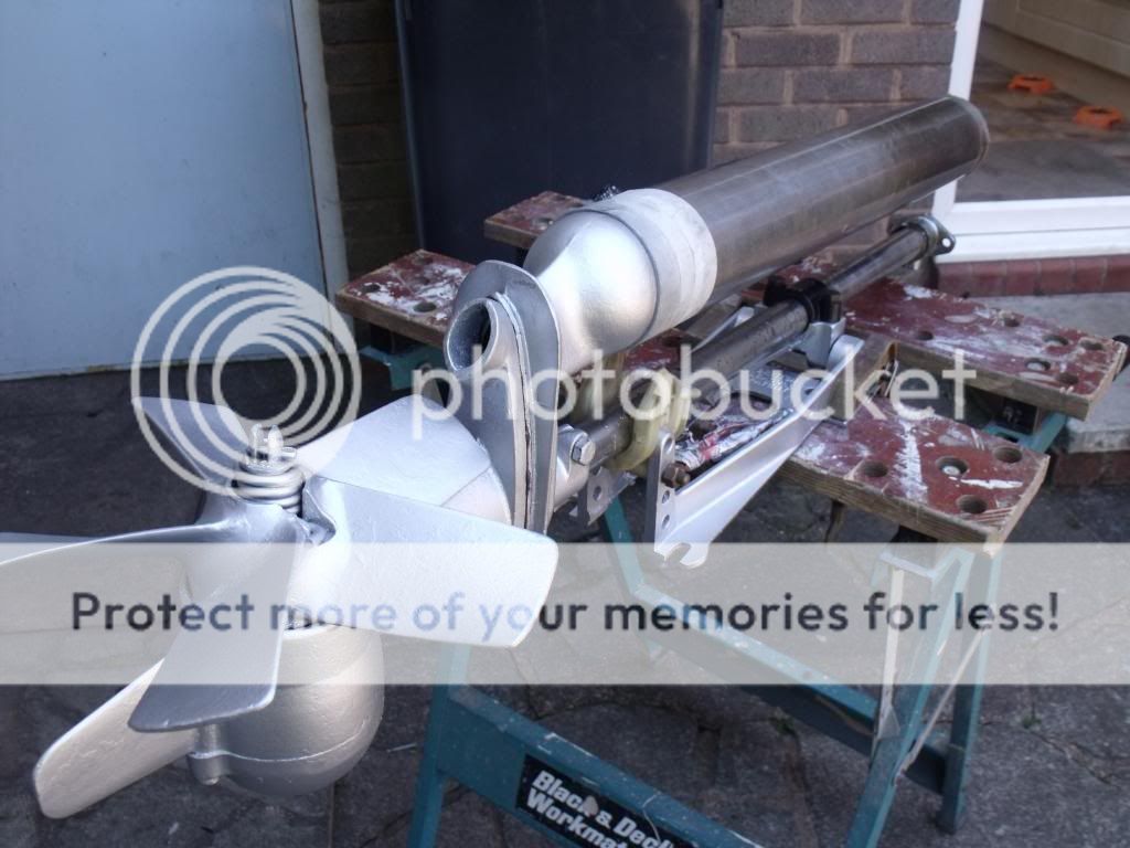

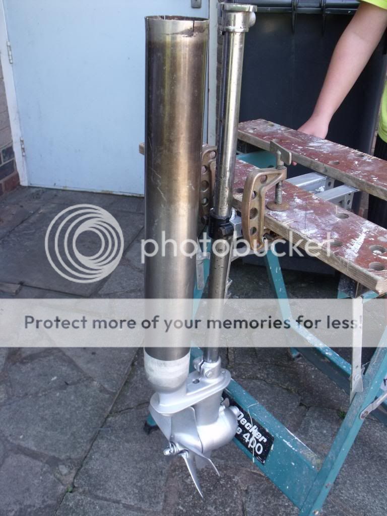

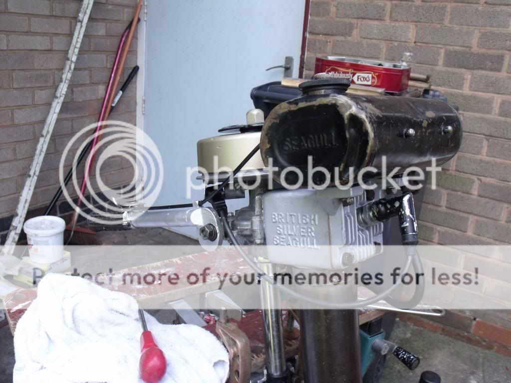

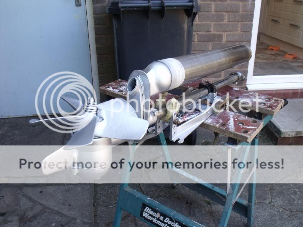

So today i reassembled the seagull as I can't get at it for 2 weeks after today and i thought it best to put it back together so as i remember how it all goes - I still have to do the tank ( can't make my mind up whether to brass it or seek out the original paint colour?) - any how that is a decision for later .
Started this at 2.30pm today.
Water pipe connection bottom of exhaust

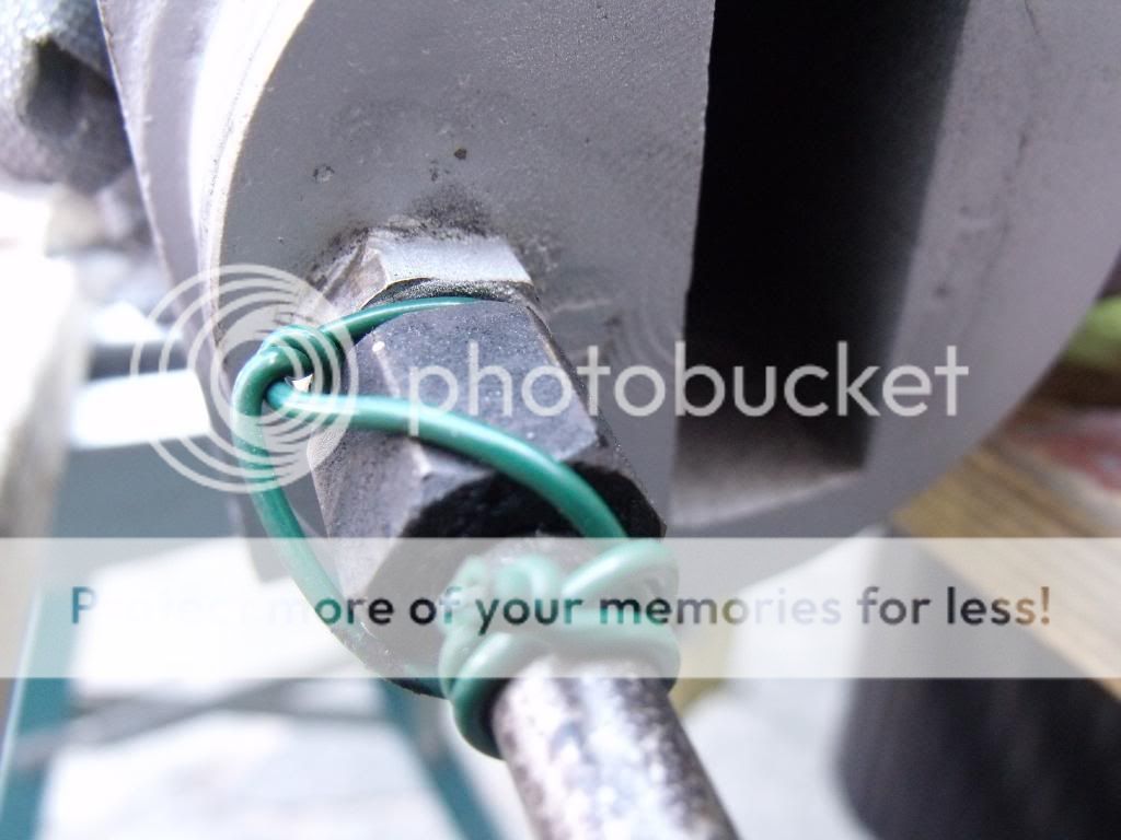

Top end with securing wire
finshed at 4.30 - I still have a bit to do - tank - gb gasket - bottom crank case etc - but it is getting there :)

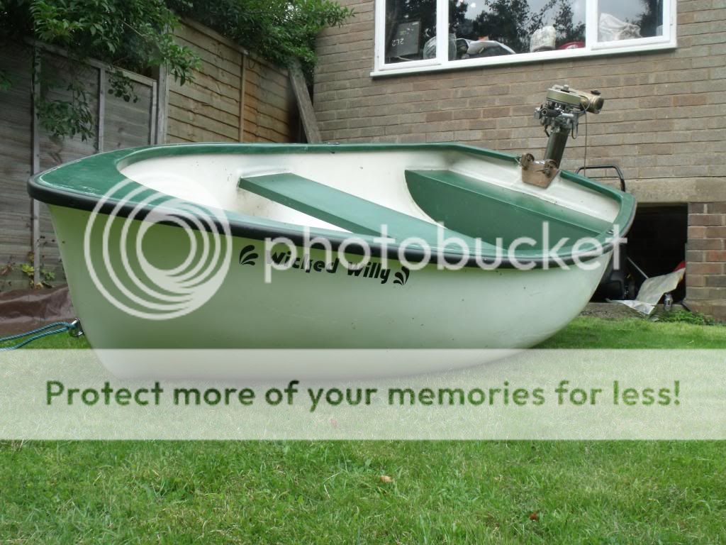

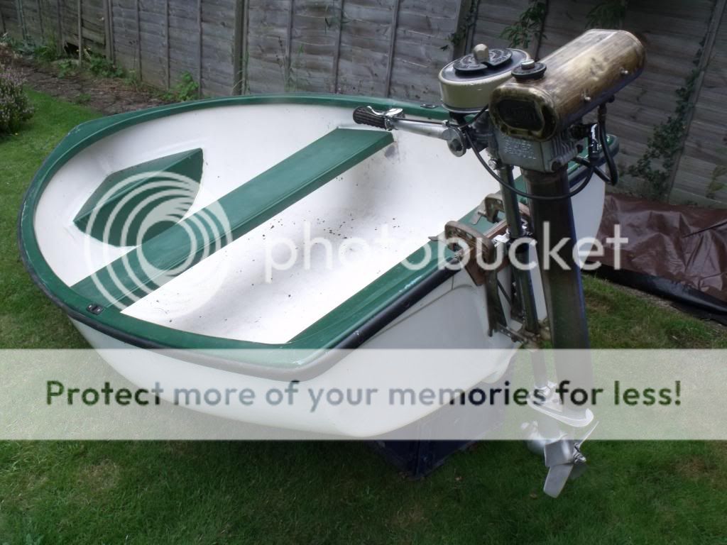

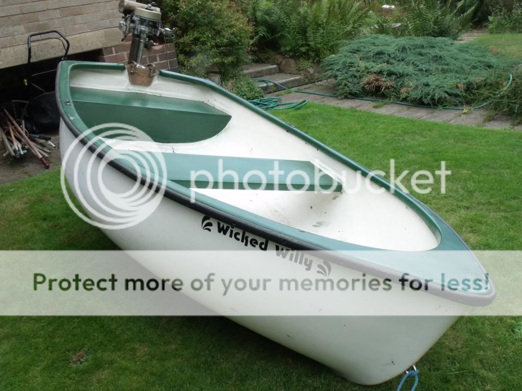

Just a quick update
I put the seagull back together a few weeks ago and gave her a pull - she started first pull and ran like a dream. She pumped water very well and sounded sweet, I had cured the hunting issue and stood back well pleased whilst she ran merrily in the half filled recycling bin - Suddenly after half an hour the water stopped pumping she clattered and I switched her off tout suite - On taking her apart I discovered a shattered impeller - on closer inspection I saw my schoolboy error , I had put the driveshaft tube on 180 degrees out - if you look at the driveshaft tube it is offset and if fitted the wrong way the impeller sits skew whiff in the rebate - A new impeller- gb gasket and £11 lighter she was back on the road so to speak - you gotta laugh :oops:
Anyhow - i set her up on the dinghy just to see how it all sits etc and i am pretty well pleased atm - I am stripping the tank ready for a respray but this is how she looks on the back of the boat.
I will sort the tank now I know she is working well and sort out a way to fit the bottom bolts on the bracket ( I can't access the rear inside of the boat as it has a fully built in seat!) I am however enjoying the seagull experience so far :)
