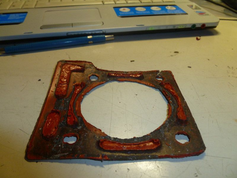

I had my silver century cylinder not well sealed with the cylinder head. When outboard runs I could see water drops appear at the point of the copper gasket. I decided to replace the copper gasket with one of permanite. But this gasket was harmed by the water. I decide to apply one layer of red gasket maker silicone (permatex) to each side of the the permanite gasket. The sealing was outstanding. No leak in or out. But silicone does not transfer the heat to the cooling water so the cylinder head started heating up. I realised the problem in time so there was no damage. Now I am looking for a material that that seals like silicone and transfer the heat as the copper. Or just a new copper gasket would do the job. The old one was not much used so I am wondering if copper is not too flexible to seal like silicone.

Now the problem is far more viewable. The exceeding RTV create a thick layer in the holes where the coolant water flows. I believe this did not allow thermal exchange between the water and the cylinder head. If I place RTV in small amount and only on the block and not on the cylinder head, I will avoid exceeding RTV block waterways?

Stelios...what you need is a thin smear, the stuff will get everywhere otherwise!
Apply it careully, no problem!

Can I get the desired result only by using RTV in thin smear and without using the copper gasket? I believe the copper one does not seals too good as RTV.

OK. No way to run it without copper gasket. If I add thin smear of RTV would things be better? Am I supposed to smear RTV on the cylinder head, on the block or both?

Scrape the gasket clean with a razor blade then the thinnest, meanest smear of Red Goo on either side should, if you will excuse the pun, seal the deal.

Interesting product. Good to have more than one solutions. I tried with a thin layer of RTV applied only on the block. I believe it didn't go into the holes where the water flows. I will try run it in a week to see the result.
It was beneficial that petrol removes RTV, so if temperature go up I will know how to remove it.
