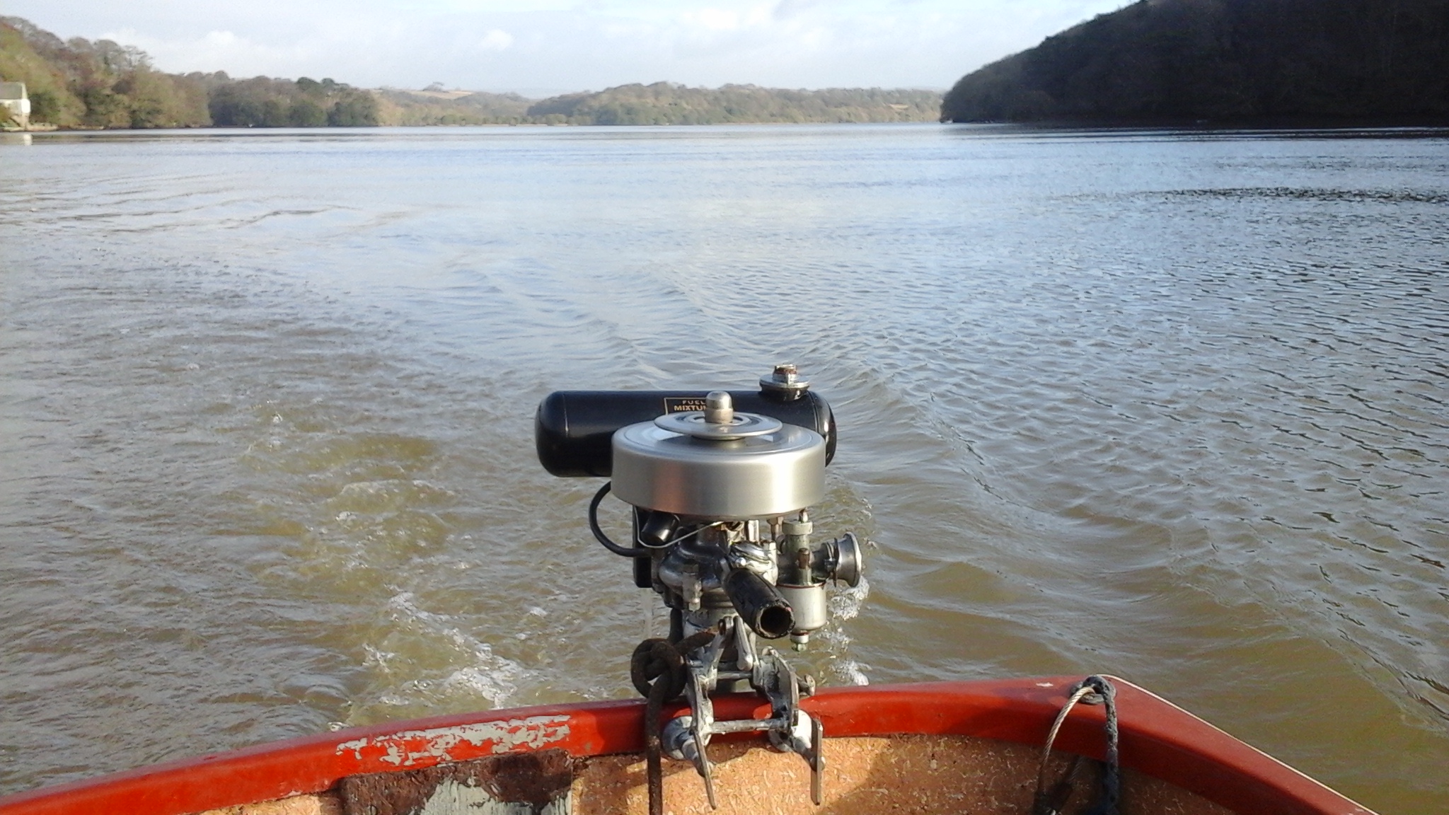

This post started with me considering what alternatives there are to replacing a failed Villiers M1634E coil as used on the early series 40 and many others. I have purchased a much cheaper (and 0.5" shorter) coil and fitted it to FV5141. Over the last couple of months, I have started and ran it in the tub, where it started and ran very well. Yesterday, I took it to the Yealm estuary in South Devon, UK and gave it a longer run.
As expected it started and ran well. It was a good opportunity during this wet and windy winter, to get out on the water with FV5141 in weather which was quite pleasant:-
Anyway, it is up each person as to how to resolve a the problem of a failed Villiers coil. I am happy with what I have done with FV5141 and I expect it will give me the reliability that I require.

Cannot work out why the photo has not been loaded, so here goes again:-

For the last couple of weeks I have been on the water in South Devon with FV5141 which has been fitted with the cheaper and smaller M1361 coil. Charles L suggests that it needs a total running of 24 hours before it can be regarded as a 'good' replacement. Quite a lot of running in a small tender/dinghy!
I have confidence in it. It starts first pull 95% of the time. I am using an old 8 COM plug. However total running to date is about 5 hours. Another 19 hours to go! As I will be using my other FVs on my dinghy, it is going to take probably another 5 or 10 years before the 24 hours is achieved.
I think that I am not going to try to achieve the 24 hours. I am happy as it is. I will leave it to the individual to decide what to do when a Villiers coil fails in a 40 Series. The choices have been discussed in this topic.

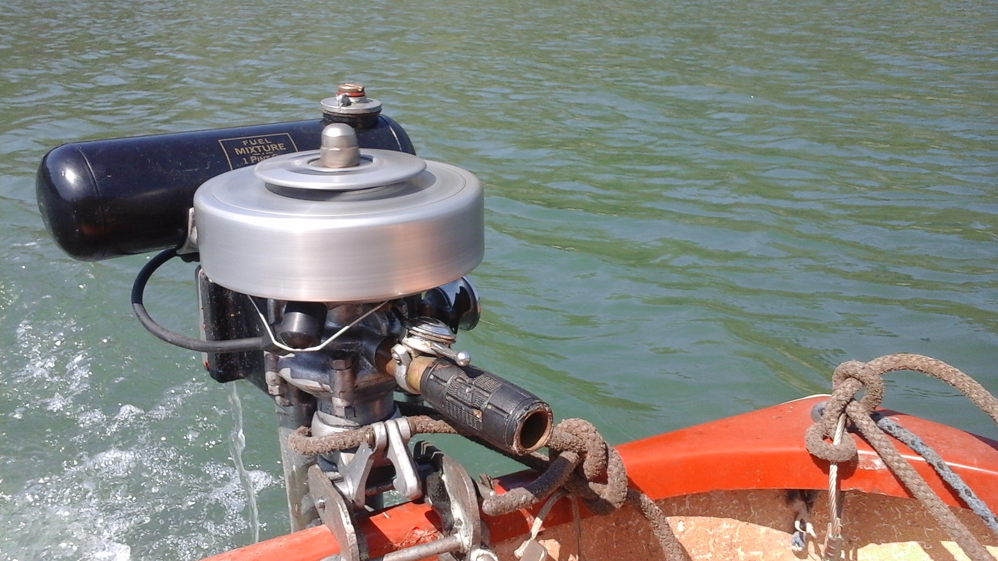

FV5141 with its M1361 coil is still going strong. Here is a photo of it doing what it was designed for - pushing a dinghy along. This was last week on the Yealm estuary in South Devon, UK.
I know Charles L. wanted to see how this coil stood up to 24 hours use. Well, the total now is about 9 hours - so some way to go! Starting, using an old 8 COM is 95% first pull.
Just a reminder that the M1361 coil for the Villiers magneto is about £25 in lieu of the £65 for the correct M1643E coil.
Putting financial considerations to one side, I would recommend the £65 M1643E, but in real life ……….
