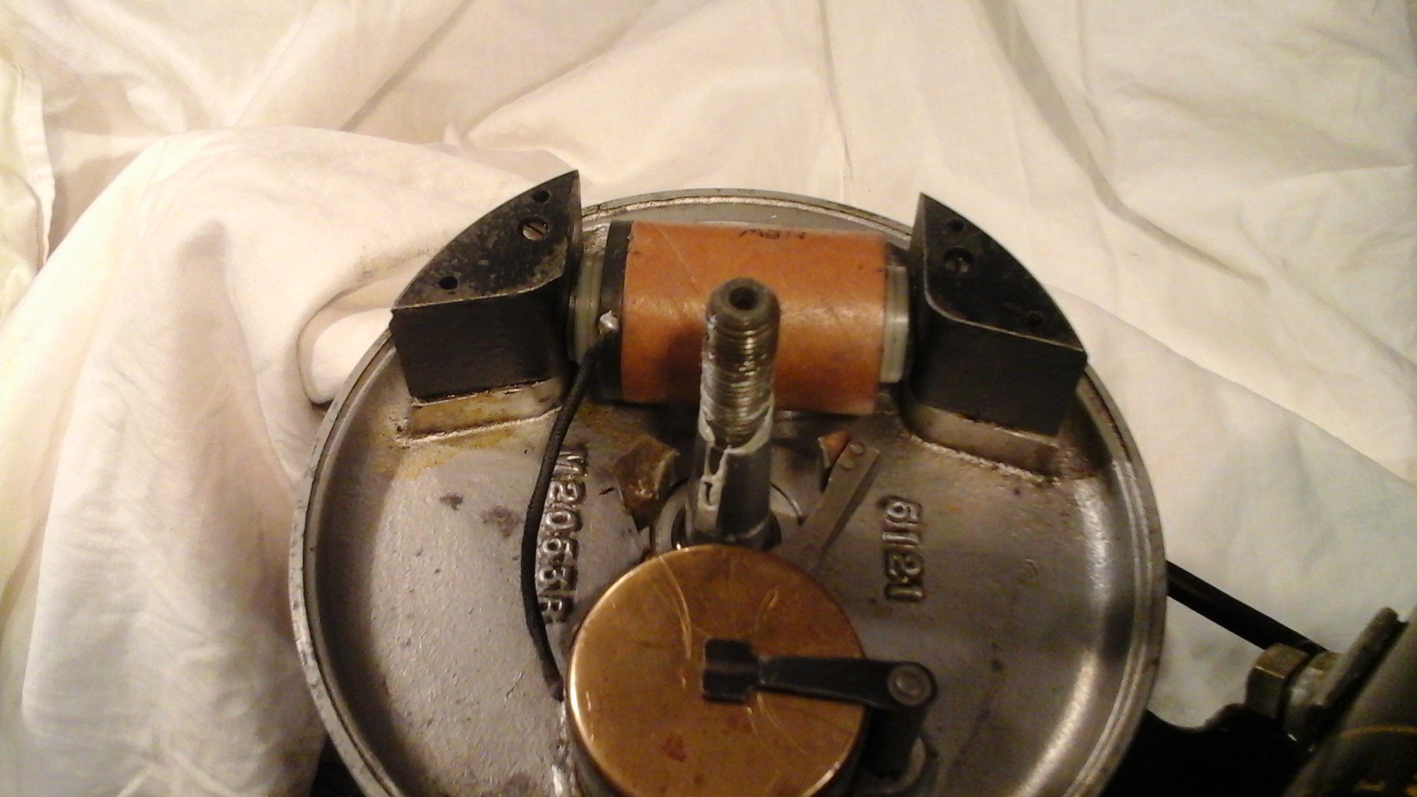

I have finally got around to finishing the restoration/refurbishment of FV5141 and have fitted the cheaper and shorter M1361 Coil.
As planned I filed grooves on each end of the core, so that the longer 2BA set screws that I used would fit into these grooves for longitudinal and rotational security of the coil. These screws were loctited into position. Additionally nylon washers were used between each end of the coil and the pole pieces to create a snug fit. The pole pieces were the type used in the very early FVs, having been drilled and tapped 2BA from the top rather from underneath. This made the fitment after the filing of the core quicker and easier. A small copper pad was soldered to the HT connection.
The engine starts and runs well, although I have not had an opportunity to run it on a dinghy yet. I hope to do that in January, although I do not expect any problem and I anticipate that the reliability would be the same as for the original coil.
Is this the best solution to the problem of a failed Villiers coil and a non functional series 40 engine? The answer is clearly No.
The best solution is to purchase the correct M1634 coil at £65 instead of this cheaper M1361 at £24. Other M1361 coils are available at a slightly higher cost. I do not know to compare the quality of these different coils. Perhaps the more expensive ones are better....
I put great store in originality and so will probably not repeat this type of repair again. But if saving £40 enables a static non functional engine to be made into an engine that can be used reliably, then clearly it is a serious option.

FV5141 with the M1361 coil starts well on the first pull. I have yet to give it an extended run. I do not expect any problems, but one never knows . For this reason I cannot recommend this modification at this stage.
I have attached a photo of the installation.
