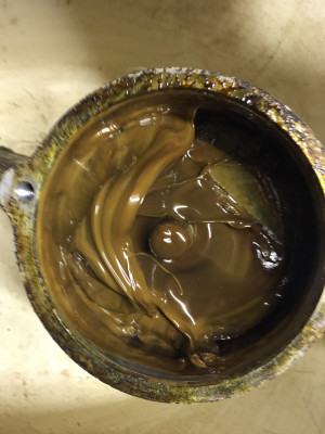

Water jacket cleaned out, and gearbox examined tonight, it was pumped completely full of grease! Under some pressure too, as the end cap lifted off, when the bolts were undone. Dirty horrible job getting it all out :oops:
Now all cleaned out, just that broken bolt to have a look at. Good news is that there is no wear at all in the bushes.

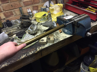

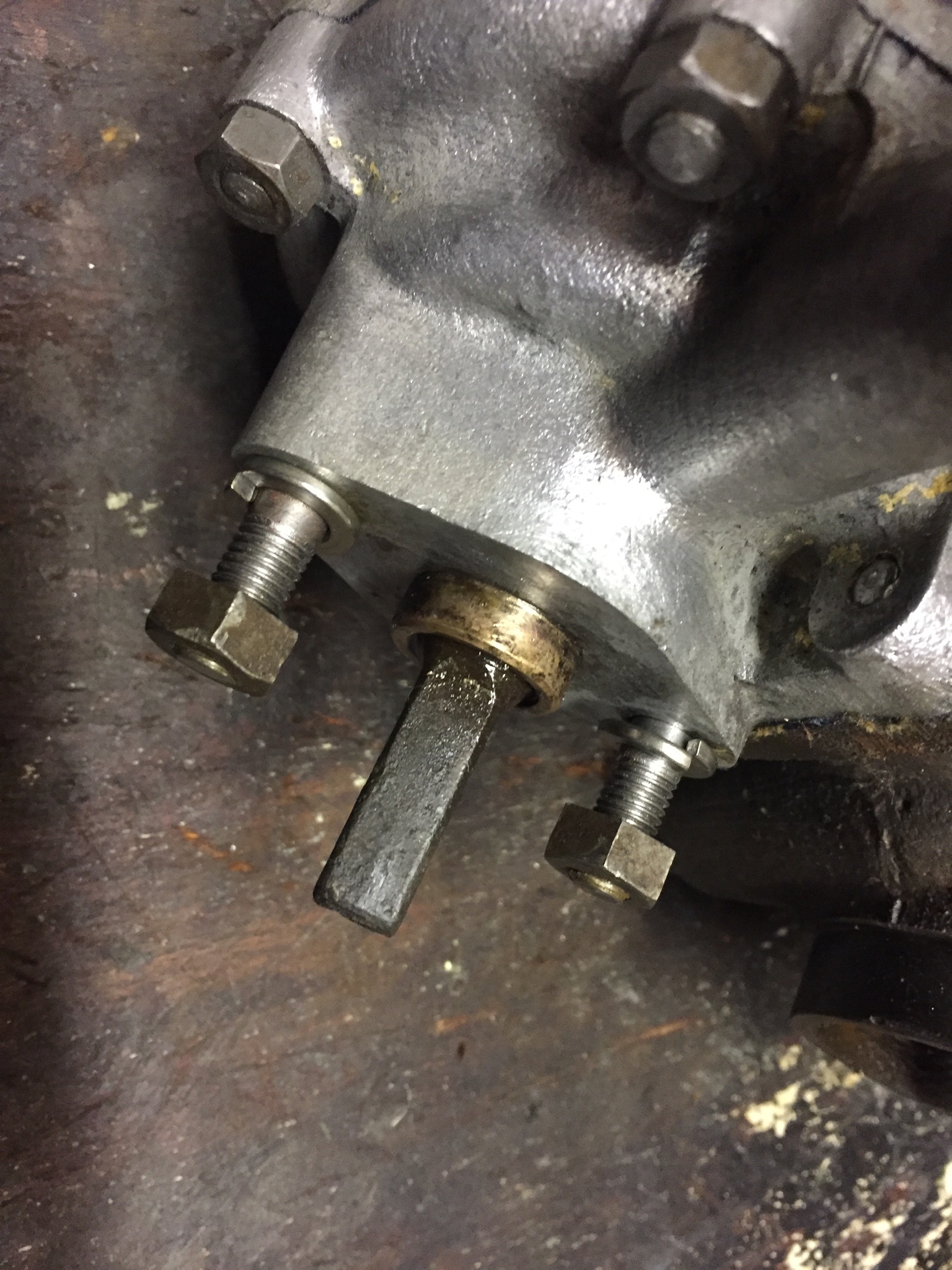

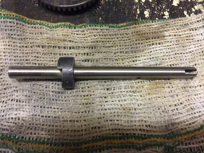

Whilst cleaning the gearbox parts I noticed the prop shaft was bent. A bit of persuasion sorted it out.

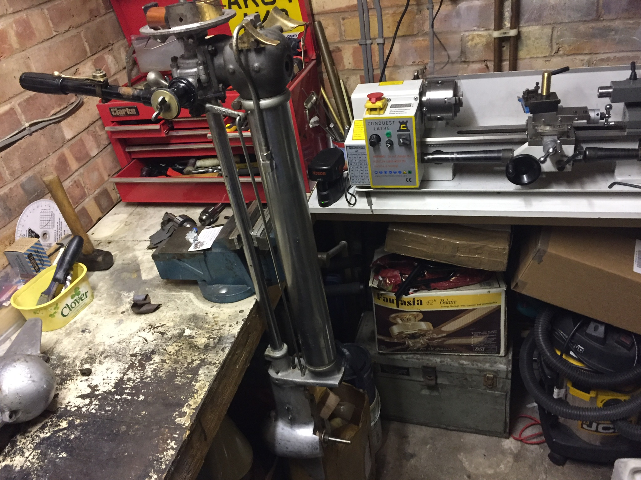

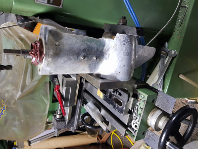

Welding a washer and a nut did not work, just sheared it off again, so plan b.
Pop it in the milling machine and drill out 6.8mm or No. 22 drill.
Will wait till the weekend so I have a bit more time.
I was quite surprised how big it is, should have a 40HP on top :lol:
Re: HSD12704.L
Looking good. That bolt was proper solid, I heated it up first, and it still sheared! Like the mounting in the mill 8)
Thanks for the help 8)

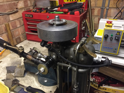

Powerhead now back together, new securing studs fitted, a few rust patches on the cylinder wire brushed, and wiped over with WD40, no other work.
New coil arrived, quick delivery from George, so magneto will be back together tomorrow, good progress :P
I’m doing little or no cosmetic work on this engine, given the general good condition, as I want to preserve the patina, but it will be fully overhauled.

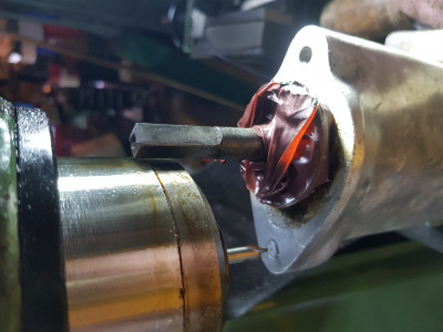

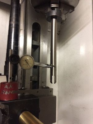

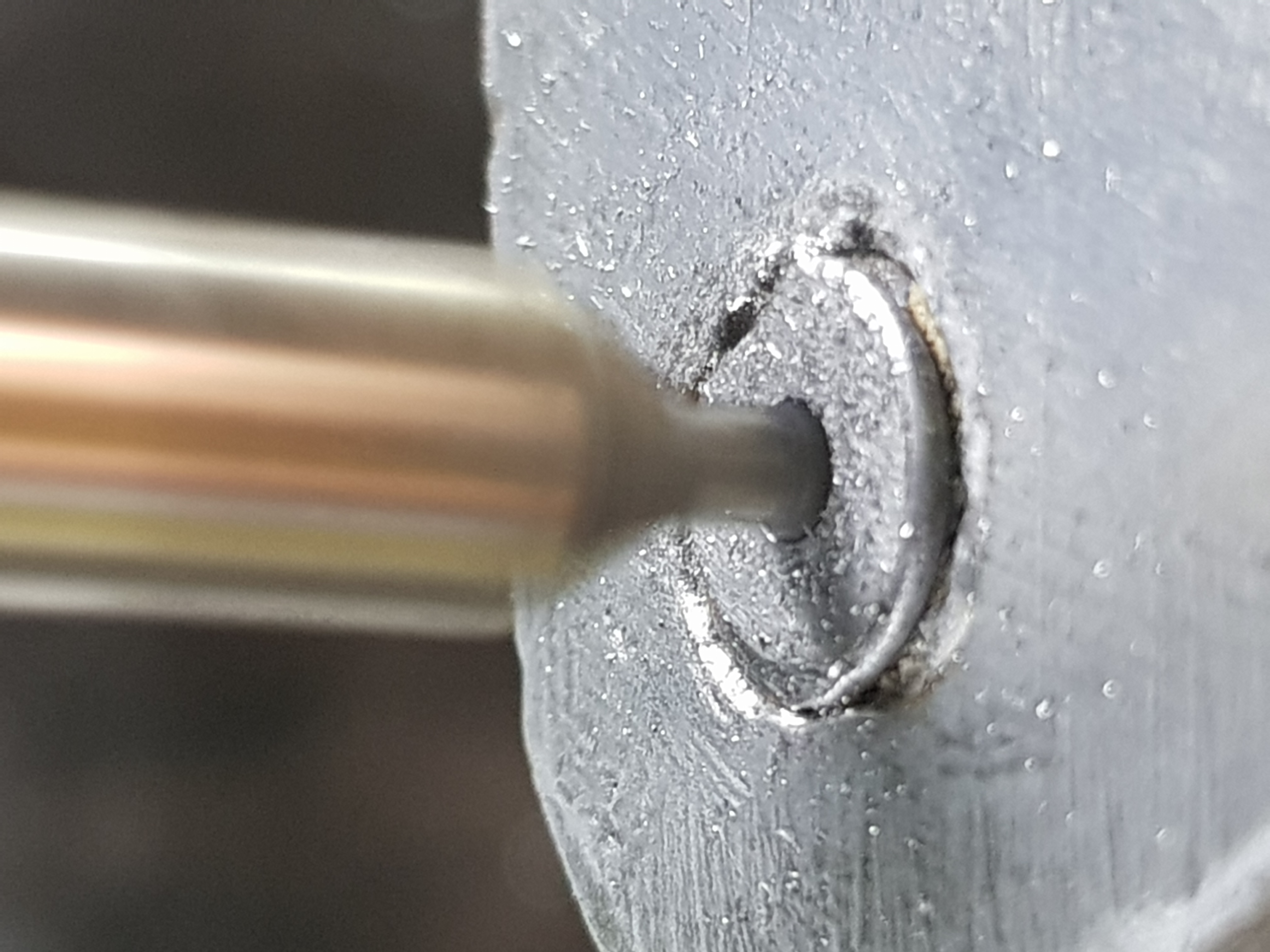

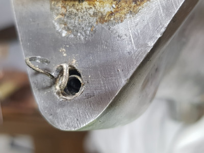

And the stuck bolt is out, took a bit of work but result is pretty good.
Just fitted in the mill with a couple of mil clearance.
Center drilled first, then followed up with 6.5mm drill.

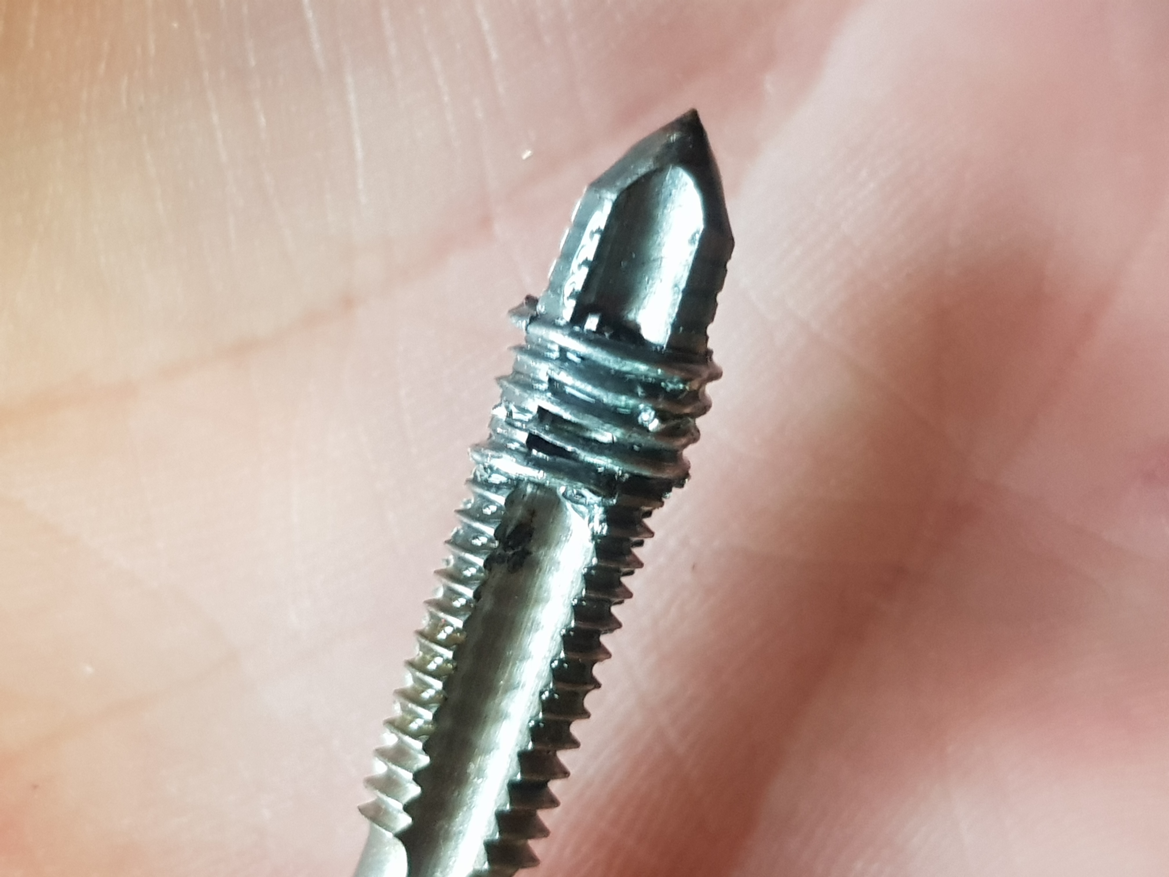

Nice when you can uncoil the threads
And some of it comes out with the tap
Worked out well, thread is all there but a little looser than a fresh thread, If you are making a new bolt, make it a few thou bigger.
Good result I feel.

Nice one :P I’ll make a slightly bigger bolt, and just nip it down. Perfect 8)

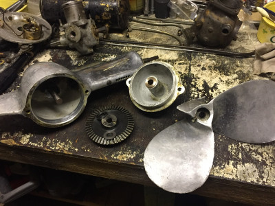

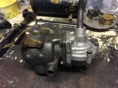

More progress, gearbox arrived from from H-A, engine now coming together :P next job to overhaul the HT lead, petrol tap and tank, again minimum work to overhaul but no cosmetic work other than cleaning and making good.

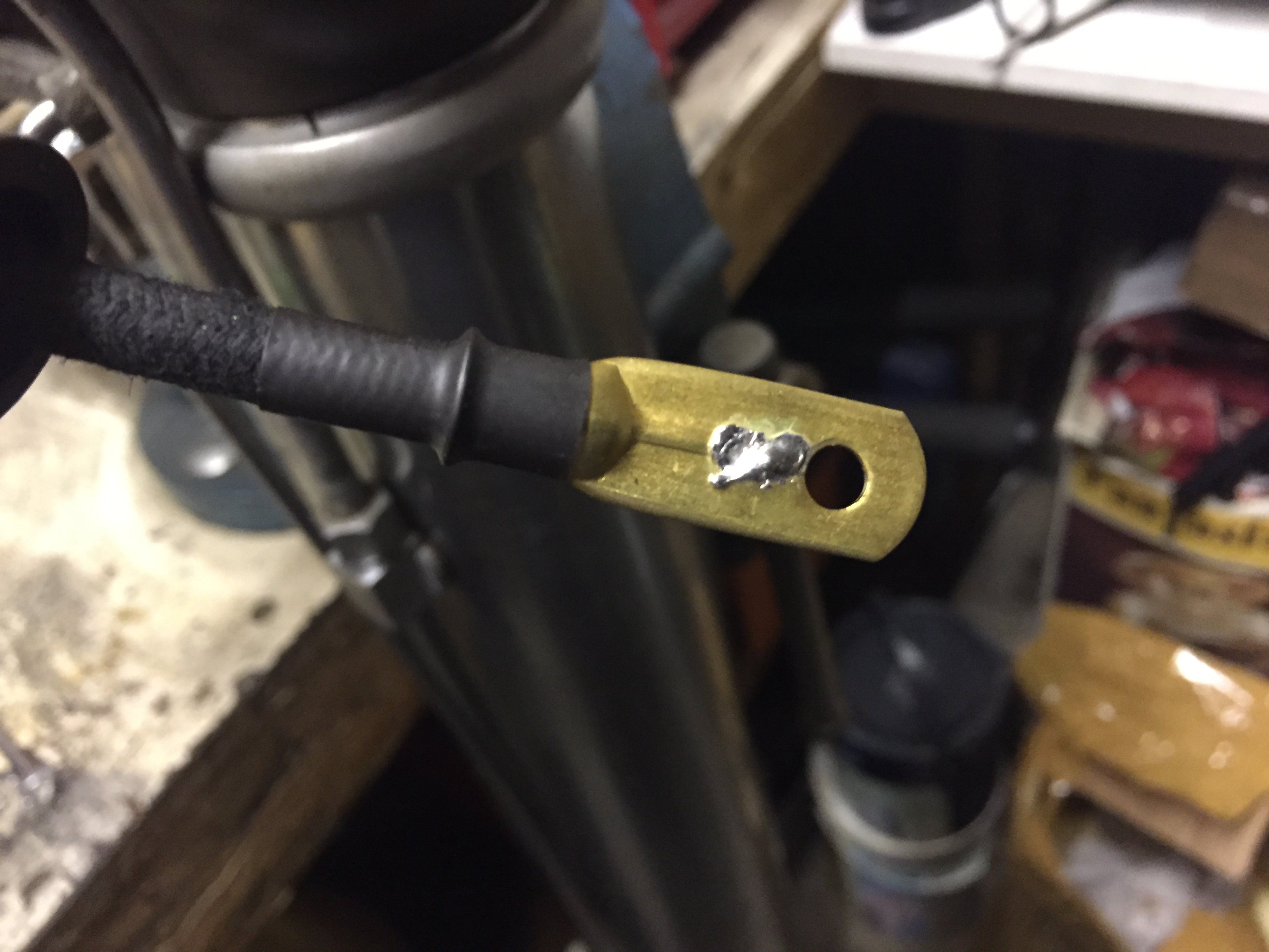

Doing a bit more, HT lead made up, using cloth covered cable, magneto assembled, and tested, nice blue spark from a NOS 8 COM plug! Carb stripped for cleaning. Just waiting a pair of new jets from John, and the gearbox end cap gasket, seems I got the last two John had in stock 8)
Just the tank to clean and fuel tap to overhaul, then finished :P
