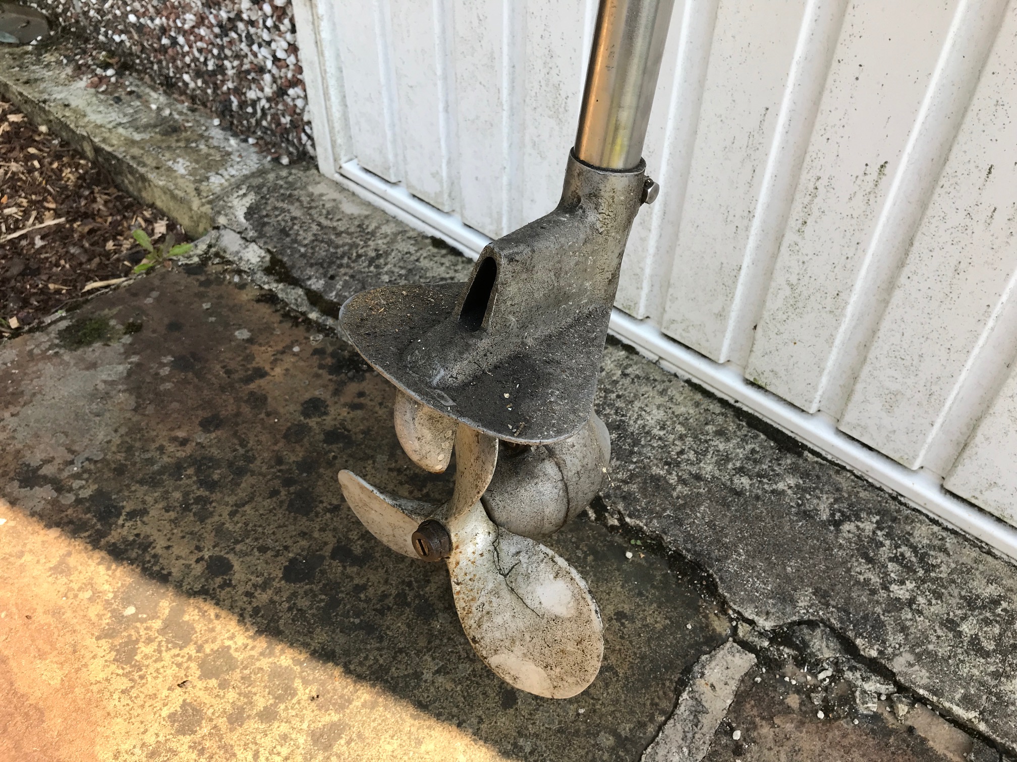

The motor was passed to me a couple of years ago by a friend who had cleared the shed of a deceased gentleman acquaintance.
I have been bringing old motorcycles and bicycles back to life previously, so restoring an outboard motor is all new to me.
There's the excuses declared for when I inevitably ask dumb questions.
I've no idea what to do with this engine when restored as I don't possess a vessel to clamp it to

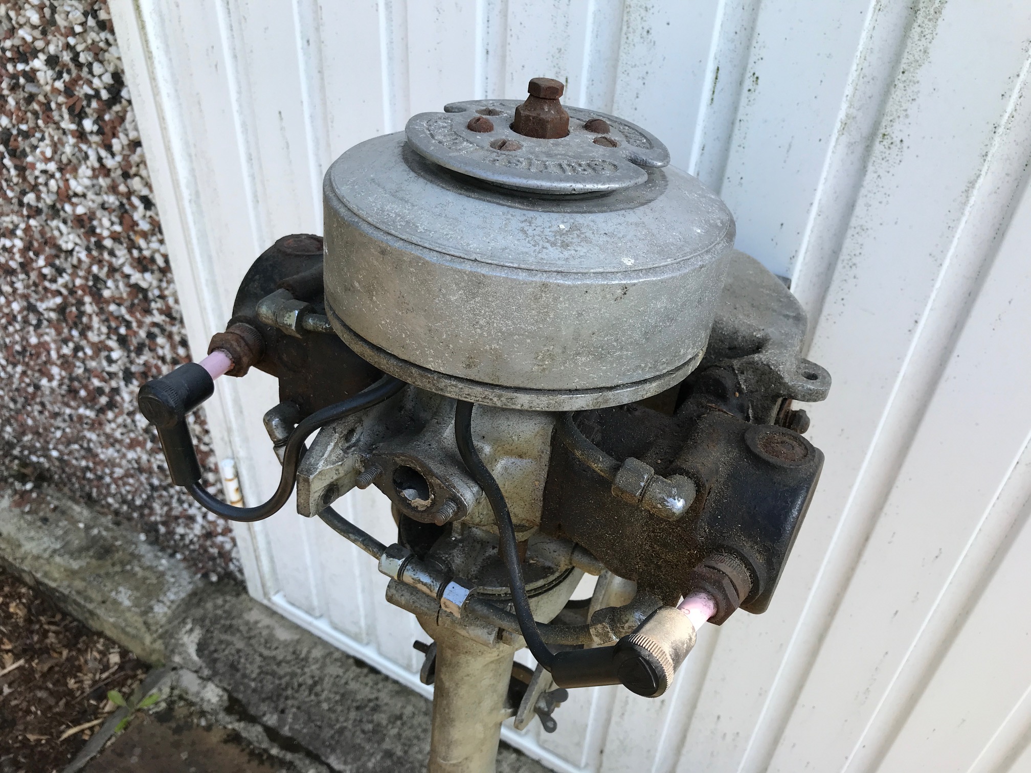

The motor is complete apart from the original tiller arm missing.

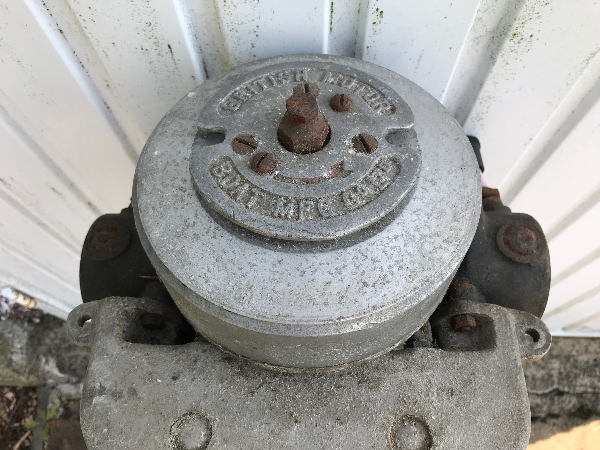

I believe it to be a MK 1, based on the carburettor top (referenced from the user manual)
The carburettor leaked badly. Subsequent investigation revealed a stripped thread in the bottom of the carb body. 5/8 UNEF apparently (0.625 x 24tpi)
I have a lathe, so I intend to insert a newly threaded sleeve into the carb body. I sourced a 5/8 UNEF tap from Ebay.

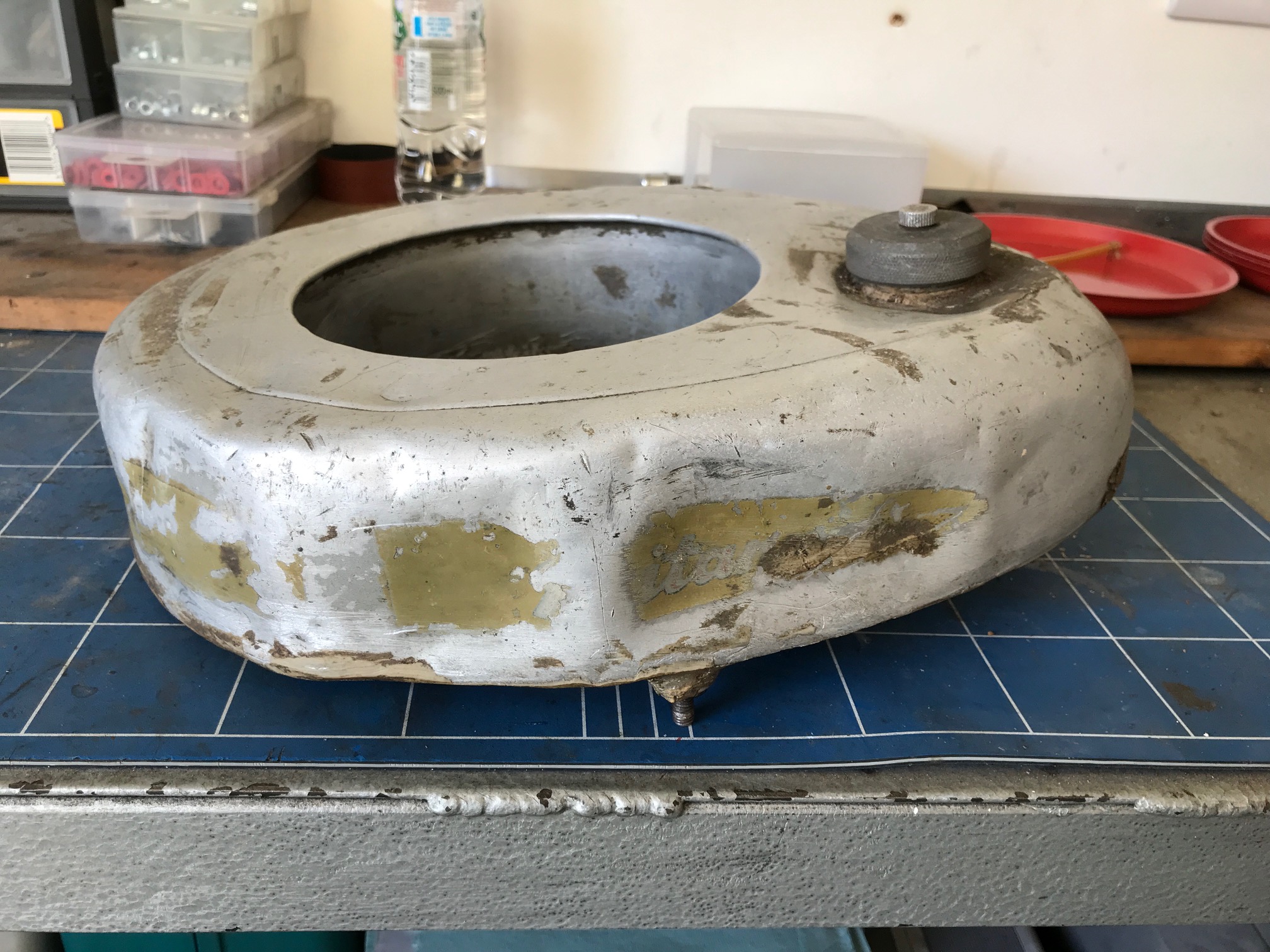

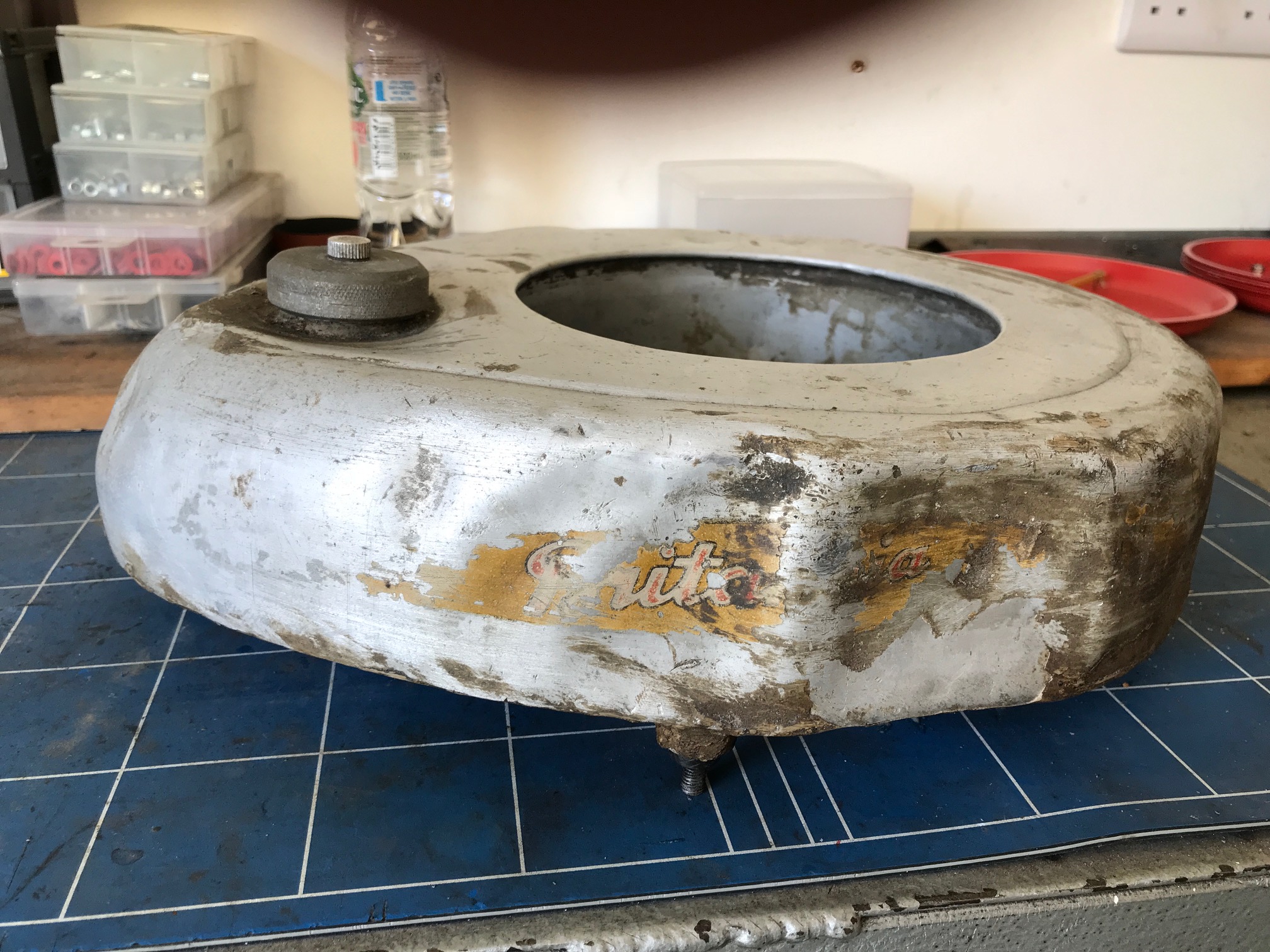

The fuel tank is badly dented and probably leaks.
I had the engine running briefly before consigning it to the projects awaiting shelf.
Any comments would be welcomed. Any guess as to age? Any suggestions for restoring the tank?
