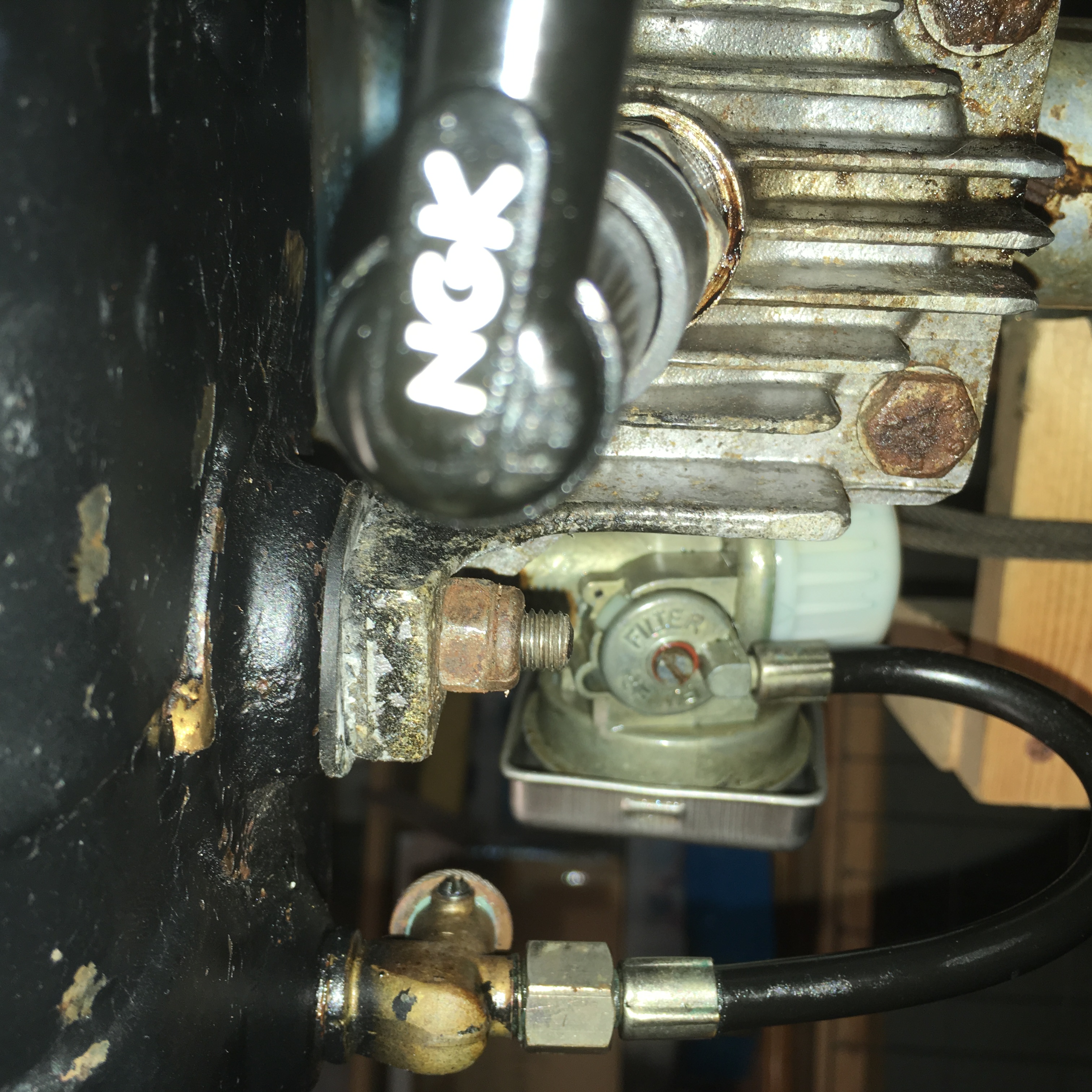

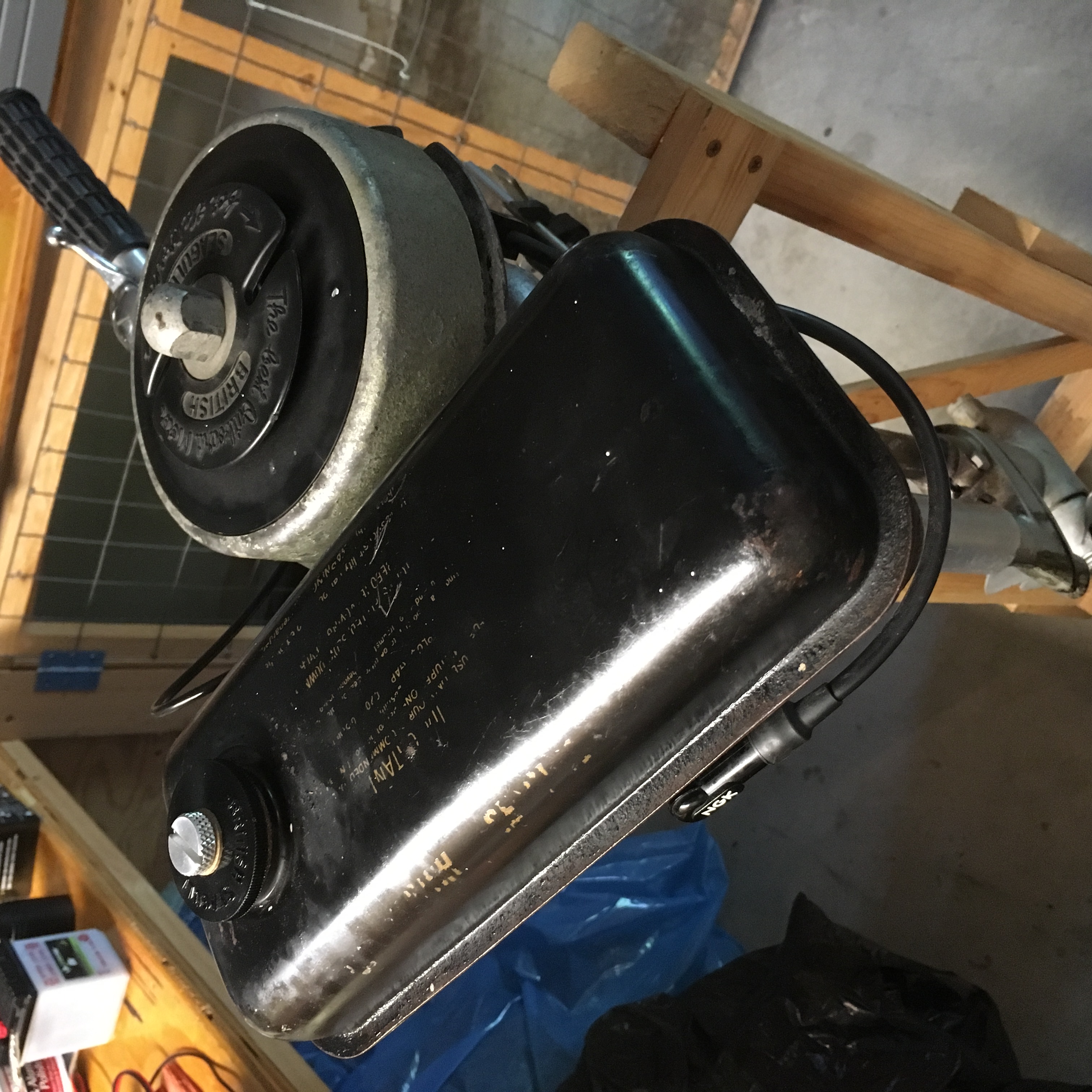

Hi,
I am missing one of the two studs which are screwed in to the bottom of the fuel tank. The other ends pass through the two holes in the cylinder head to and fastens with a nut to secure the tank.
I am pretty sure the stud shaft is 5/16” I am not sure if it’s a BSW thread or not. I presume it is but I don’t know.
I would be surprised if it’s not a standard bit of British industrial hardware but I have no idea where to find one. Any help understanding the dimensions, thread standard, and sourcing clues would be greatly appreciated.

Pete, shine a light inside the tank so you can see how your tank is constructed, the thread is 5/16 BSF.
There are several different tanks used on Seagulls it would help if we knew the model (serial number)?

Pete look inside the tank at how that thread is fastened there, then you will understand the difficulties your facing!
Re: 40FW Fuel tank stud needed
Tank mount is also the little stub that sticks out of the back of the tank.
Thanks H-A a perfect picture! worth a thousand words.
The only means of attachment is by two studs that screw into two reinforced plates on the bottom of the tank. The studs pass through the two holes in the cylinder head and secured by nuts as you can see in my photo.
