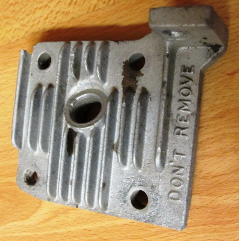

I guess this is what happens when a puller is used on a Seagull flywheel ?
The missing weight will not effect the rotation much, the missing strenght may well do so?
Is the flywheel now scrap?
If so its a shame, as the parts bin I have now is very thin and not a great deal is left.
Note, this picture shows the flywheel as found and in the bottom of the steel case it came in, it was not painted and the metal has just got some light corrosion on it, I blasted it clean later for a better inspection.

Didn't we tell you not to use a puller on any Seagull flywheel especially a Wypac as they're BRITTLE!
You can probably tell us, why we said that.
As for even thinking of using it, it's you who's going to get hit when it lets go big time, it's too far to travel for us, to attend the funeral!

Who said that I used a puller? it was not myself.Charles uk wrote:Didn't we tell you not to use a puller on any Seagull flywheel especially a Wypac as they're BRITTLE!
This was part of the Seagulls box of spares that I was gifted.
Cleaned up the flywheel looks not to have been used?

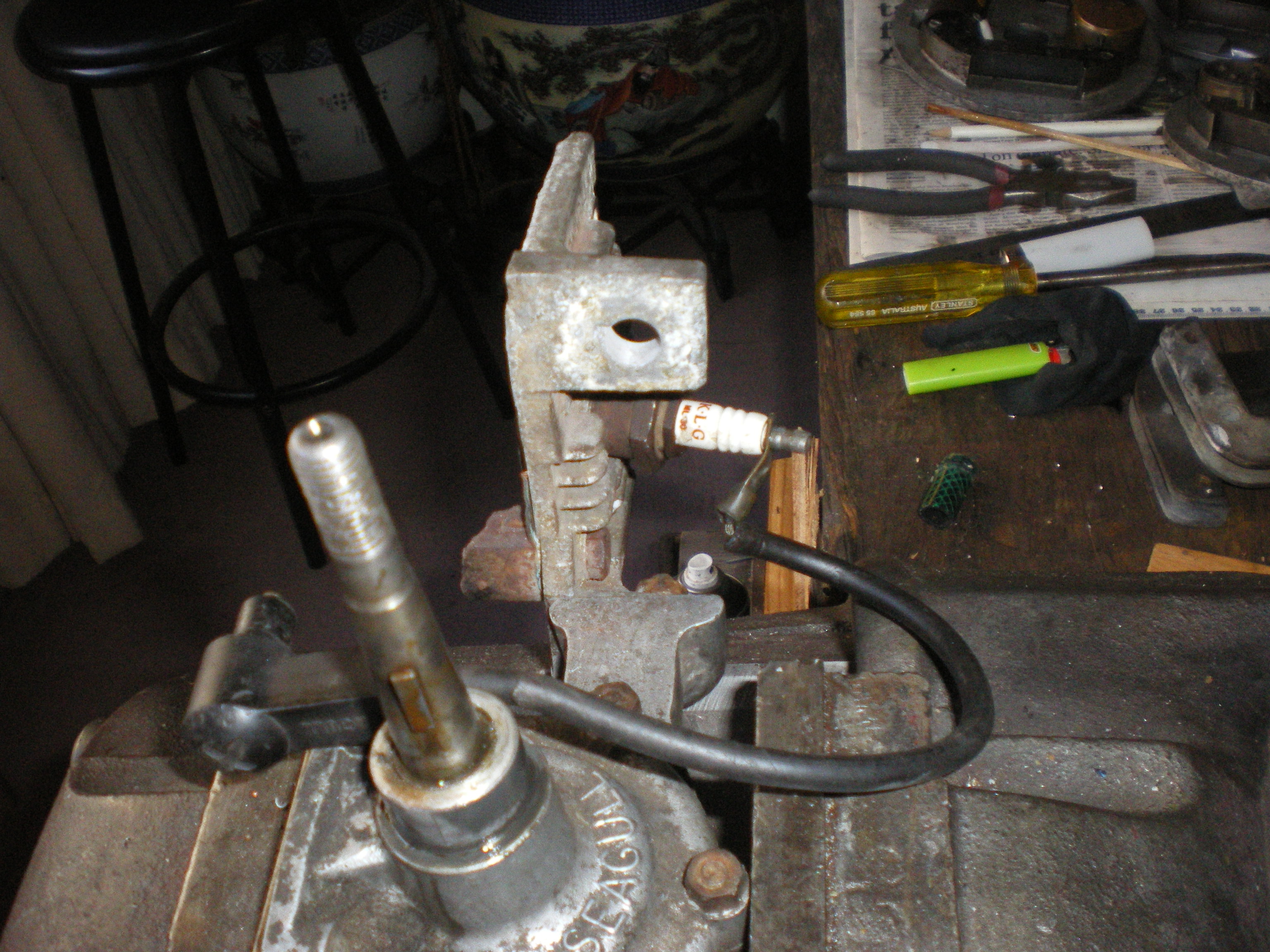

Here it has a value, I can make a test bed to run up Wipac 2 coils to see if the spark at the plug is constant, I have a flywheel base plate, the damaged flywheel, I just need a crank now !fleetingcontact wrote:And you were in the UK it would be a non-issue...you can't give the things away.
Re: Flywheel woes
I added a century head to my test rig by drilling out a the tank lug and bolting it to the tiller arm attach point. This way l know l have a good earth for the plug and don't have to muck around clamping or holding plug.

Now that is a good idea, I think it was yourself who told me he had made a test rig?Hugz wrote:I added a century head to my test rig by drilling out a the tank lug and bolting it to the tiller arm attach point. This way l know l have a good earth for the plug and don't have to muck around clamping or holding plug.
I have a cylinder head from an engine, one tank tang has been broken off, I now know what to do with the cylinder head, I just need a center shaft now.
