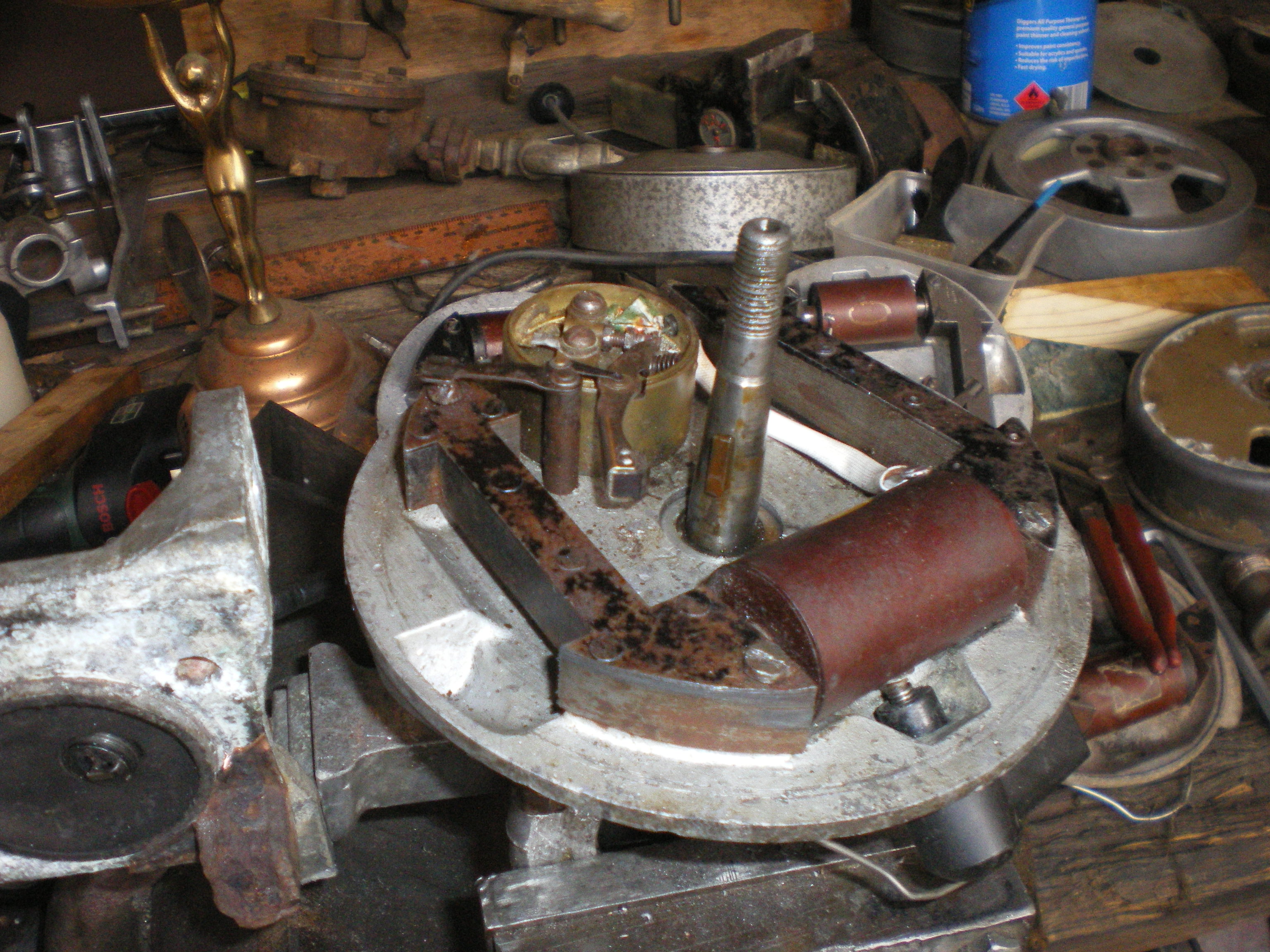

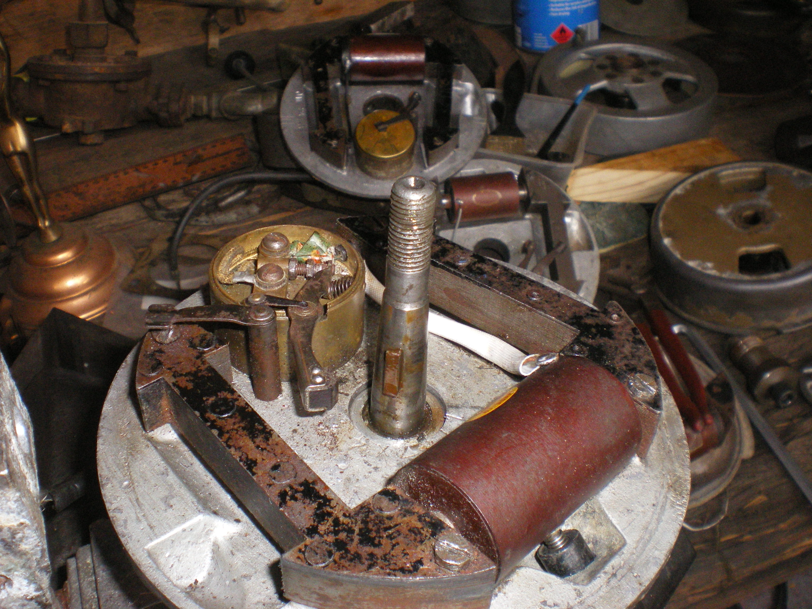

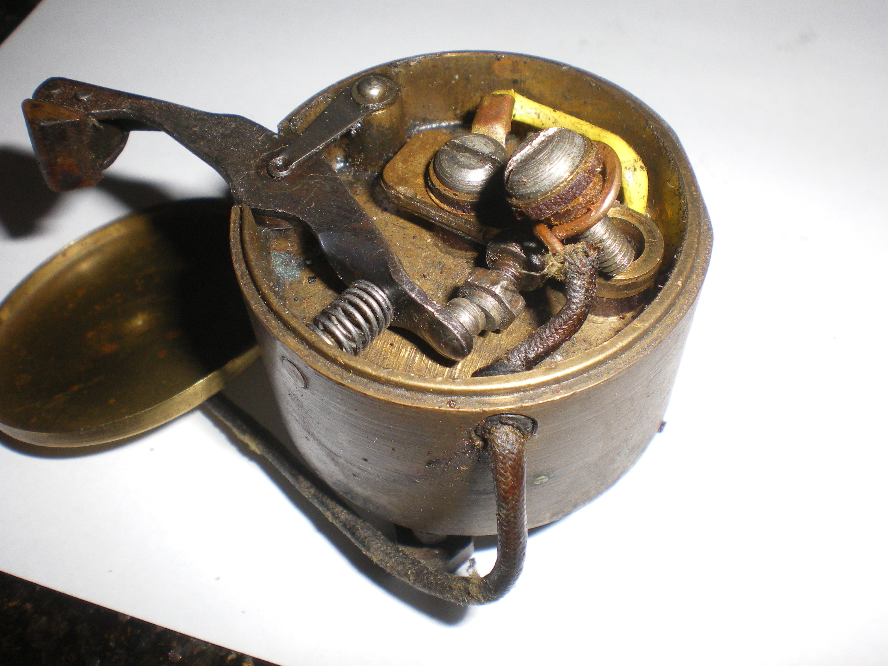

I adapted a Mk1 coil into a JM magneto with excellent results. Interestingly at first I couldn't get a spark yet when I hung onto the lead.... ouch. Pulled the points apart and cleaned and all good. I'm a little concerned how close the screw heads are to the brass lid. Worth insulating? I even had the plug set at 60 thou and the spark had no trouble jumping across. Probably need to have a photographic illustration where the fibrous insulated washers go on the stud points set up. Are the photos on this forum secure now? It is all a bit fiddly. I used a couple of old bolts ground down to make a 9/16" to 7/16" sleeve. Would be easier if I had 9/16" round rod and just cut to length and drill a 7/16" inner hole to take the more common 7/16" coil cores. I'll keep an eye out. Ok, 2 more to go and then I will have 6 JM magnetos working. I'm short one flywheel but that is ok as a base plate will be with me as a spare on a boat. Fleetingcontact you might recognise this plate. Love the way it is so easy to use a puller to remove flywheel on JM coolie hat magnetos. I do think Seagull went backwoods going to the MK1 on am I biased..... Not very happy belting flywheel nut to remove, hardly gentlemanly behavior.

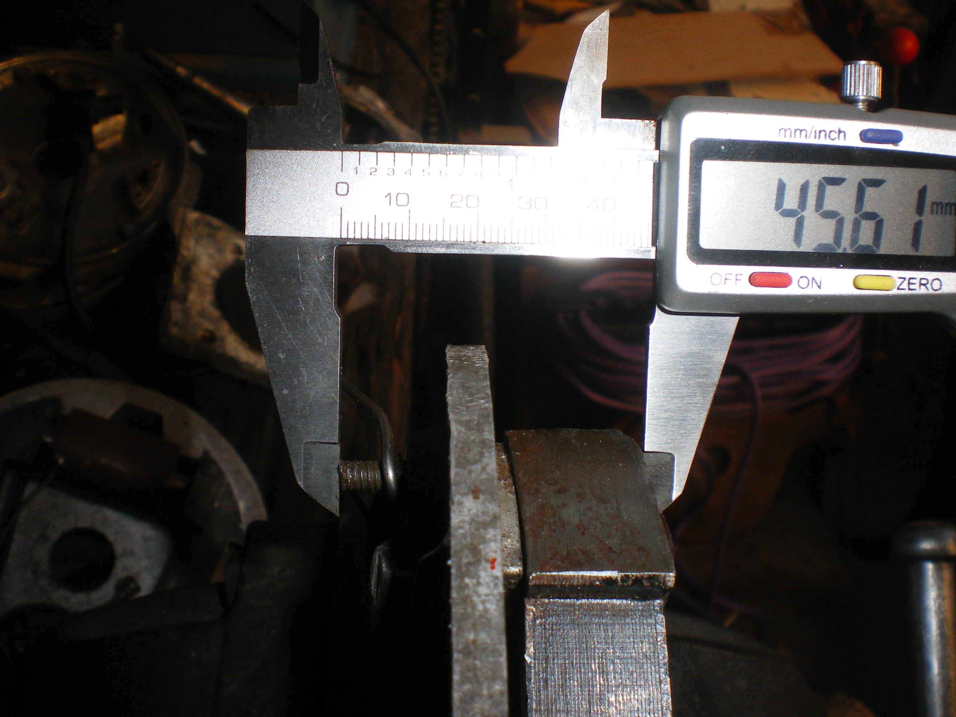

Has anyone a source for the 2BA long, round head slotted set screws that go through the JM coil support and hold the HT lead spring on the underside? About 1.3/4" long or 45.5mm. I need a couple of dozen and matching brass nuts. Thanks.

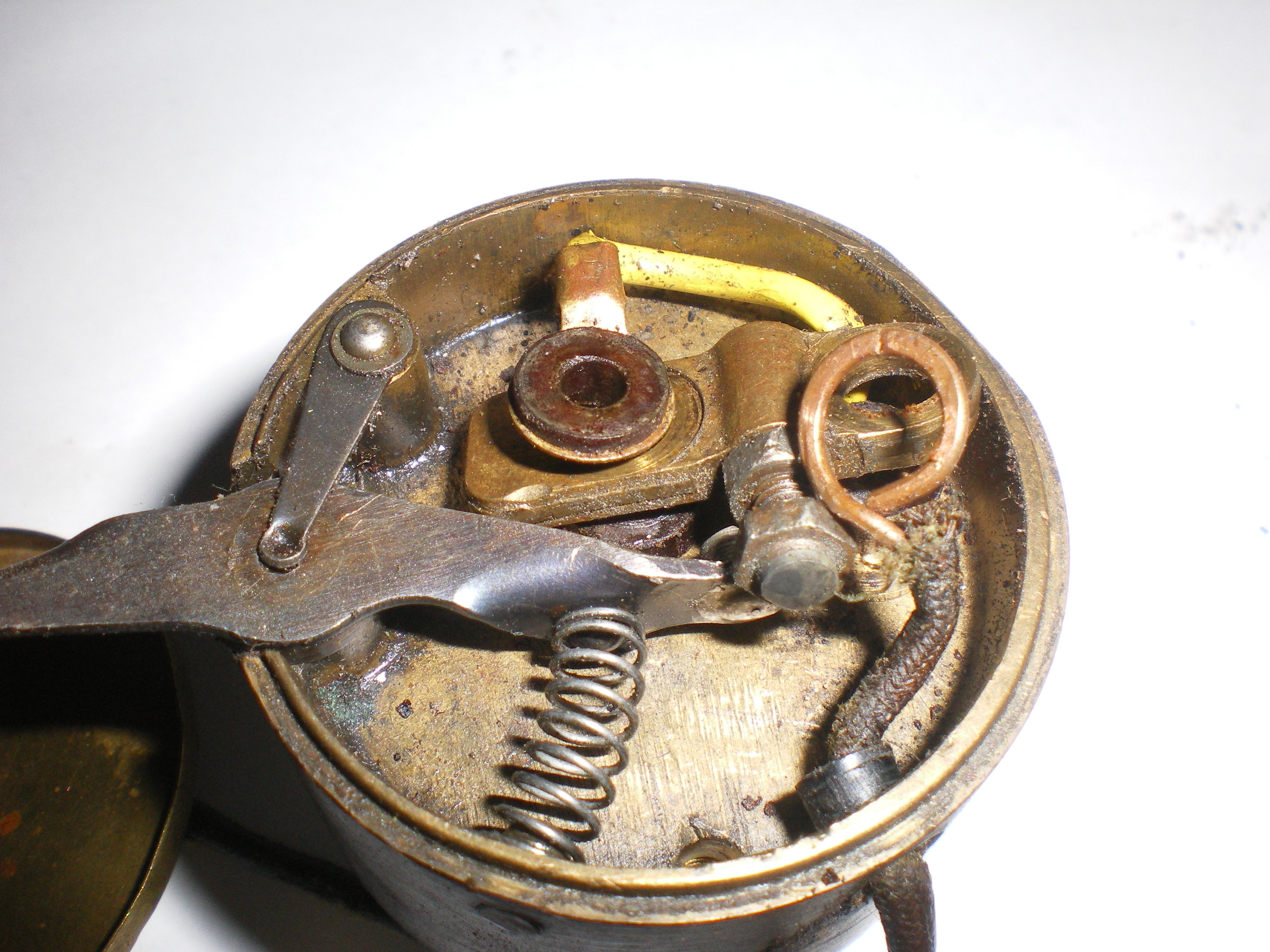

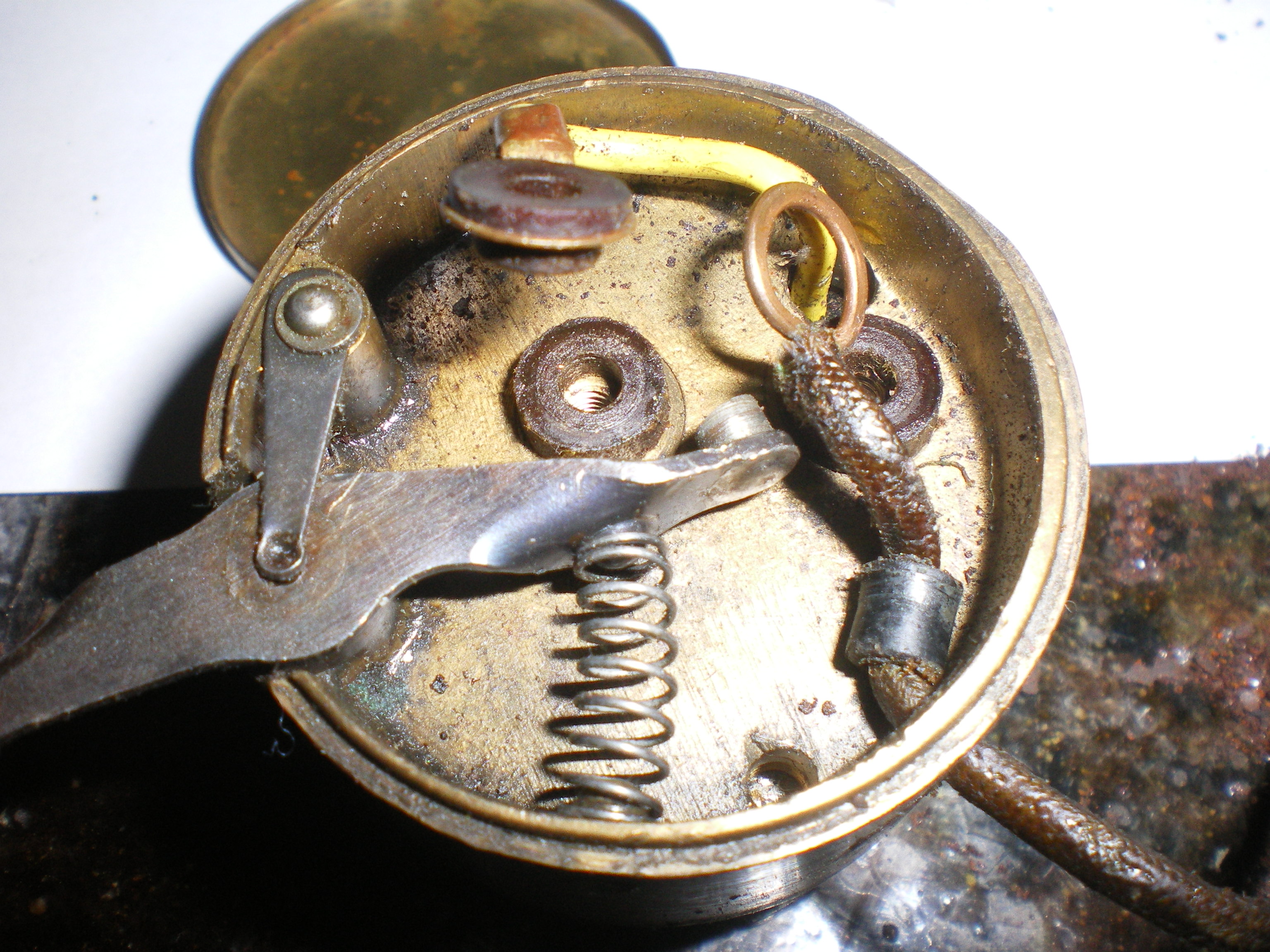

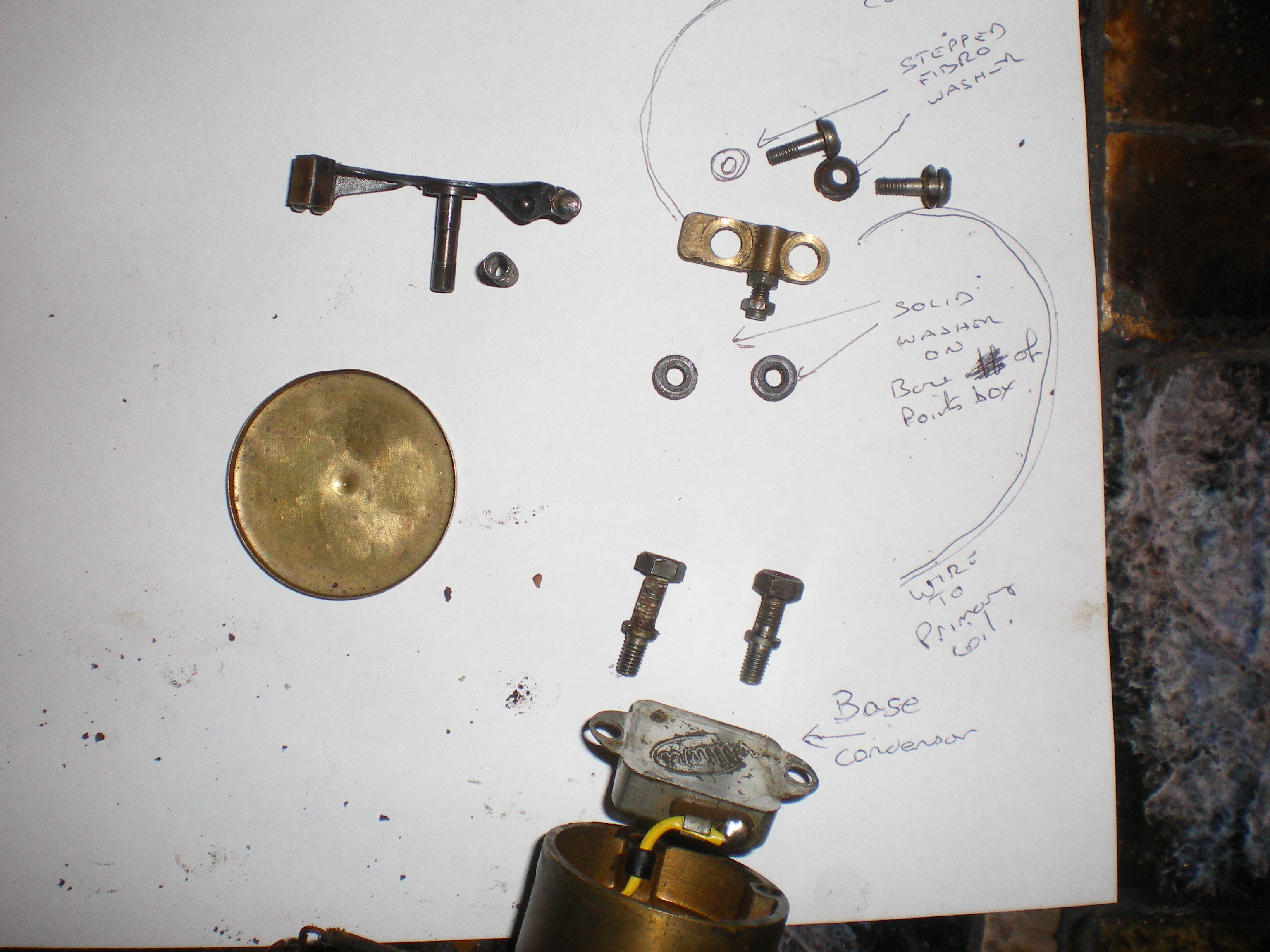

I thought I would table the sequence of the screws/insulator washers in the studs point boxes. There are four washers. Two that are solid that fit on the base of the points box and two that are stepped that the wires from the coil and condensor wrap around to insulate from the screws. There is also a rubber grommet on the side of the box where the wire from the coil comes through. There is potential for a breakdown of insulation at the side grommet position and the fibrous washers. So far these fibrous washers seem to to be standing up to their age well. Try not to over tighten securing screws. Previously I was concerned the screw heads were too close to the lid but they are of the same potential so no problem there. It is easy enough to dissemble and clean points. From the base up.... solid fibrous washer.... points bridge..... stepped fibrous washer with wire around inner step.... screw all the way through. Fun!

The usual, penetrating oil, heat (not near the coil though) and the mighty manual impact driver. On the mk1 use double nuts to bind onto stud to unscrew cheek studs. I did have one screw on the JM magneto that didn't wish to move. I had to grind down from the back of the plate (was only proud 1mm) and take down a little below the surface including the surface of the plate (which left enough threaded meat to reinstall). Enough of the corrosion was gone to enable removal of screw. The studs on the back of the round points block can be gripped with side cutters close to the back of the box (after the box has been removed). This part of the thread is not used as it is where it goes through the plate so any damage irrelevant. I think having a good size vice that has large enough jaws to take the magneto plate horizontally makes a huge difference. I also grind the impact driver bits to be a good fit into the slotted screws (mk1). I'm an Electrical fitter/mechanic by trade so feel quite at home playing with these. Good luck.

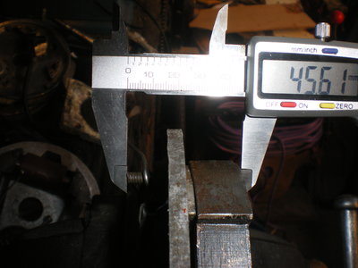

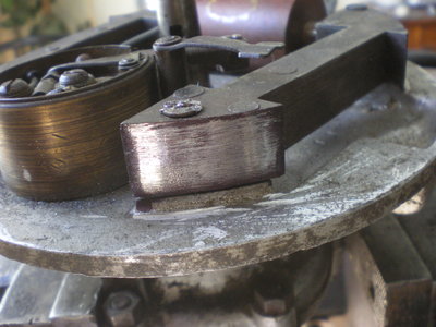

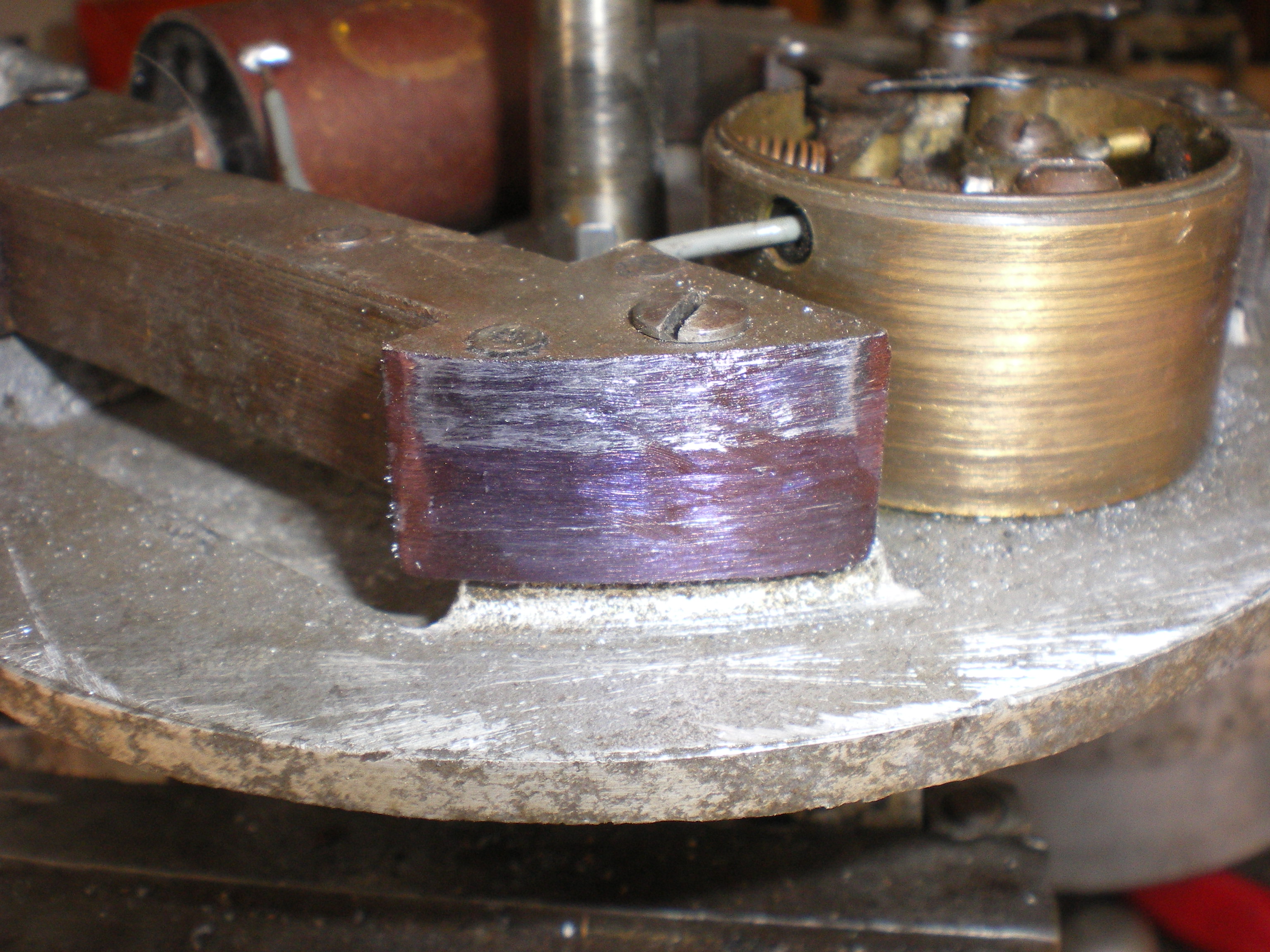

I've decided to dress the end of my horseshoe laminated coil mounts on the JM magneto plates. I wish to be in a situation where I can swap plates and flywheels around. The tolerance between the flywheel magnet and the coil mounts are very fine. Being made of thin laminated iron make them somewhat fragile and prone to distortion. Where the flywheel might rotate free before the replacement of coil, after maybe a different matter. Basically I inked the ends of the horseshoe (I used a texture pen) and rotated the flywheel to see where it was scraping. I then dressed with a file. Didn't need much. Mk1's have a good clearance so no concerns there.
Only top half need dressing. The whole face needs dressing.
