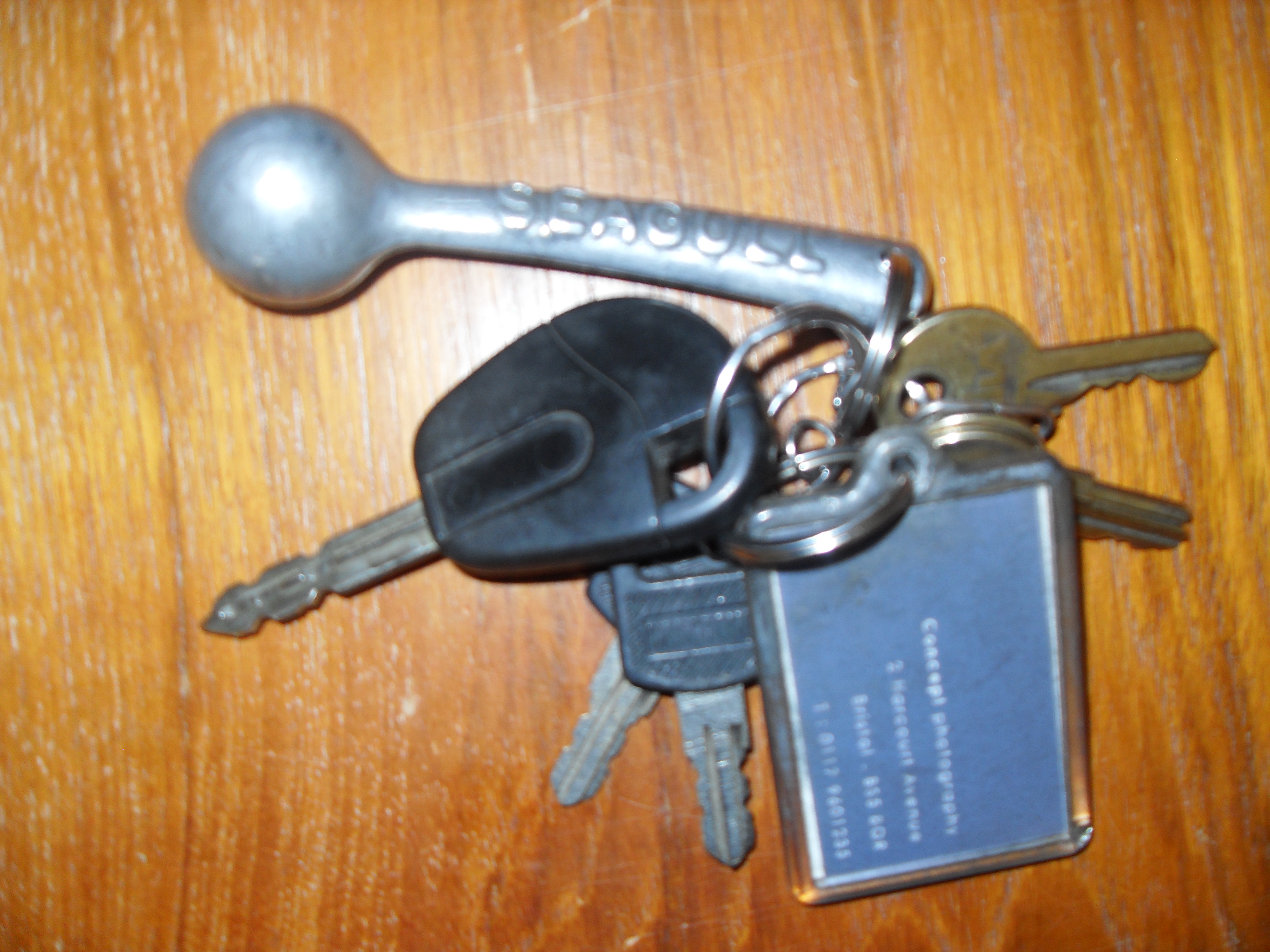

The gear lever was mounted in correctly through the large hole, I thought it looked wrong, I'm puzzled what the big hole is for ? Is this the correct 102 gear lever ?

Re the gear lever-- no it's the wrong lever fitted. The correct 102 clutch lever only has 1 hole for the stud to fit through. What you have there is a later century type lever (2 holes for mounting, the smaller hole is for the rod) but it will still work fine.

The lever

P.S. nice keyring.

Keyring?
As for a replacement lever,have a look for century clutch lever for now, unless you spot an nice "original".

Is this eBay item the correct 102 lever

No, that's the later type for later 102's and century's.
Bearing in mind that your motor has been factory re-furbished (hence the letter R in the serial number now) your motor probably would have been "updated" at some point.So this later type of clutch lever was put on because that's what was available at the time.
There have been a few discussions in the past as to what exactly was done or replaced/renewed during a "factory re-furb". Basically from what i can gather, the motor would have to be like new in order to pass muster. Anything that fell below a certain acceptable level or wear limit was replaced.
Going by a serial number alone is just the start of it. It's the reading between the lines that takes time.
If we took the original serial number to be AC445 (leave out the R for now) that would make your 102 a very early post war 102 with a build date between 1946/7. Many things will have been replaced on your motor by now compared to how it would have looked when new.
Depending on how accurate you want to be with your resto, either type of lever will fit quite happily.
Send me a pm and i'll be happy to discuss this further with you
The proper one is pictured below
