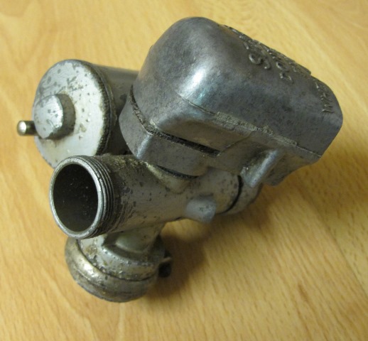

I guess that buying from the internet will always have a risky side to it?
I bought from the picture posted by the seller, the main item that my 102 series engine needed was the Amal 2 jet carburetor, what I got was not complete, so as far as this purchase is concerned I am still some way off finishing the engine re build?
Can you see what was not supplied?

The picture that I was able to select parts from is is this one.
Note that the Amal 2 jet carburetor still has the throttle slide cap in place, I would assume that the throttle slide and spring was inside the carburetor?
The air intake hood has been changed, as the black plastic choke that we see is not on the one I was supplied with.
I now need a throttle slide, spring and a screw on cap.
