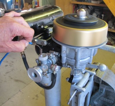

- Posts: 395
- Location: Hout Bay
Re: Stop end in a pistons gudgeon pin
Thanks, yes even with the Seagull Villiers carb fitted, the motor fired on the second pull and then started on the third pull of the pull cord and now starts a runs really wellNudge wrote:Just leave it be as it is. The motor will still work!
