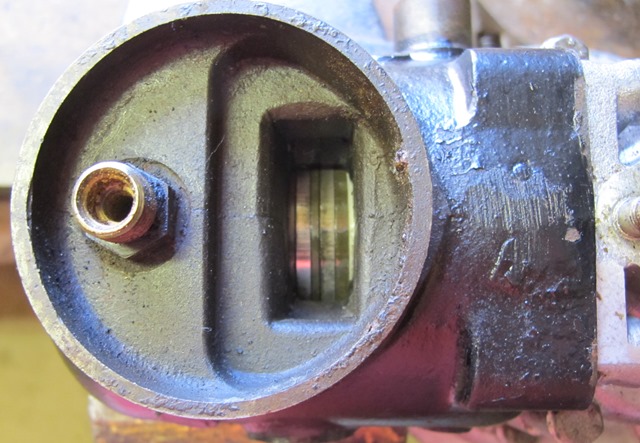

A 102 series power head that I was gifted was seized solid, I oiled it and left it on a shelf for a few years, I now find that with a suitable wrench that I can turn it over.
I becomes tighter as the piston comes to the top of its stroke, it also whistles !
With a spark plug fitted and lots of oil and 2 stroke inserted I can see via the exhaust port that there is blow bye on the compression stroke.
If I remove the piston, then free off the rings would that sort the tightness off and have the compression return.
The engine number is WHCH 144R8 this number does not show on the SOS web site on engine numbers, the R could possibly be a P, trying that has made no differnce, the number does not show up.
How do I unfreeze this motor, the piston moves but goes tight as the piston goes up and past the exhaust outlet.

Engine number is clearly WHCH 144R8
The power head is very clean, looks like its had an easy life, I wonder why it is part seized?

This 102 motor is still part seized, its quite free when the piston is down, then tightens up as the piston moves up and into the bore.
I have poured oil and 2 stroke into the crank case and also the upper piston area, the rings look clean.
Could the block be warped?
- Posts: 4951
Re: Seized 102 power head
Bent crankshaft, cracked bore.

Looking at the block I see two bolt heads, how do I access the other two please?
Remove flywheel and magneto base and you will find the other 2 nut.african imp wrote:
Pull the piston out and clean the bore, I would have done this first, so that I did not damage the bore more.
