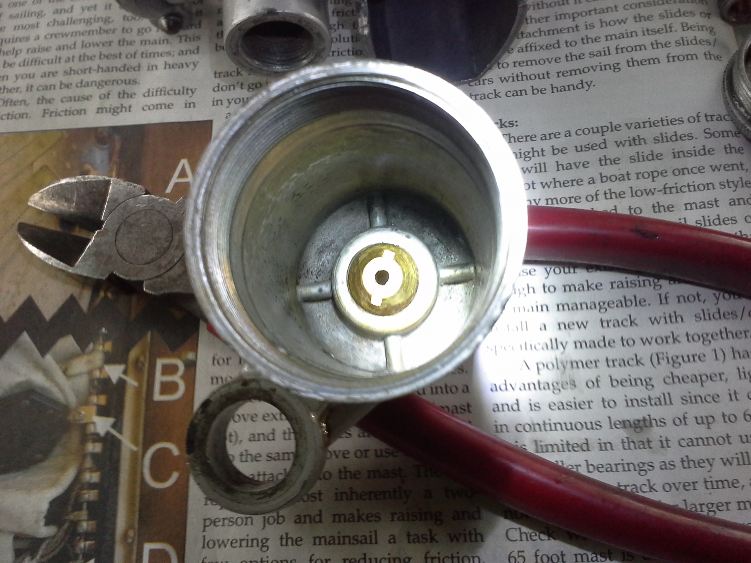

To reiterate...clearly it must be too much flow, pointing to the needle/float. That being said, with the long-range tank half full and the fuel tap on all the way, the carb isn't overflowing a bit (engine not running). Seems to me if the float/needle weren't shutting off the fuel it'd be dribbling out,correct? Only thing I can come up with is that perhaps vibration while running is preventing the flow from being shut-off/reduced, but that seems unlikely.
Have it apart again, here's a couple of pics. The darn thing shows no evidence of being cobbled-up or even rough use. As you can see, threads, etc look good. I apply a very small amount of "EZ Turn" fuel resistant lubricant to the threads as well. It's kind of an old-school slightly waxy grease that seals and protects threads, use it in aviation, especially the old stuff.
Going to reassemble without the float shim I made so it's again configured as designed.
Since I think everyone has graciously offered just about every possible solution, if it doesn't shape up this time I will just run it with the tap nearly shut until the spare carb from Martin arrives for further testing. Although this needle seems to be ok, reckon I'll order a new one to see if that makes a difference as suggested as well.

How many banjo bolt fibre washers can I see in your picture?
1 above & 1 below, float chamber banjo.
Carb looks perfect!
Can you measure the thickness of your fibre washer? (Seagull ones are normally red).
Carb looks perfect!

I see 2 BLACK washers, 1 above and 1 below at the banjo bolt. (they're not rubber are they?)
I concur that seagull ones are normally red in colour, but.....

It's the thickness that's important Jon, as the level in the float chamber is exactly the same on the jet, raise that level & the venturi effect from the passing airflow over the emulsion tube, portion of the power jet will suck more fuel or less if you lower it!
Even you, the resident carb expert will agree that carb looks to be in very nice condition!

There's two...in the picture one is still on the banjo bolt.
Both black washers on the banjo bolt are fibre, measure .034" and .036" thick and are of the proper id and od.
Additionally, there's a red fibre washer under the locknut on the bottom of the float chamber that measures .032" in thickness.
