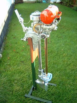

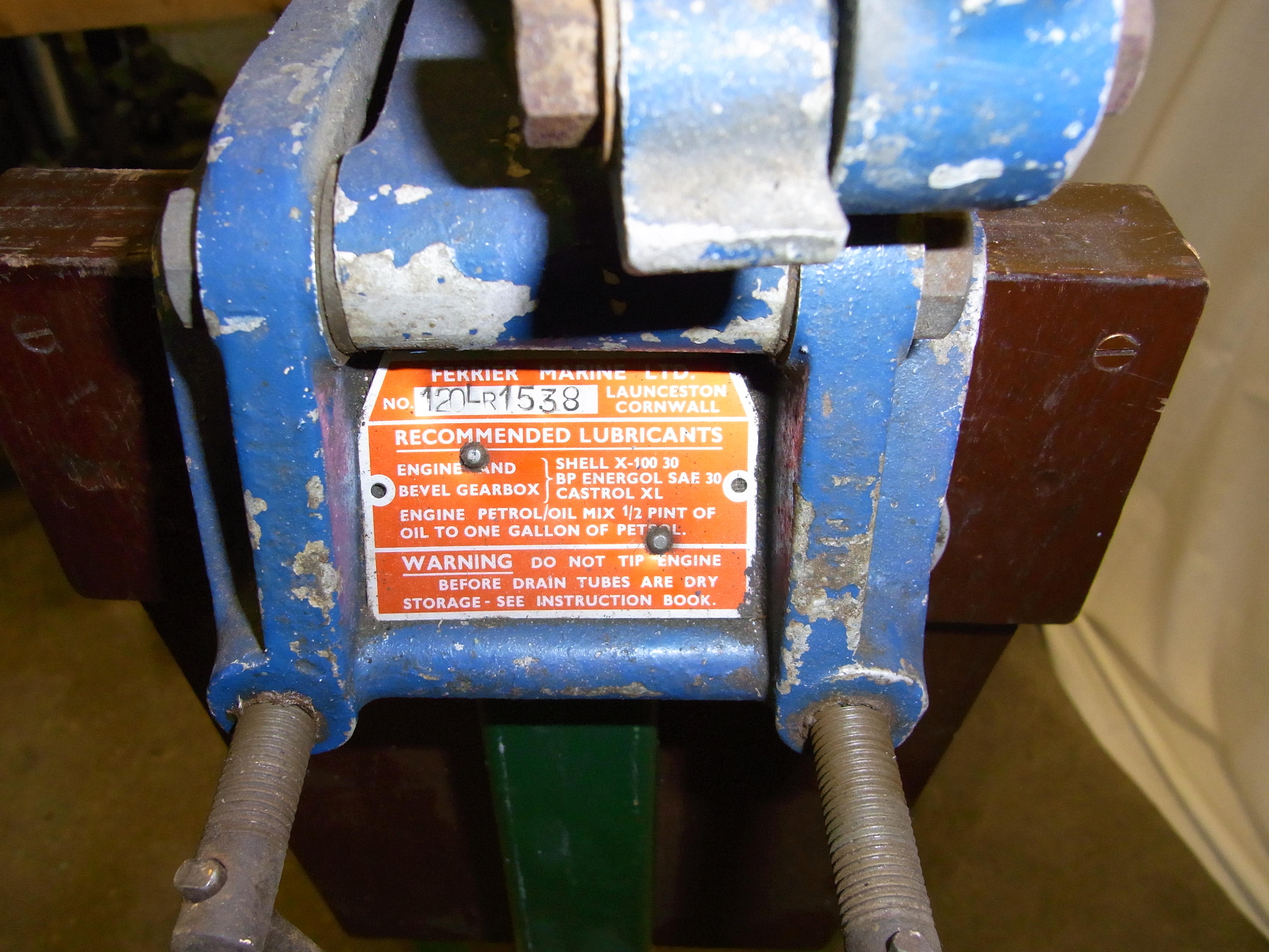

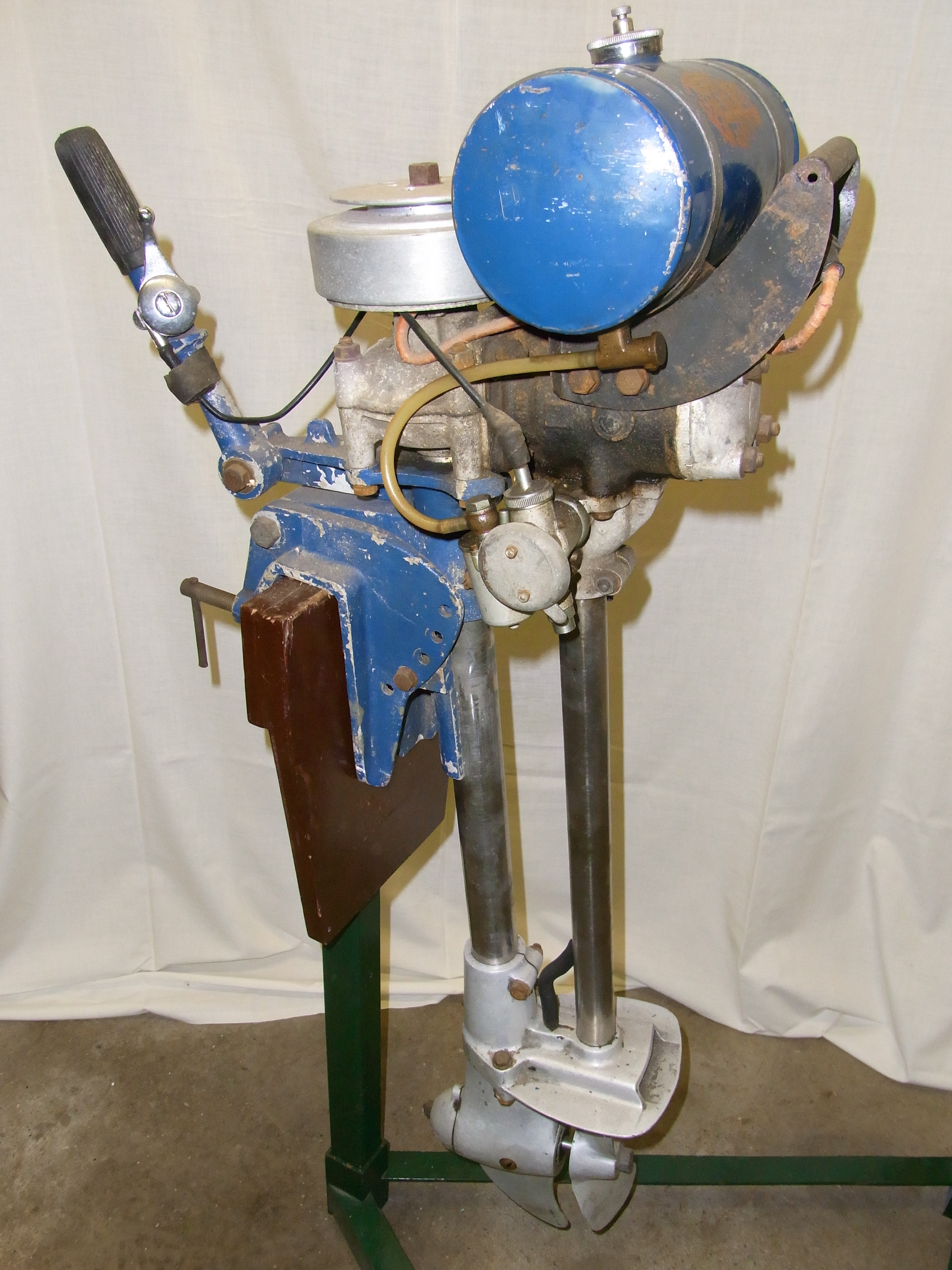

Firstly, the ‘blue’ motor in original condition was built in Cornwall as it has the label riveted to the transom bracket. Of the motors I’ve seen, only the Cornish motors have this label as the ‘red’ motor (not sure if colour is correct) has a slightly different bracket which will not allow a label to be fitted.

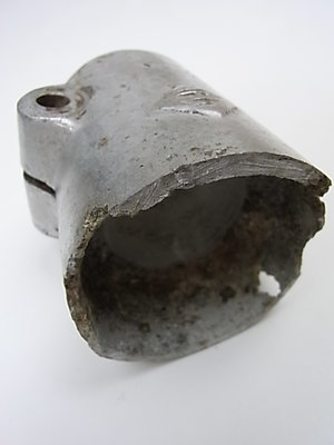

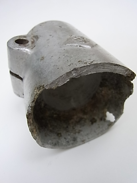

The obvious difference is the tank and bracket arrangement, whilst another difference is the foundry mark, the ‘blue’ motor has ‘BMC’ and the ‘red’ has ‘JHL’. Another observation which can only be seen if the motor is dismantled is to do with the waterpump casting. The drive tube is clamped in the split boss, which on the ‘blue’ motor is solid and the ‘red’ is chambered. On my example salt water had entered this chamber either via the crack at the end of pinch bolt slot or via a worn bush directly above the water impeller. Over time this chamber had filled up with salt deposits and gradually ate its’ way through the casting (as per photo).

As for which is the correct tank design (wrap around or juice can), all one needs to do is have a look at the cylinder castings. If the protrusions intended for tank brackets are drilled and tapped, then the correct tank is the juice can style. If they are not drilled and tapped, then it becomes clear the outboard was delivered with a wrap around tank.
What also comes from this is which tank design came first. I would suggest that the presence of casting protrusions, indicates the wrap around style tank is the more recent. Of course, I can verify this.
