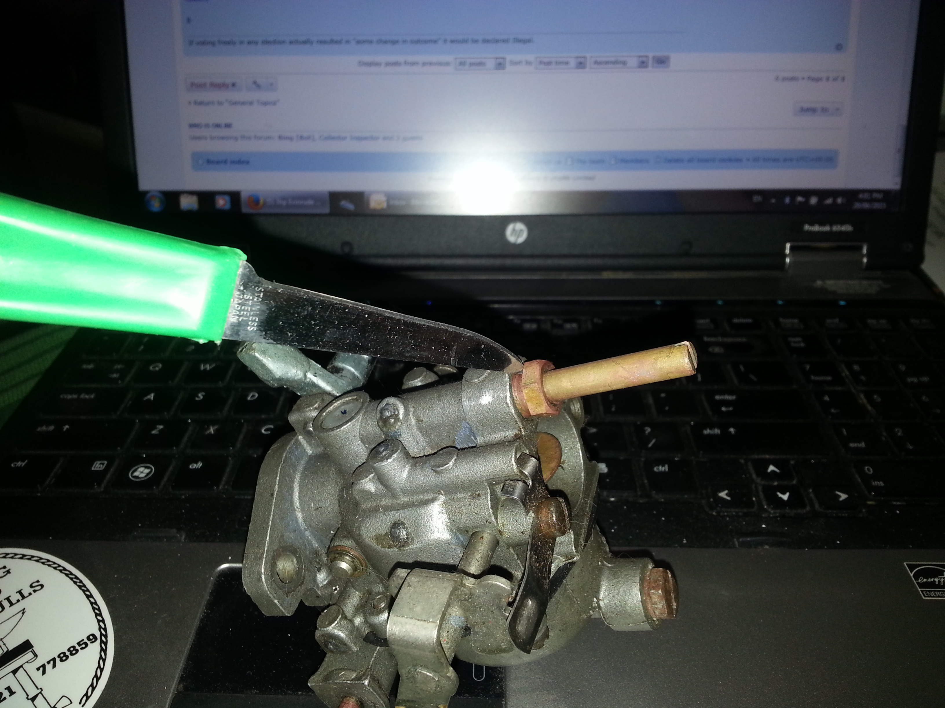

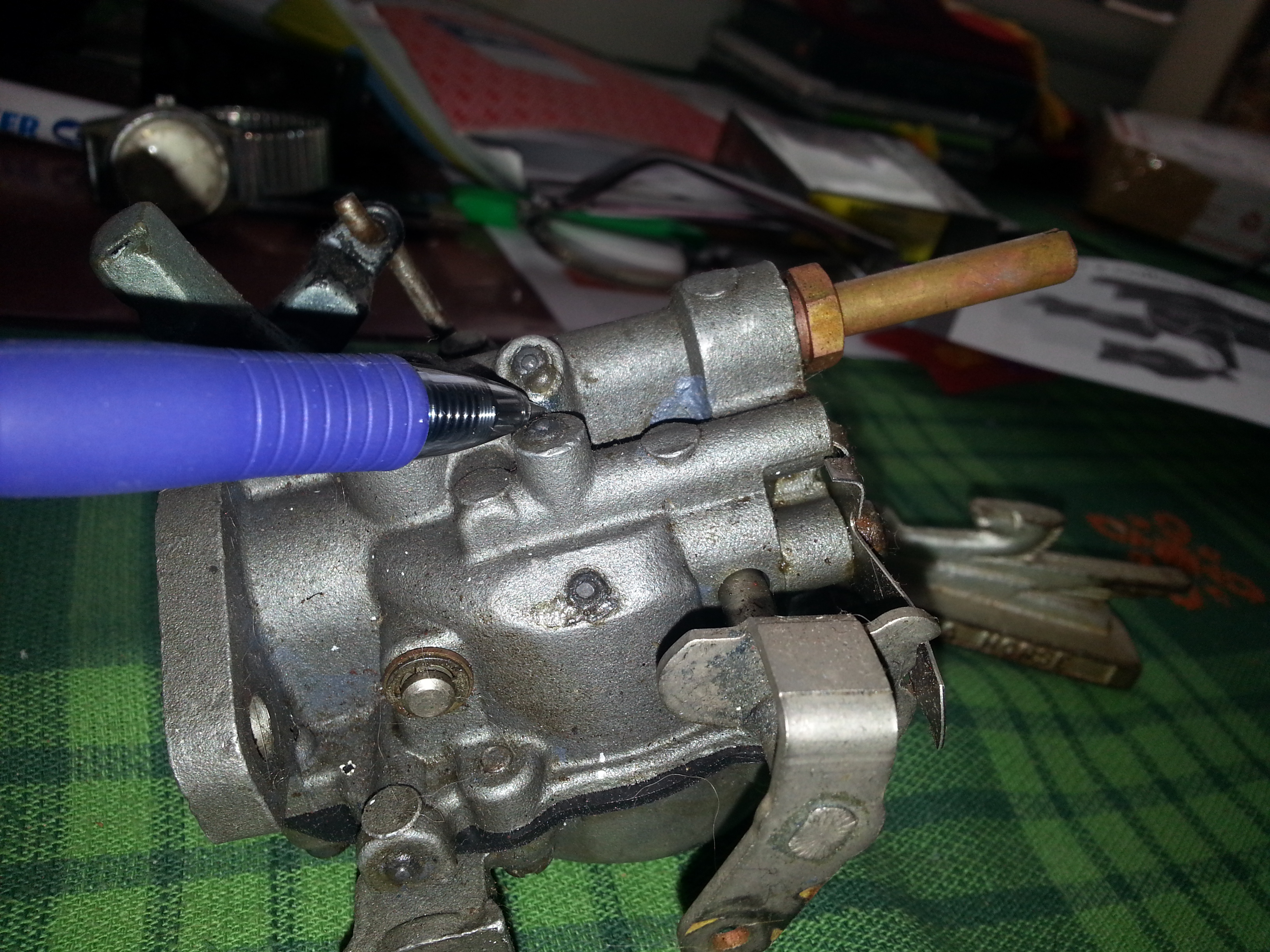

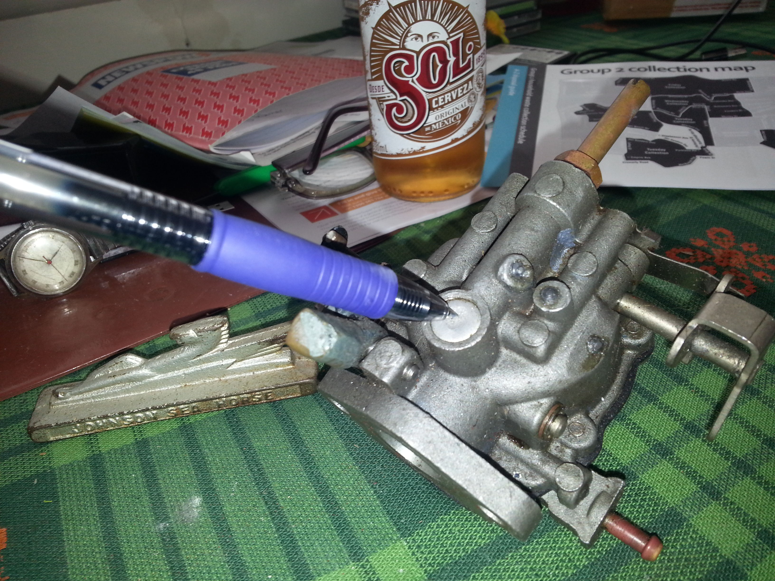

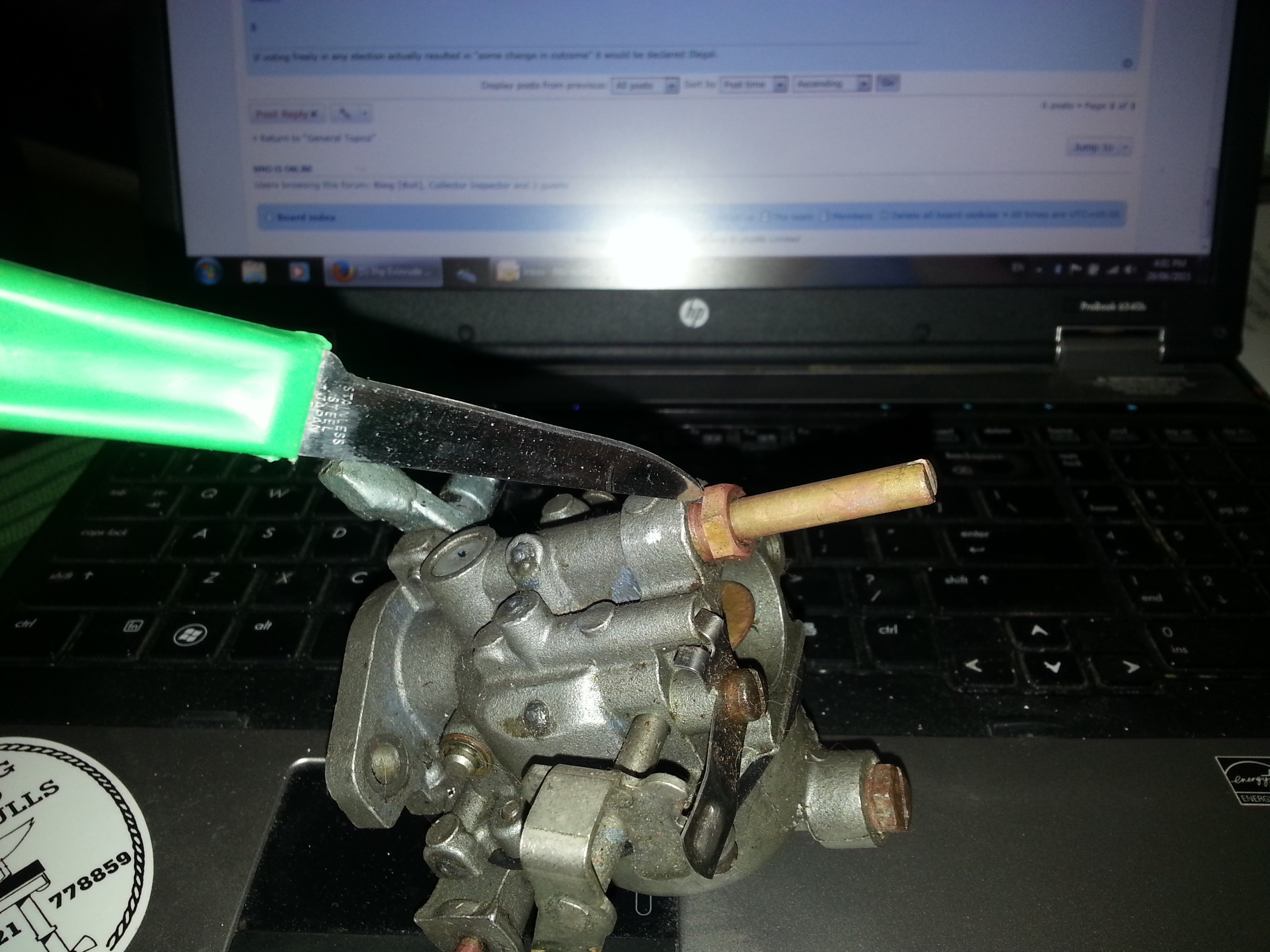

Waited for someone to mention the gallery plugs.....did not happen so;
There should be 4 lead shot plugs as well as the small fuel rail plate .
See pic showing 3 shot. 1/8"
Any of them not sealed...................will be as you described as a problem.
Too much air pressure over 6psi will blow the shot out when cleaning. You will not have noticed if this is the case aye.
This is a 6Hp carb but you get the general idea.
B[/color]
B[/color]
