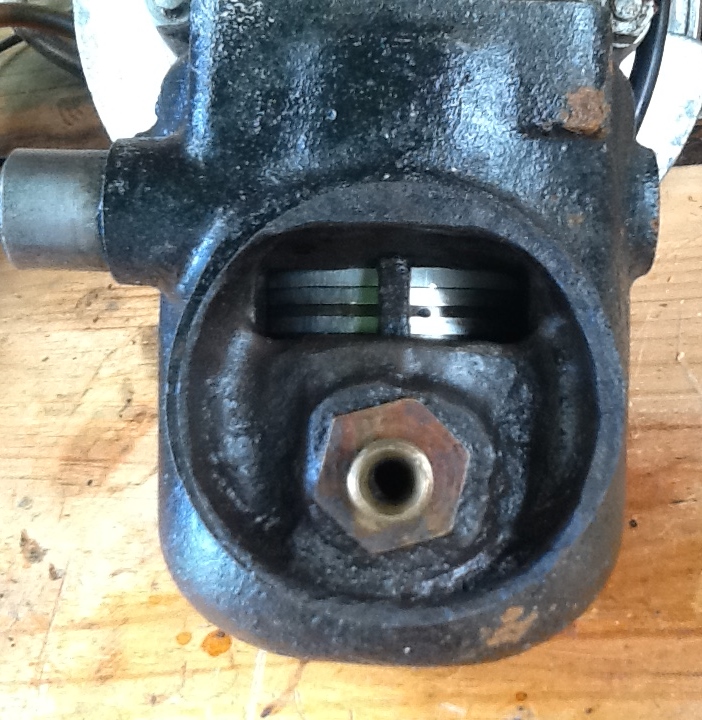

p.s does AD860 have the hex head core plugs in the cylinder? (good if it does as this will be the correct cylinder for it)

AC860 before assembly and side view
