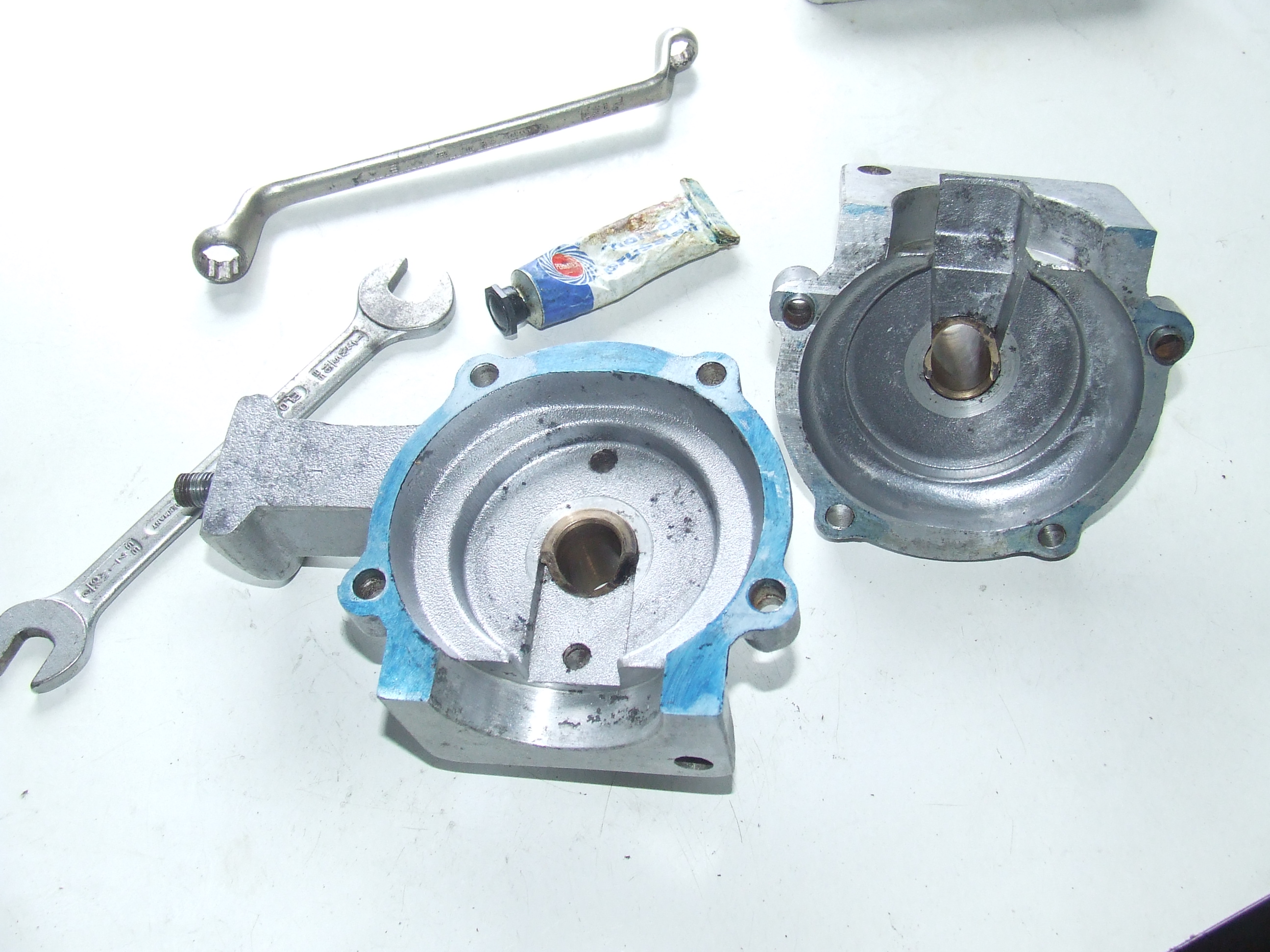

The 40 plus I bought this year had a badly damaged case, the previous owner had slathered fillers over the outside and used it like that. I scraped and chiselled the fillers off to see what the problem was.
The engine still started and ran even with such a big gap that the escaping air was enough to dimple the skin on my finger. But it was down on power!
Fitted a good crankcase and it now runs well. If you split the crankcase and use some engineers blue it will tell you how the fit is and you can adjust the fit with scraping.
Dave.

I will check the crankcase fit when it's apart. I don't have any engineers blue so I'll have a go with a sooty flame to blacken the surface. Not tried it before but it's how seals on shotguns are checked so should work fine and will save me from buying the blue.

Post by Mantulaman » Tue Jul 23, 2019 8:19 pm
