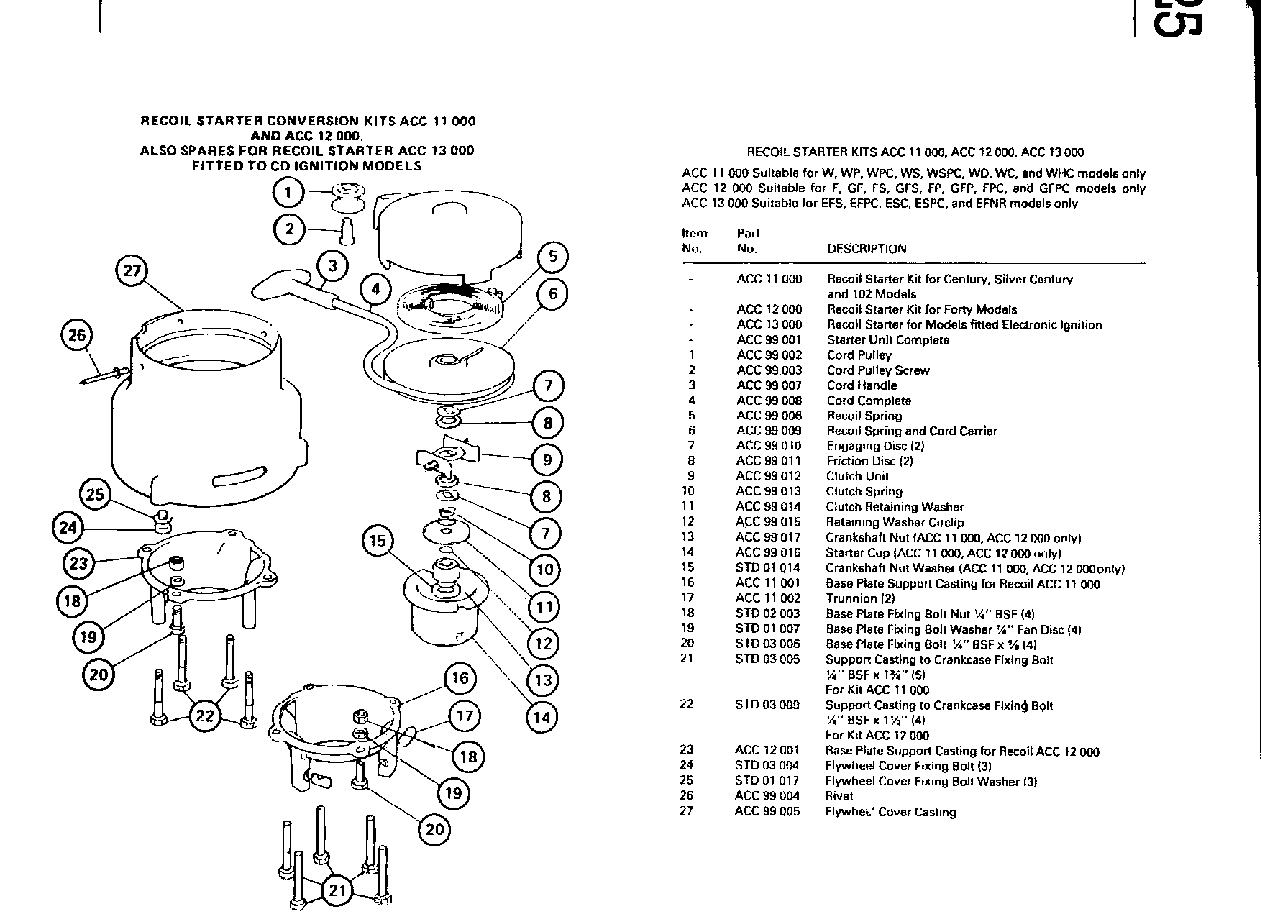

If not, sometimes there is a part left off when these are put back together. Suggest taking a look at a parts diagram for the recoil starter and make sure everything is there. I think the “inner ring” you reference is the “starter cup” which I have seen left off a couple times, particularly when a recoil is retrofitted to another engine.
If so, it might be time to dis- and reassemble the recoil unit. Seagull service sheet #25 has both the parts diagram as well as instructions for replacing the cord which gives a few tips on what to look for. I’ve rewound the spring a few times by hand, not fun but can be done with patience (and needle nose vice grips to hold it wound up while installing!).

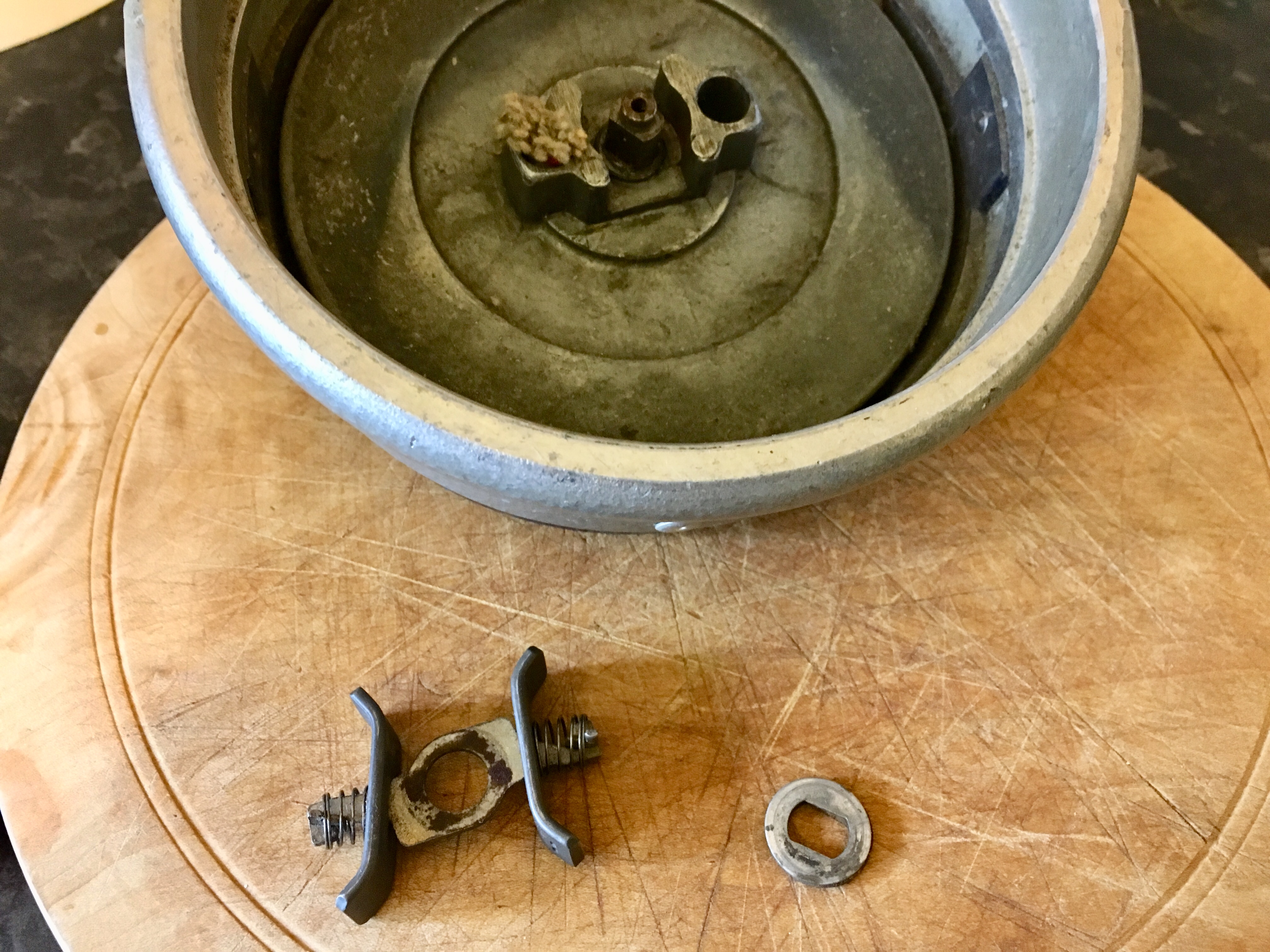

I know I have a retaining screw or clip missing from the top... ( I do have a photo)
I have the big blue Seagull Manuel but I just can’t don’t it!!! I need to see an exploded image of the starter.

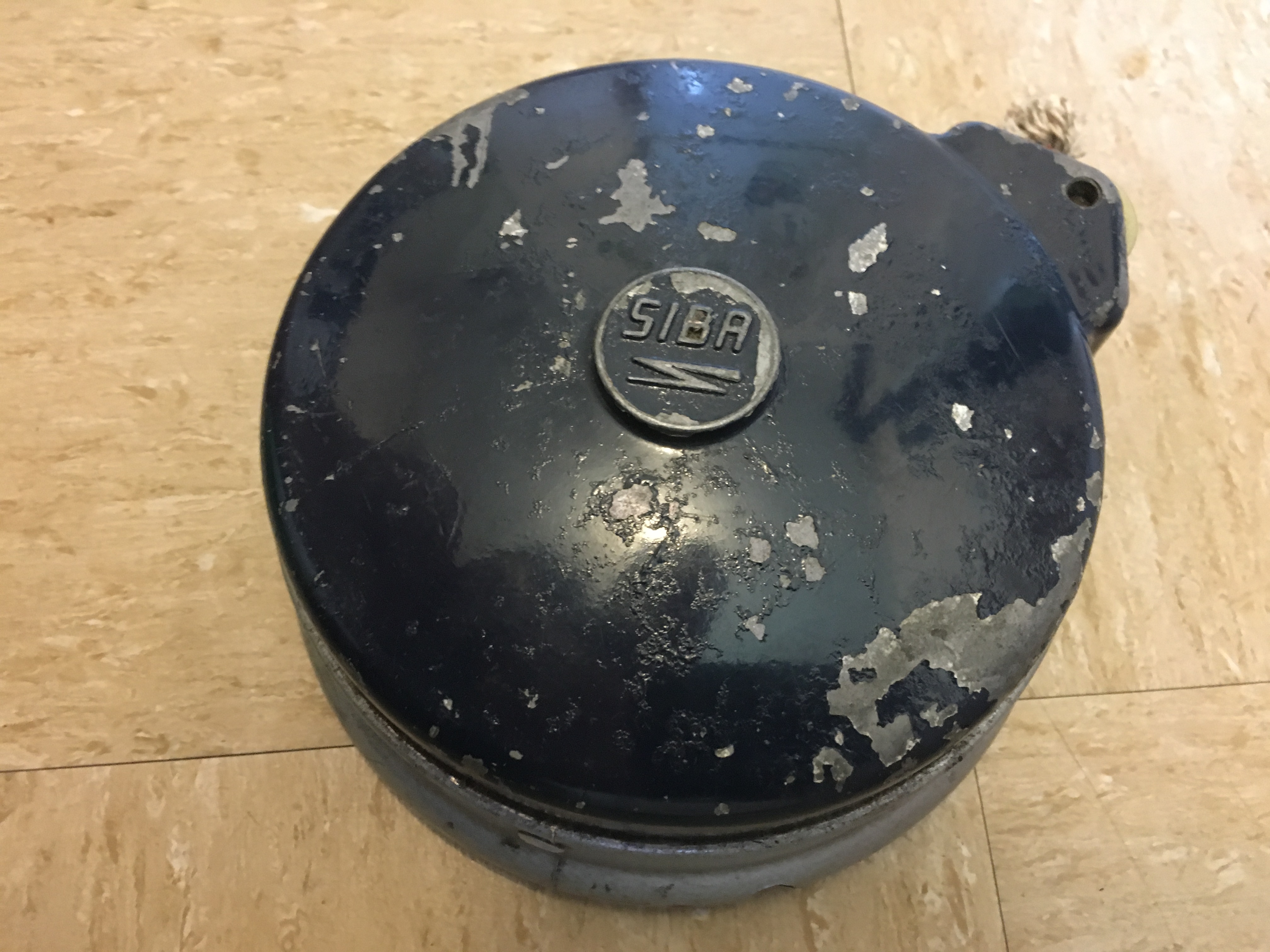

I have been looking the forum and I can see there could be different types... my one is a Siba... I have photos...but as yet don’t know how to post them?

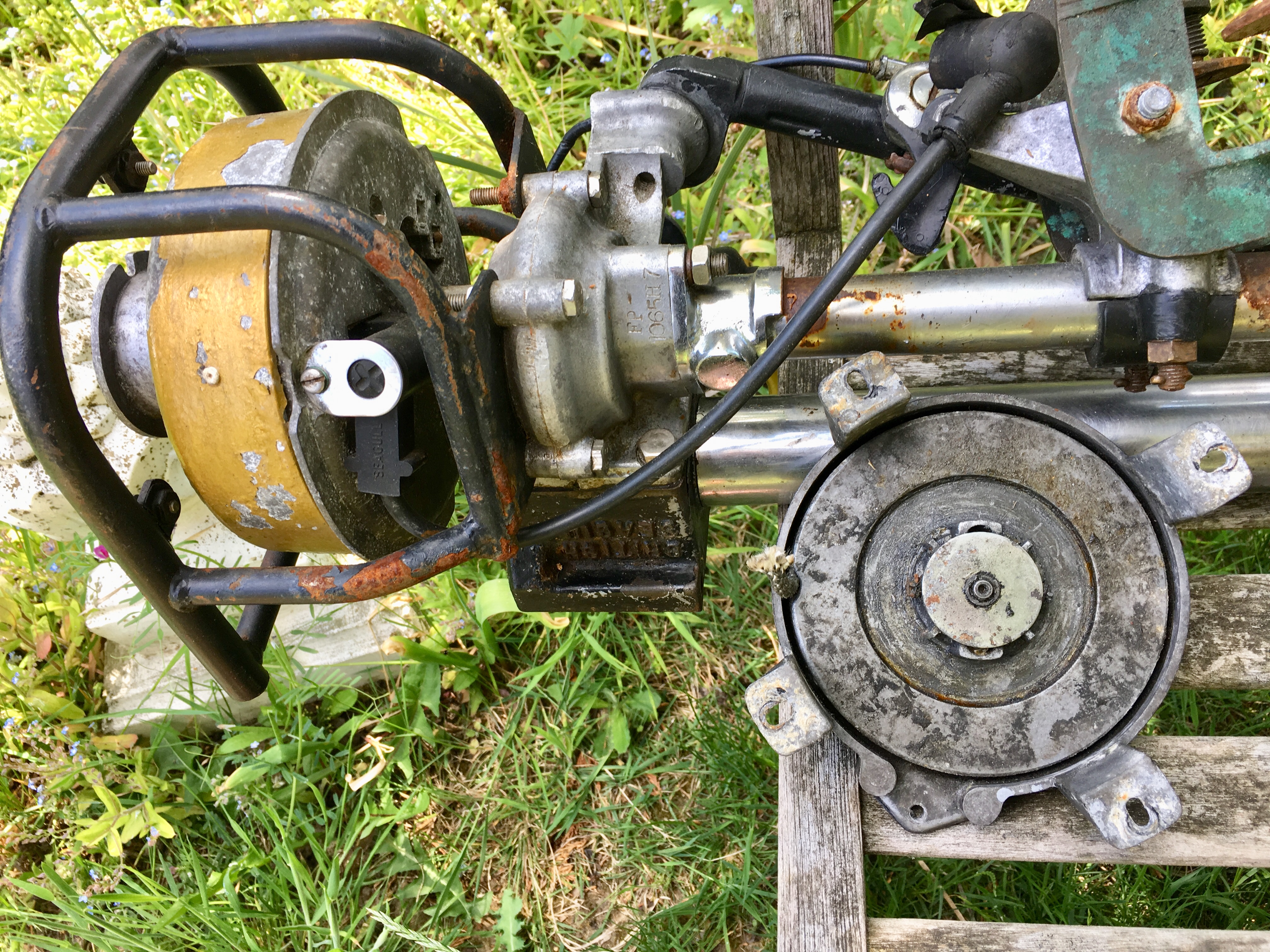

Ok that’s great, although I have just taken the starter of my old 40 plus ( 1967) that I was thinking of trying to get going again... ( took in some sea water six months ago and locked up... long story It wasn’t me!)
The workings look the same as my 90 as in washers etc?
I might be able to use the same parts?

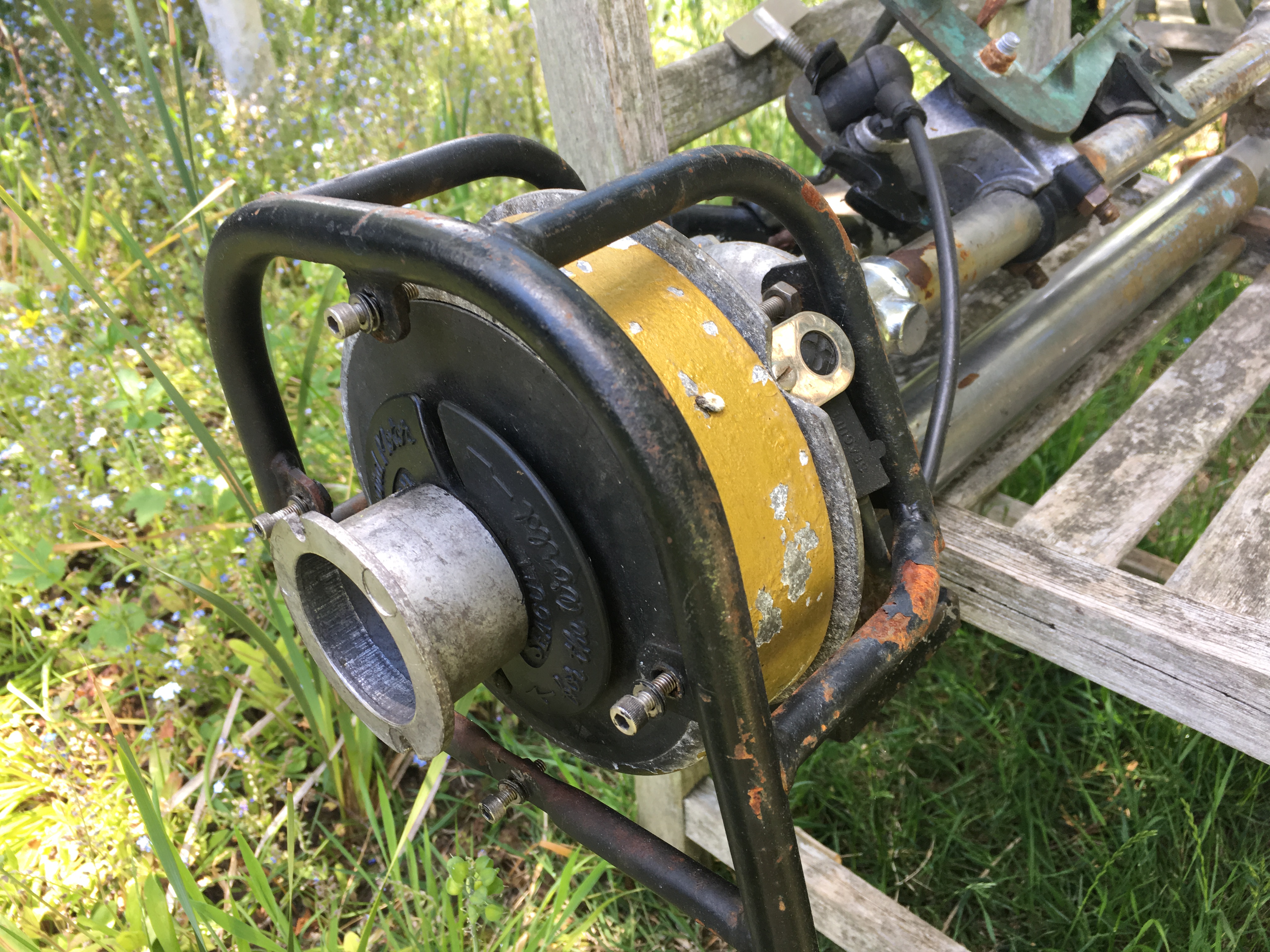

The 40 plus.
