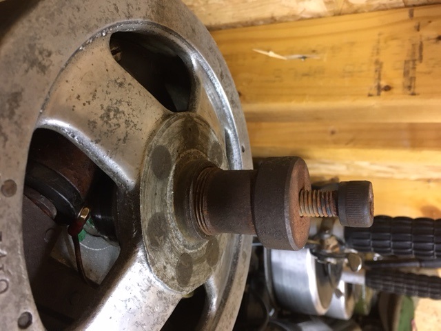

All wonderful informational posts. But, I like pictures to go with the text. Can anyone show me how the "coolie hat flywheel remover" actually works? Is there any tool other than a hammer which can help remove Mark 1 Villiers flywheel? And if so, can you show me how it works? I am reluctant to use the "hold and whack" flywheel removal technique with the brass nut for fear of ruining it.

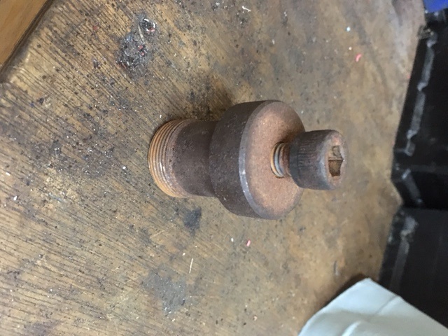

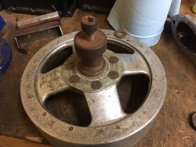

That probably would work but i woundnt recommend it. Do it this way on villiers MK1 and wipac mk2:
https://www.youtube.com/watch?v=ahfY2POTOfQ
Also here is how a coolie flywheel puller works for those who don't know.
Remove the flywheel nut, rope pulley and coolie cover. Next you thread in the flywheel puller all the way so it has more grip and wont damage the thread in the flywheel (this is a left hand thread). After that you use a long allen key or allen bit on a ratchet and turn clockwise till it tightens, you will feel a tight spot then 1/4 turn later the flywheel will pop loose.
Don't forget the grease the flywheel nut on the reassembly process as you don't want it to seize on the future!

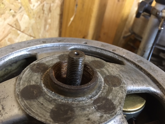

The key thing to remember is that the cranks have a precision ground taper, so avoid dressing it with emery paper, because if you do there is a good chance you will introduce high and low spots, and then the flywheel will never fit well.
Clean and remove any burrs and that’s it.
