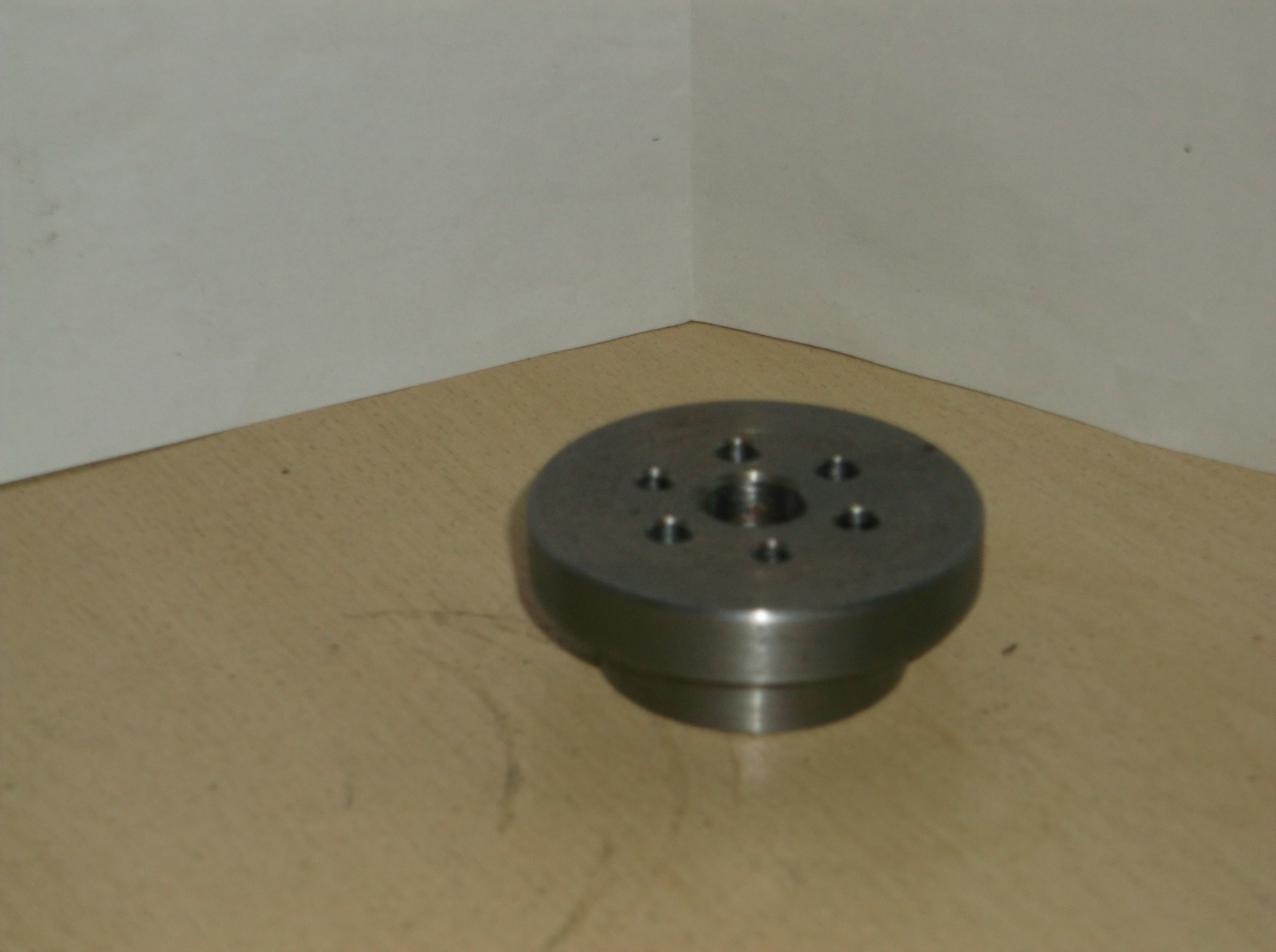

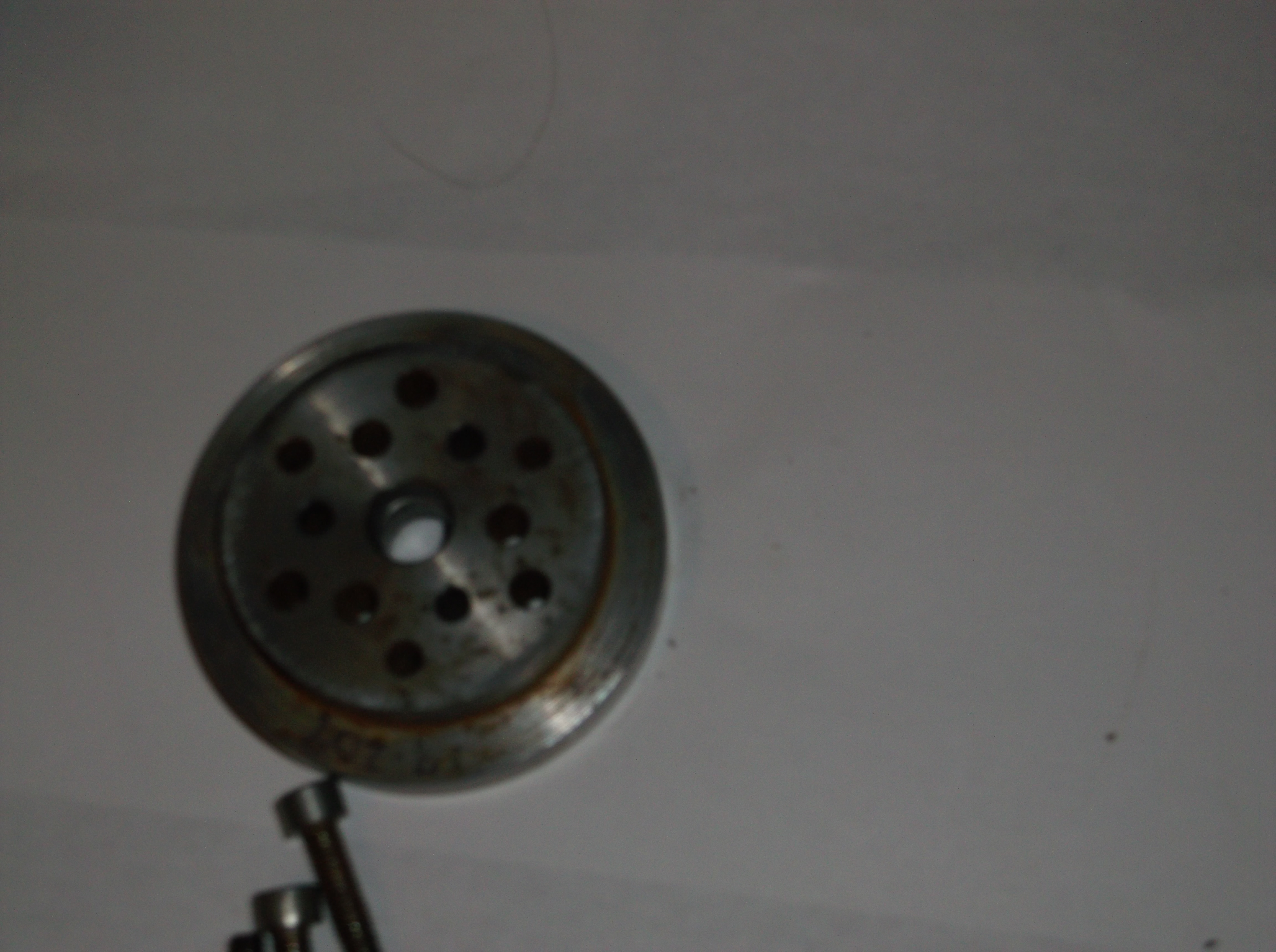

Drilling the flywheel steel hub is the only way you can do it.
Let me try & explain how it's done. Sorry about the poor pictures.
In the top of any Wipac CDI flywheel the top of the steel hub, can be seen it has a shallow hole drilled into it, this hole is the tapping drill size for a 2BA thread, tap this hole 2BA right to the bottom, & drop the drill guide over the crankshaft & fasten down to the flywheel with a 2BA cap head using the middle hole of the 3 2BA clearance holes that are in line, the drill guide is now located by the crankshaft & the hold down screw, if you could see on my poor pic you would see that there are 2 tapping drill sized holes 120 degrees away from the hold down screw, with a cordless drill & a 4mm drill, drill 2 holes 16mm deep, remove guide & tap 2BA, replace guide holding down with one of the 2 threads you've just tapped so the first hole can be drilled to 4mm x 16mm, then tap 2BA all the way down.
The drill guide can then be fastened down using 3 2BA steel cap heads & the flywheel removed with 3 legged puller tool hooked over the brim of the inverted tophat guide!
This was designed so that a stuck CDI flywheel could be removed without damage & reused with only a cordless drill, 4mm drill, 2BA tap, a few 2BA capheads & a three legged puller tool, as CDI replacement flywheels don't grow on trees in Bermuda & New Zealand!
I see no reason why a much bigger diameter top hat guide couldn't be used on a Villiers Mk1, but the holes would have to be in line/same diameter as the hold down counter sunk flywheel screws & about 1/4" thread, it's only a matter of finding a small engineering workshop to make you the top hat drill guide, which could be held in position for drilling with a short length of tube & the flywheel nut, make sure the centre hole is exactly 7/16". So 3 holes at 5.2mm alternating with 3 at 1/4" for a 1/4 U.N.C. thread hold down. Tell them 1 5/8" PCD, 6 holes.

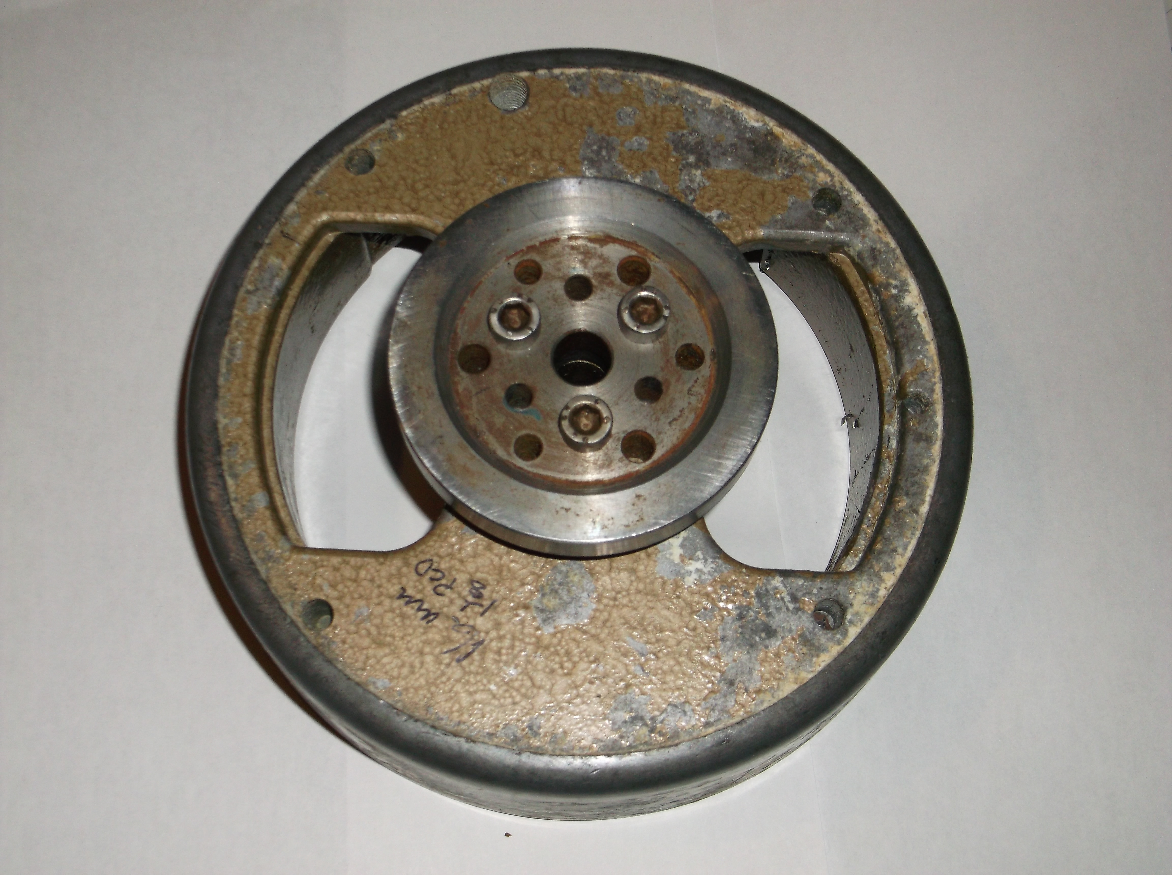

Re: stuck flywheel
Somewhere I've got a big one, the Villiers/Wipac version, that I had to make after I broke a big window Wipac when the other Charles & I were doing our overview research, I think I kept the broken flywheel.
I'll post pics if I can find it.
- Posts: 4955
Re: stuck flywheel
I've found it!
It was attached to a damaged Wipac big window upside down in the garage, you could only see an upturned flywheel. Narrow diameter ring of holes for Wipac, outer ring for Villiers flat top. Now you can see why they're called "big window".
