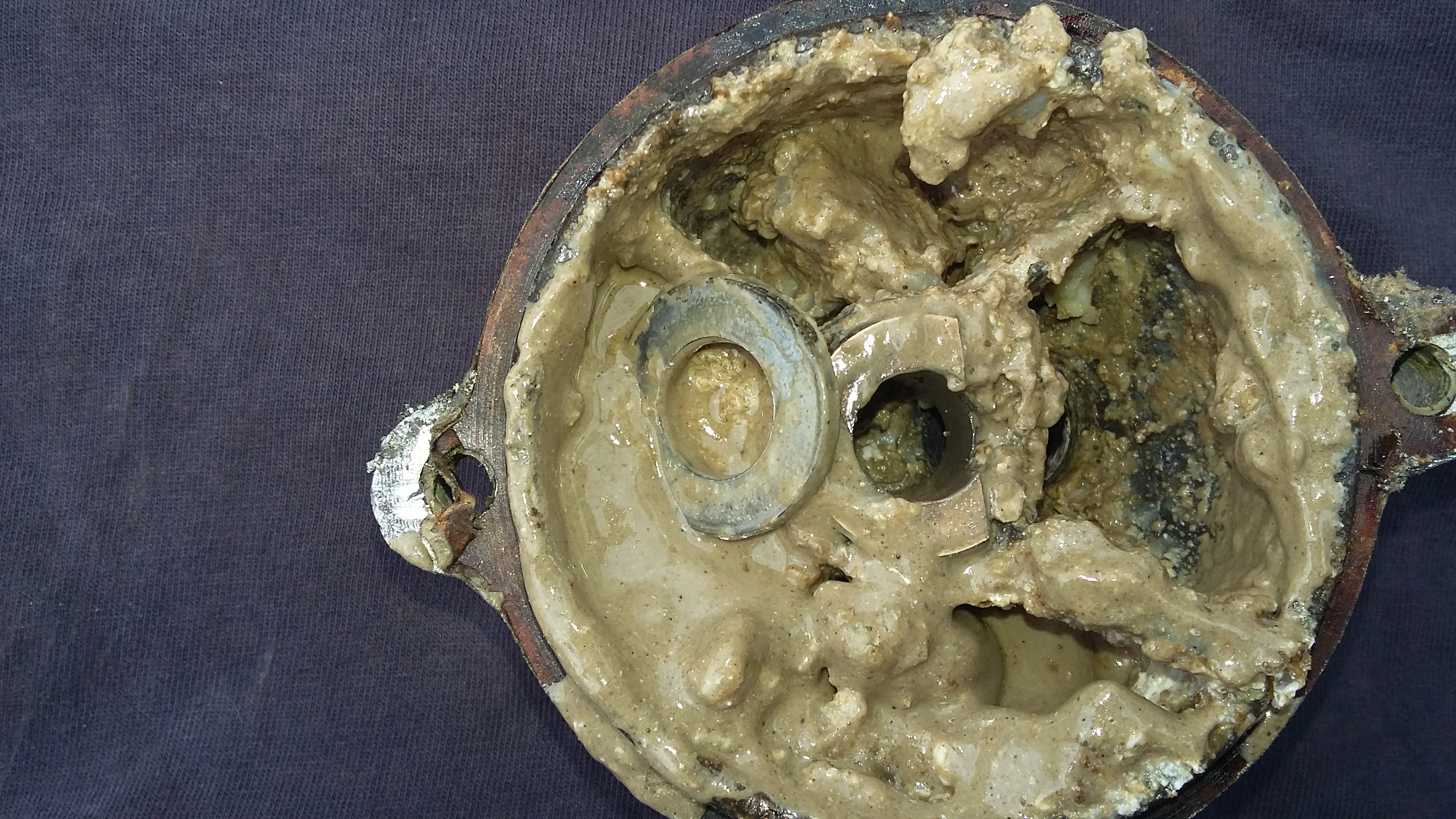

Is this right?

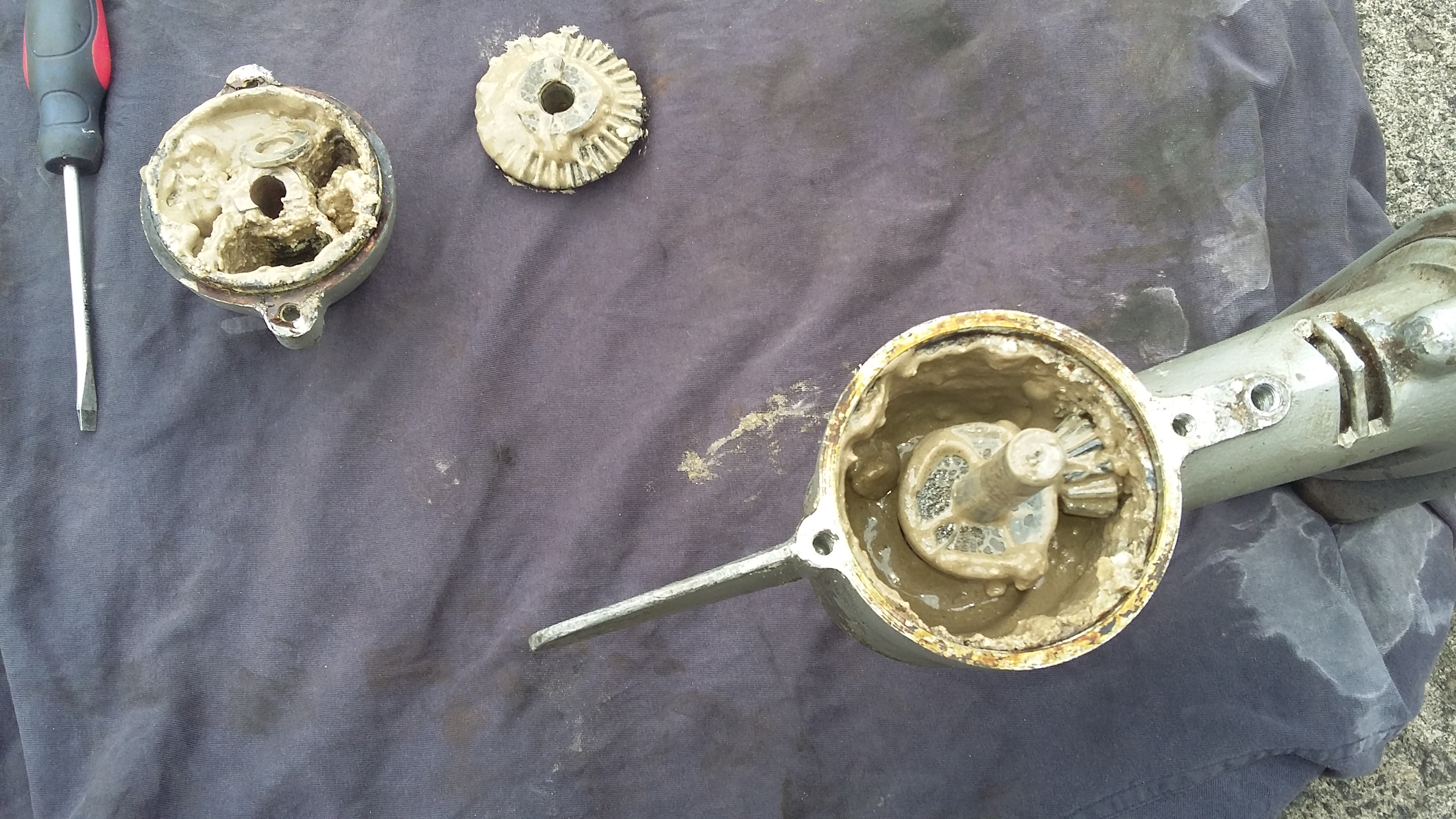

We bought this engine yesterday, running. Moving prop and flywheel by hand did not feel like anything untoward, no play or clunckyness. Checked Gearbox oil, which didn't look good, so opened up the box. Looks like a mixture of emulsified oil and grease. Big white lumps, but no gear teeth I think :roll:
I'll clean and fill with proprietary oil.
Re: OMG. First look into FPC gearbox ...
The big white lumps could be grease or salt crystals, which are more common if it's been used in salt water.

Clean with old 2-stroke fuel then post a picture!
I would scrape the excess away and leave soaking overnight in paraffin or similar. As you say refill with correct oil after cleaning and you are good to go. Maintain often and it will last for years 8)

Thanks for the reassuring replies. I've cleaned the gunk out, and will properly degrease before putting it all back together.

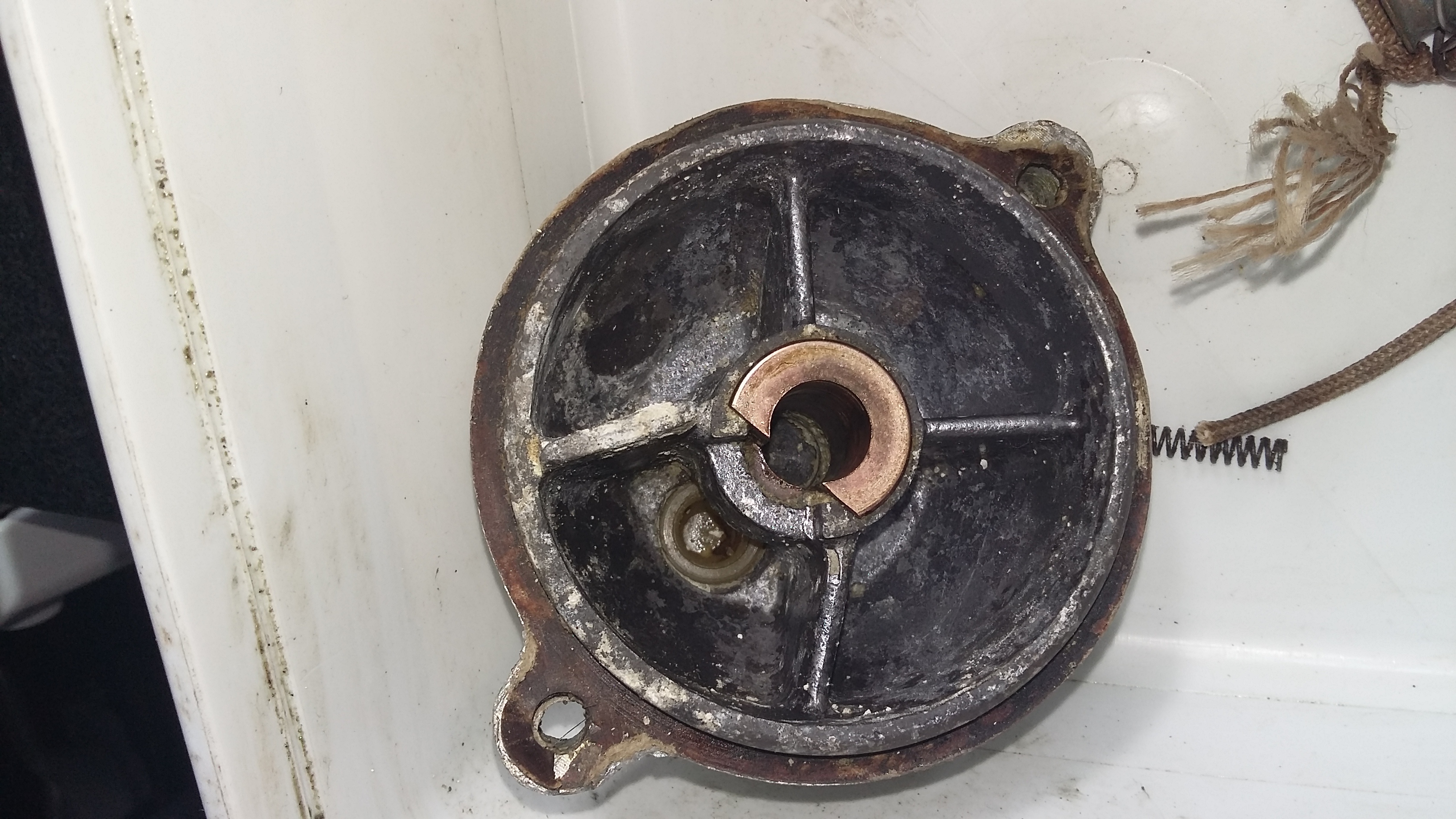

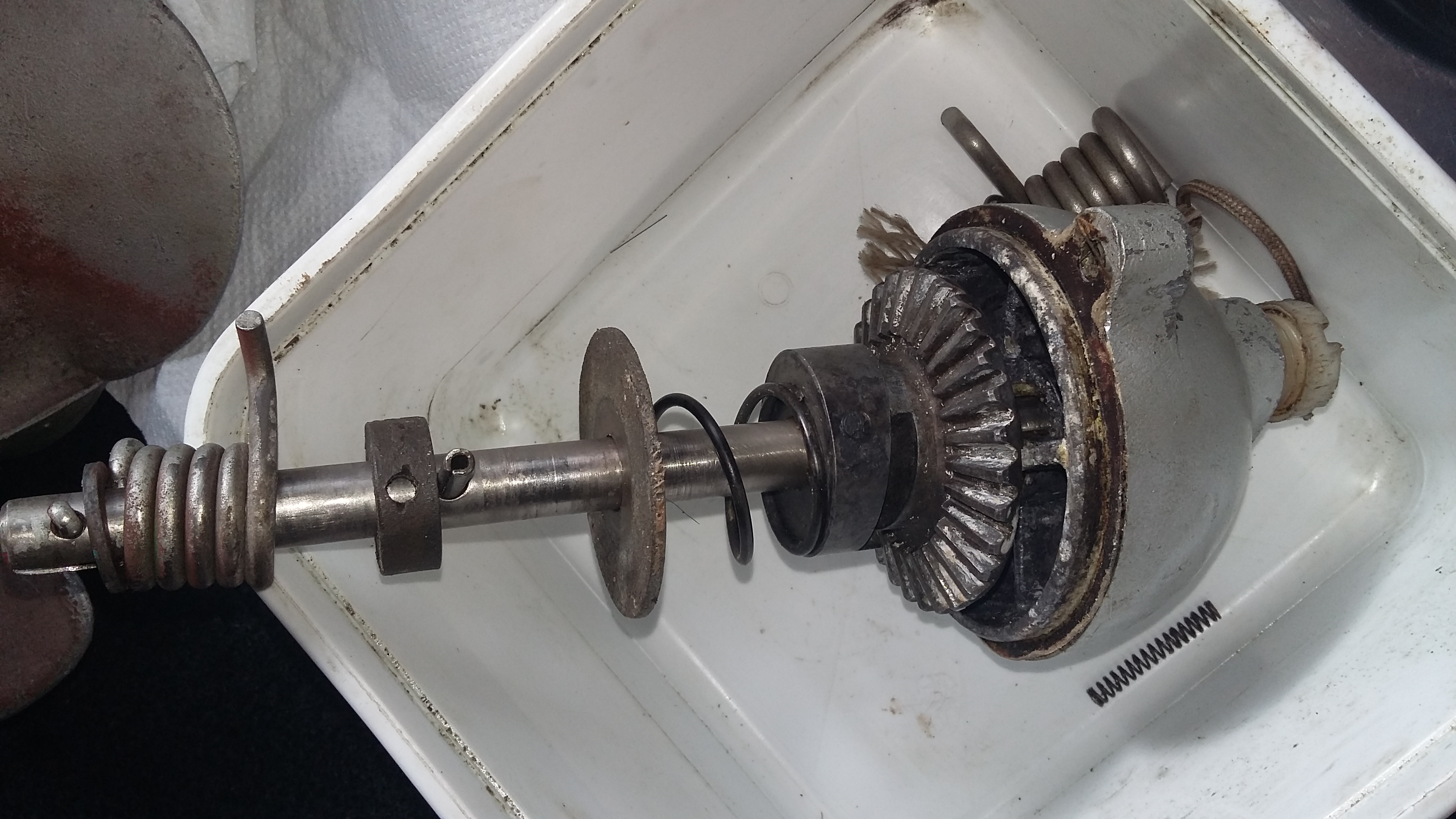

A few pics of the cleaned up parts.

Apart from that it looks fairly normal after a while in the wet stuff. The oil starts to look like milky coffee, as does yours.

As far as play/wear in the shafts and bushes, you'd have to re-assemble the box with all its parts and re-assess using your best judgment.
I try and aim for as little side to side or up/down movement in the prop shaft as i can possibly get, as this is the first place where your oil will leak from the box as well as the pinion shaft. I think new bushes are available somewhere if yours are too far gone. Take your time with it and don't rush.

I reassemble and check, before deciding on the bushes. The propshaft has very little wear marking, but certainly nothing to worry about. The pinion has a little up and down play, but none sideways. I've not removed the gearbox from the tubes, I understand that releasing the pinion from the shaft can be hard work, I was planning on reassembling and test running in a bucket, to see how the cooling water runs through.
The clutch release was somewhat slow, which I expect is down to the sliding parts being gunked up. Is the large spring likely to need replacing, or do they last forever?

The lubricant looks the way it does because it contains a large quantity of water, the top seal gets the most wear, as the pinion shaft is rotating two & a half times faster than the prop shaft, so it would be a very good idea to change both of them. lack of maintenance caused the corrosion inside your lower unit, you can either fix it or ignore it, your choice.
The majority of drive shafts pull off the pinion shaft quite easily, as sealed boxes have stainless ends on the pinion shaft, they are real easy!
