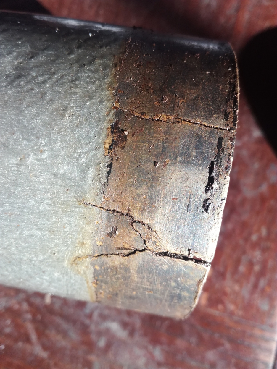

On closer inspection of the brass tube that came with the engine - it's chrome plated brass. Would that have come with a Century 100 originally? Or still sounding like a 102? And under some crud I may discovered the reason for the exhaust tube being too tight, there is some fracturing where the clamp tightens, looks like some rusty expansion on the exhaust outlet caused it - I will tape a plastic bag over the head to stop any bits getting in places, and give the the outlet a good going over with a wire brush/wheel.. I reckon that might allow it to slide on agreeably :)
Oh yes ,and here is a photo of the cracking I found on the tube.
