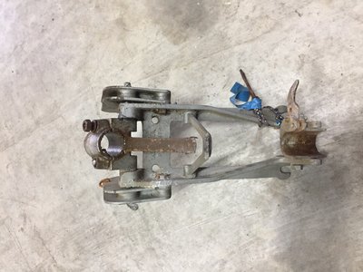

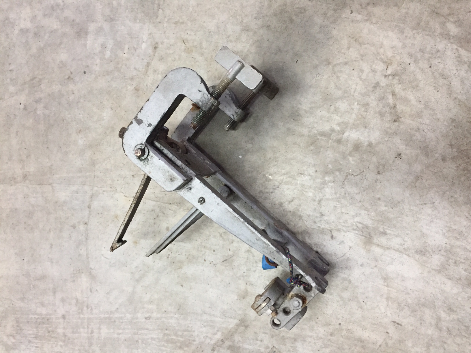

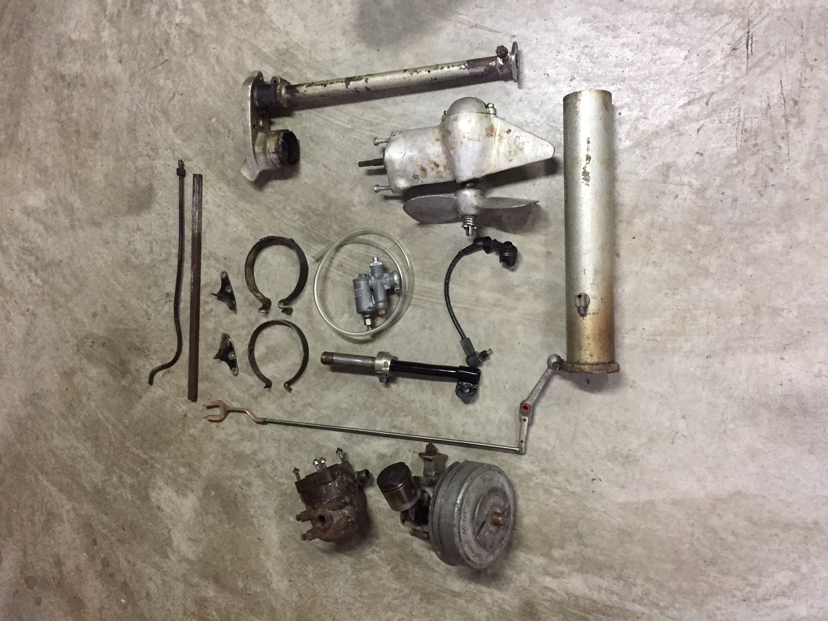

OK here's some more photos, I have partially stripped it down to assess what needs replacing.

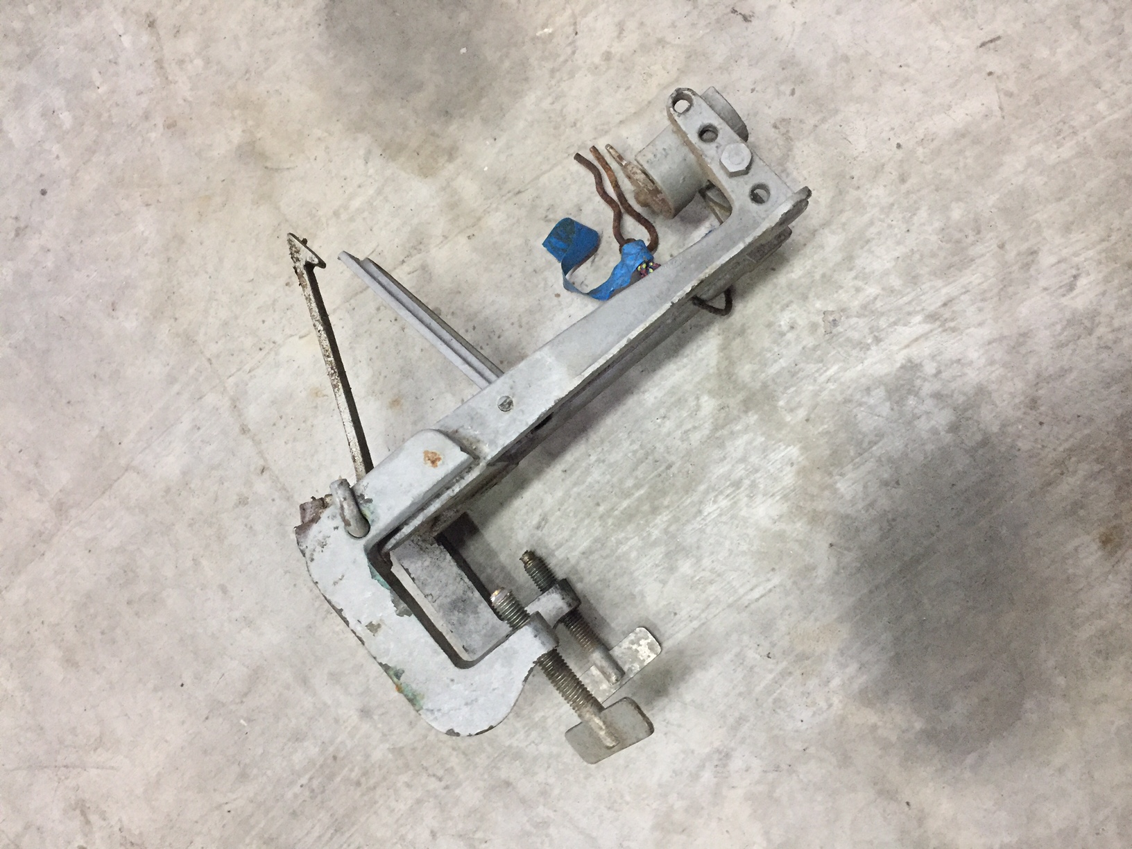

Here's some photos of the bracketRe: TC 102 prop ?
Seems to be a limit on the number of photos in each post

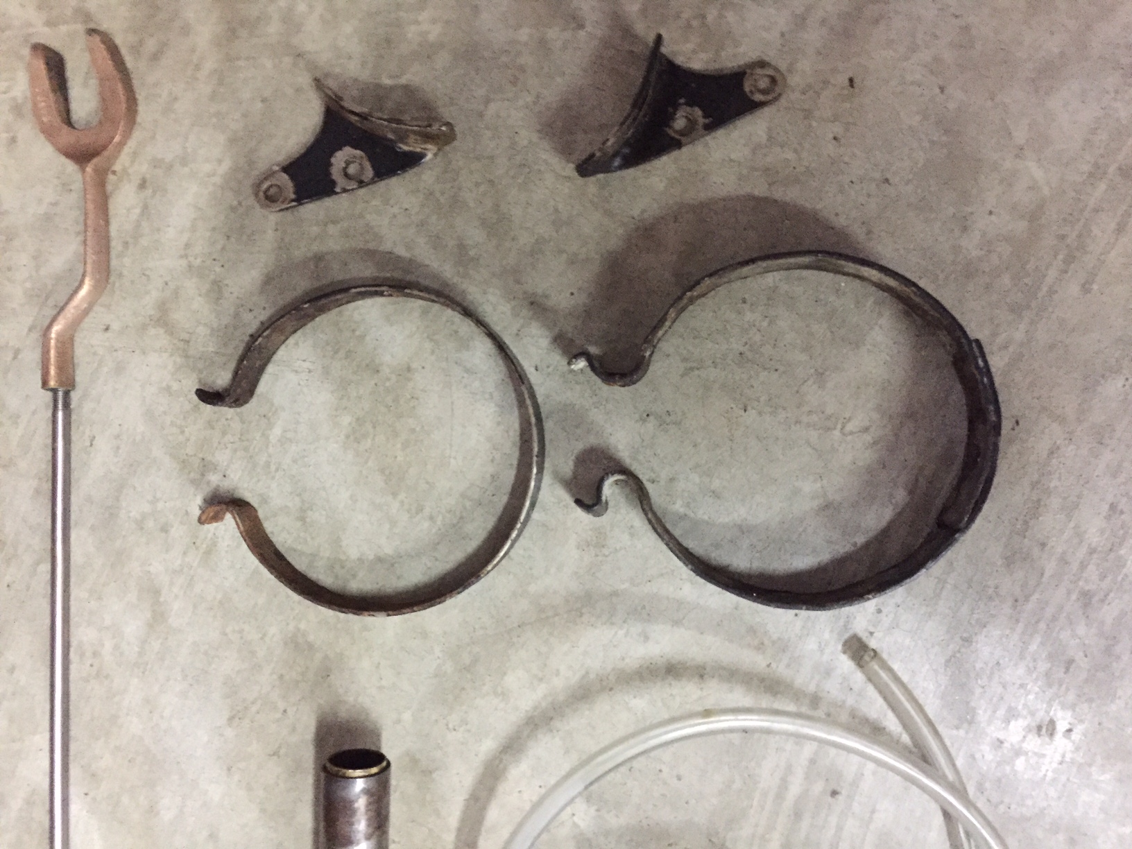

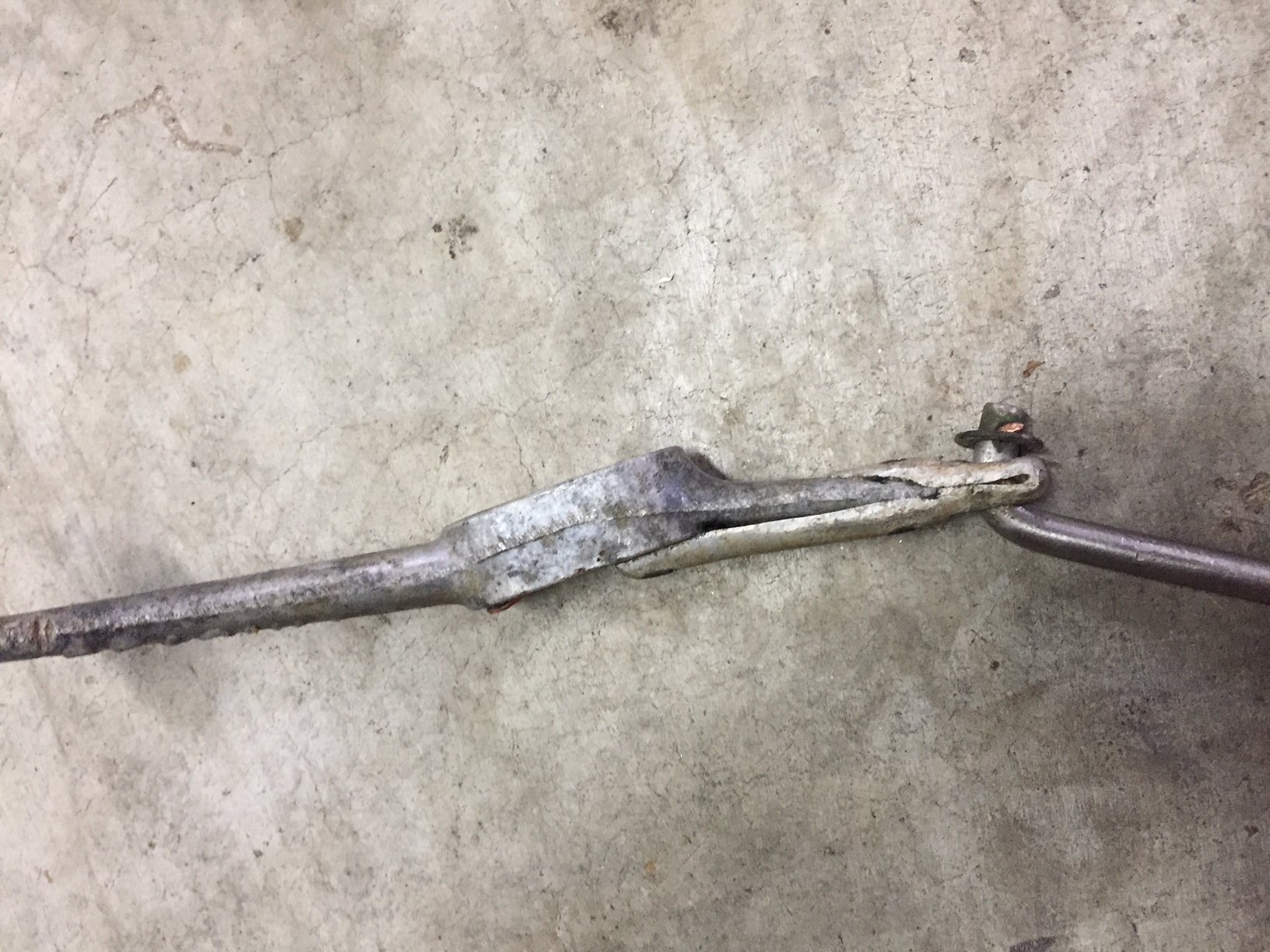

The clutch lever has been repaired at some time

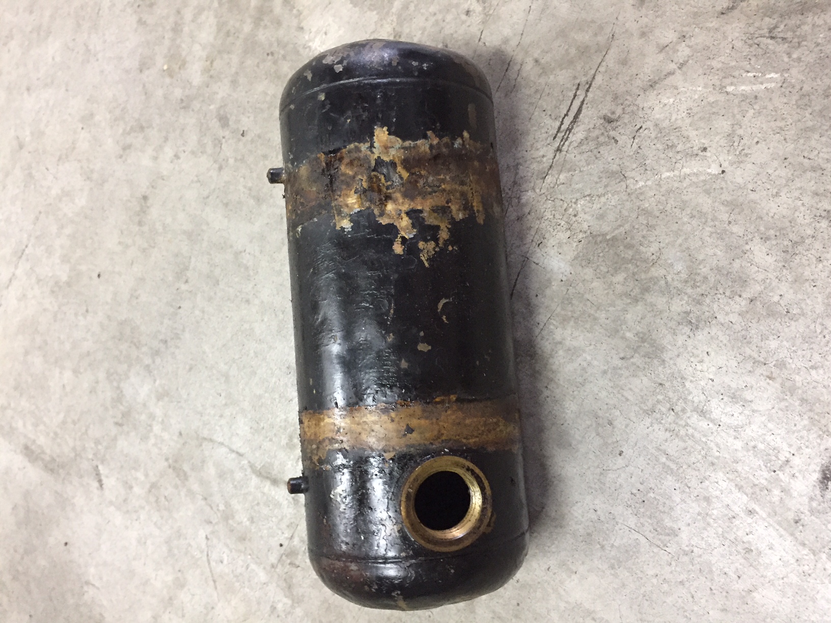

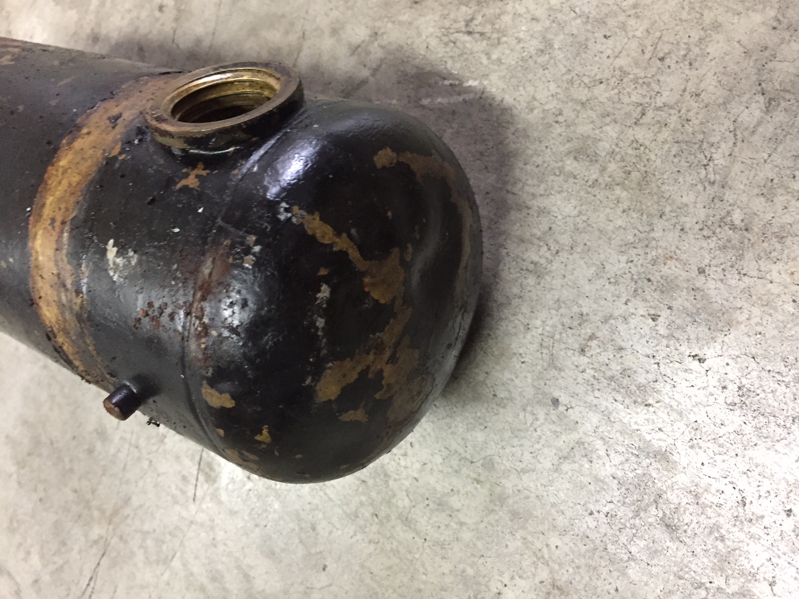

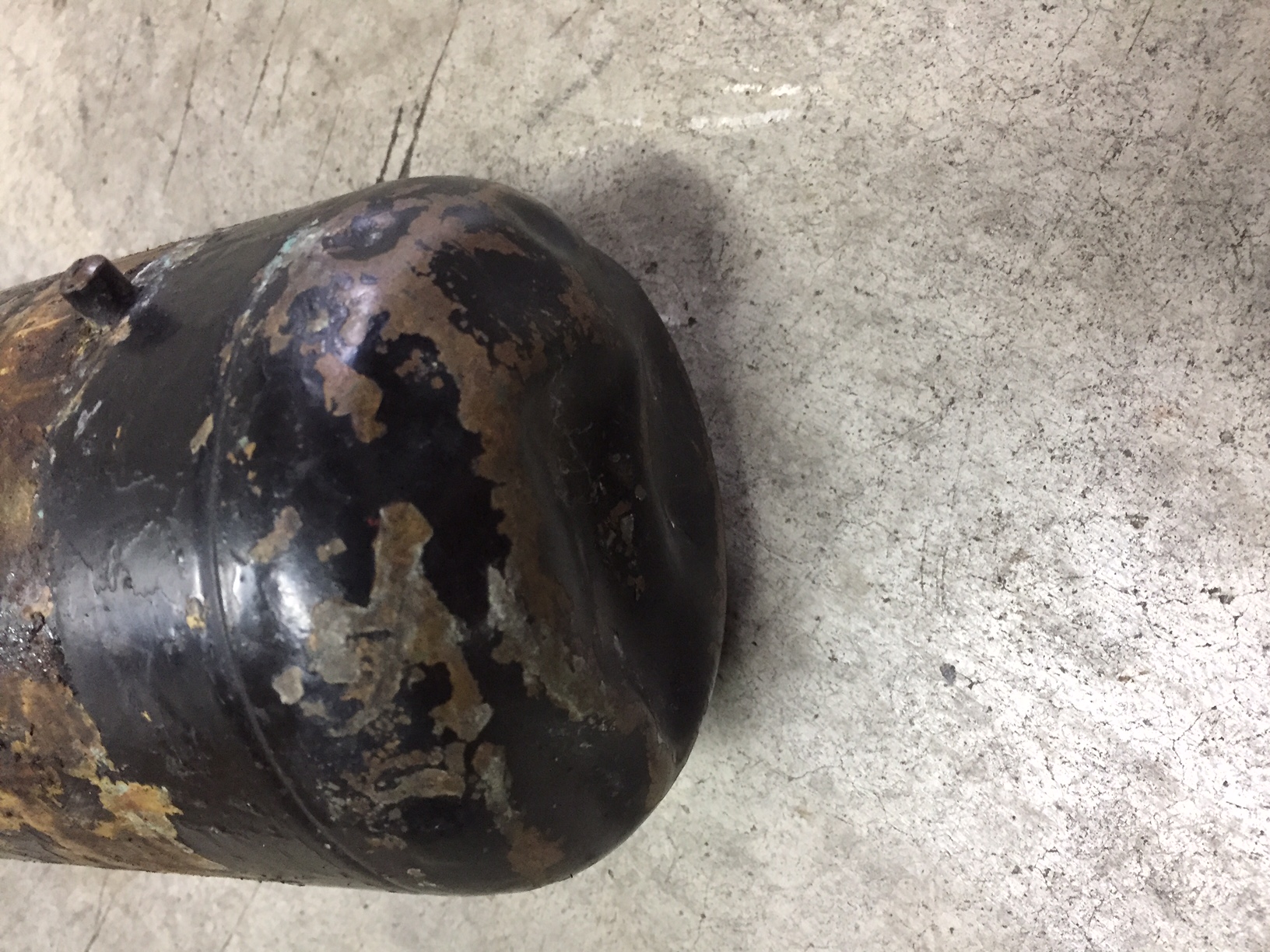

The tank body is pretty good but the ends need some attention

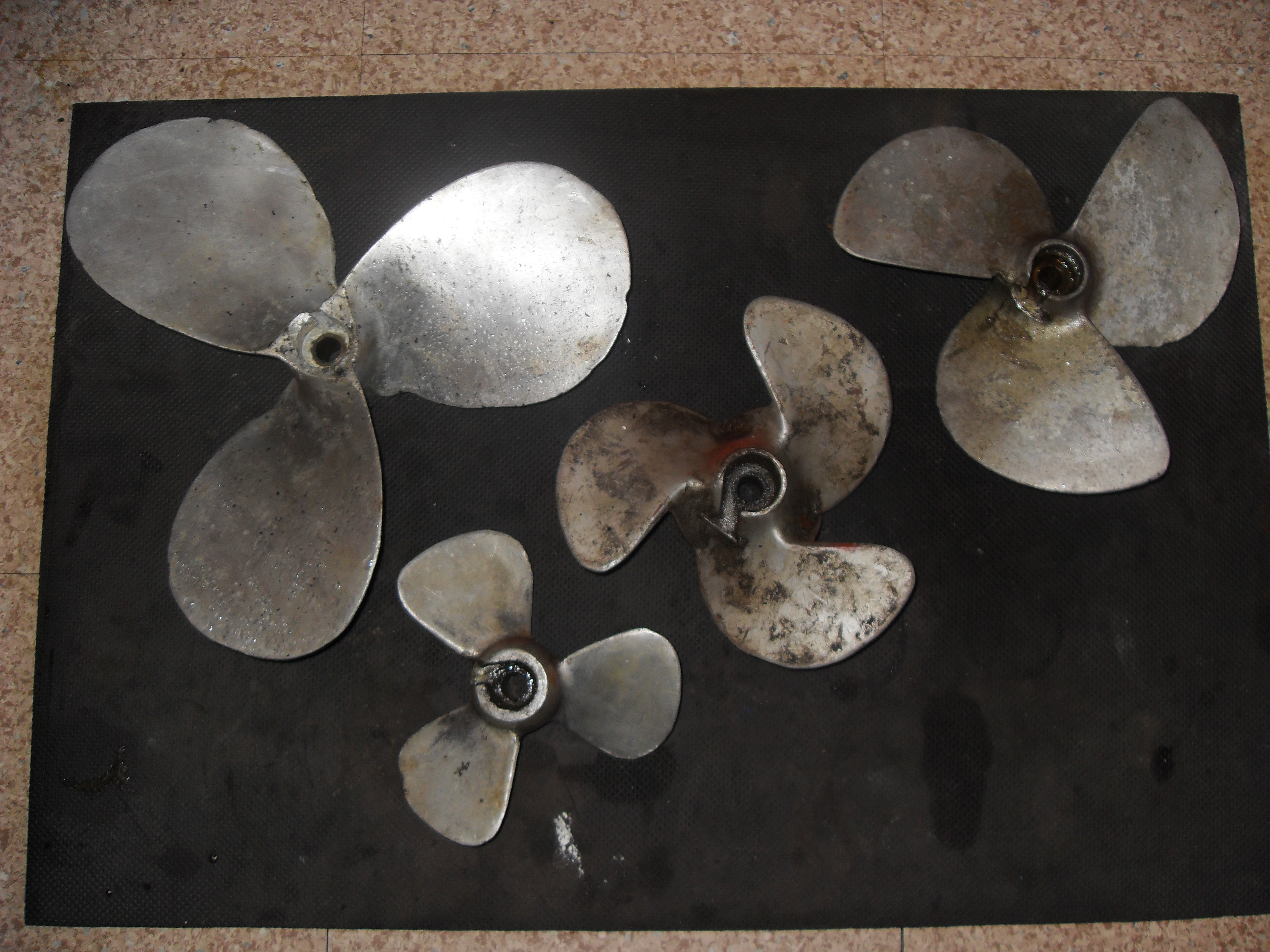

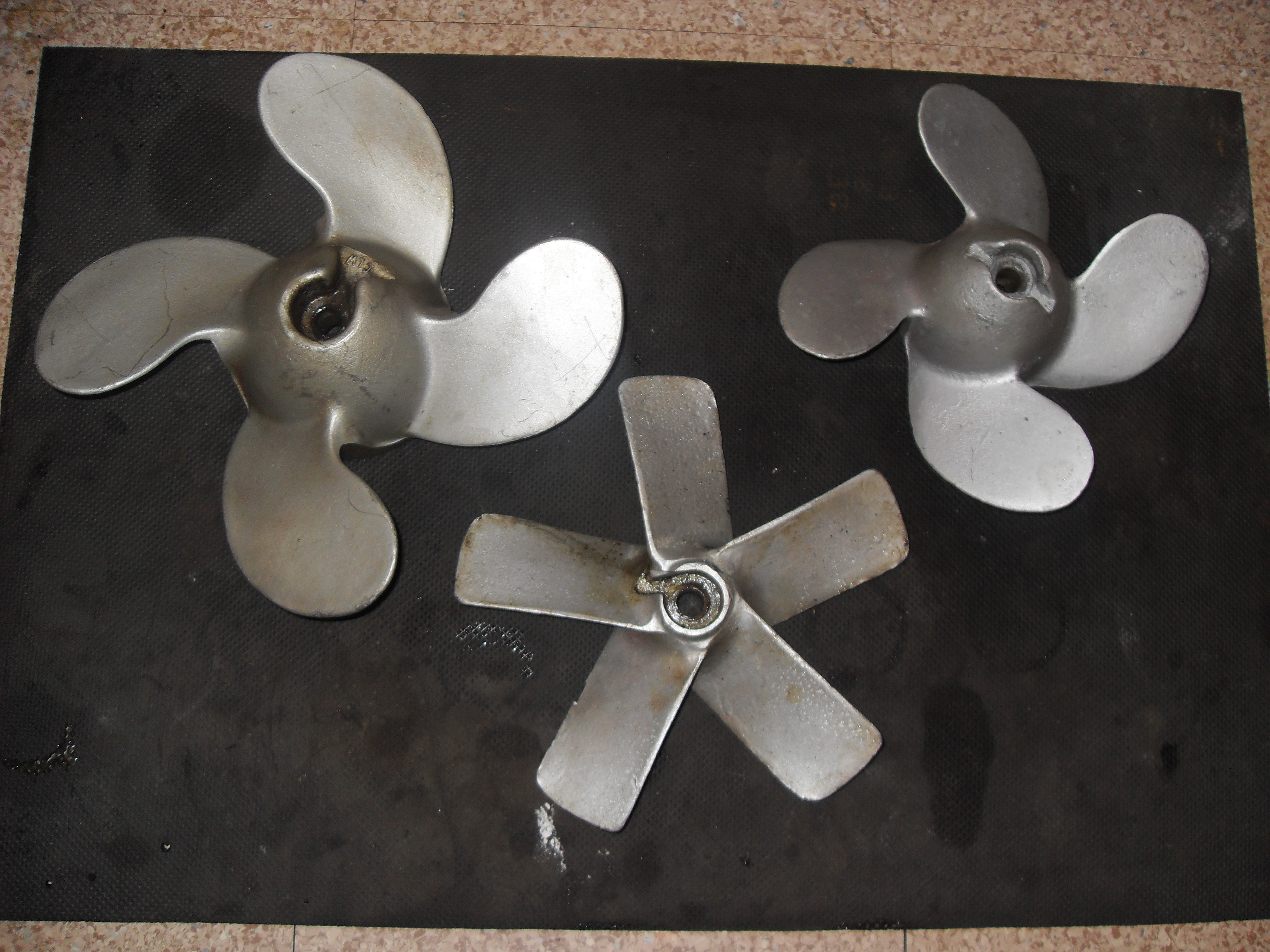

Let me try and elaborate a bit with props.
Seems there might be some confusion with early and later style props and what we call them, so here goes.
There's plenty of others in all different shapes and sizes, early - mid production and on into the later years.
This is just a snippet of what was produced over the years.

Your 3 bladed "Meatcleaver" is what we've always called a 3 bladed cloverleaf, it should have 102 on the hub.
While the straight trailing edge might well slightly resemble a cleaver prop
it seems to been a high thrust version of the 4 bladed 102 cloverleaf for use with heavier hull shapes, with no surface piercing ability.
I think you'll find as your SD researches start to bear fruit that your 3 bladed "Bargepusher" is a Wartime HSD prop, you will note if you look closely that it's cast from Birmabrite.

I'd also suggest just to be a little pedantic (Or accurate) that a four blade 102 prop is not a hydrofan. The hydro fan prop is 5 bladed as introduced on the century.top centre is a 4 bladed "hydrofan" for a 102.

Sorry Oyster the "Hydrofan" bit refers to the blade shape, long thin narrow corded blade, originally sold as a low drag improved performance prop offering a low cost upgrade to all of the pre hydrofan props, I think a 5% improvement was promised.
A performance upgrade for all the then current models from 40- to the century+ not including the 102+.

Interesting, I thought the term was used to describe the 5 blade prop. Looking at the olde leaflets on the SOS webpages I see that a 40+ was offered with a 4 blade hydrofan prop. I stand corrected headmaster

As here at S-O-S we have taken up the role as the primary factual reference site for Seagull data, & the moderators have fallen into the task of keeping it as accurate as possible, hence us acting as grumpy schoolmasters!

Yah. I always thought the hydrofan was for the 11 and 13 inche five bladers. Thay look most un-nautical and upset my sensibilities.....Oyster 49 wrote:I'd also suggest just to be a little pedantic (Or accurate) that a four blade 102 prop is not a hydrofan. The hydro fan prop is 5 bladed as introduced on the century.top centre is a 4 bladed "hydrofan" for a 102.

Chas. i think if you try and remember from a couple of years back that YOU now have that 3 bladed bargepusher prop, although my wartime research hasn't revealed anything at all yet about HSD's or what sort of prop they wore. I rejected this prop from my "bargepusher" purely because the hub was far too small for a PLUS sized gearbox. It just didn't look right to me. Up till now i've only ever heard a rumour that 1 HSD survives somewhere, hopefully there are more. Apart from maybe 2 other earlyish post war "bargies" i've seen over the last 6 years or so, most early 102 bargepushers seem to have a 4 bladed cloverleaf unless anyone can confirm either way.
I have my doubts with these 3 bladed versions though. There's far too few genuine unmolested 102's these days to be able to arrive at any firm decisions as to what's genuinely original to that particular motor, or what is a later addition or "upgrade".
Having said that, doors are being opened all the time on dusty sheds and garages all over the country so who knows what will be discovered. We sit and we wait.

I'm a little concerned however looking at the pics provided that the gearbox for this 1958 102 has holes instead of slots for the water inlet.
I can't help thinking that at some point in this motors life that the entire gearbox/prop combo has been swapped from an older motor.
It makes sense going by the "bowtie" prop, but i'd like to see some better pics of the gearbox before i make up my mind on this
Unless the owner is worried about originality, then i see nothing wrong with the parts so far. Repairs are one of those things that a motor picks up along the way. It's easily put right. Just ask...
