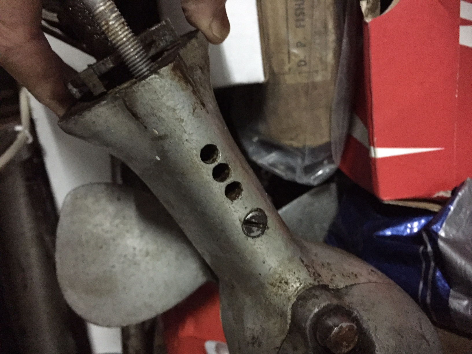

A photo was asked for showing the water intake on the gearbox.
Thanks for all the replies. Does this provide any more clues ?
Marcus
Marcus
Re: TC 102 prop ?
It does for me any way 3 holes in a row,looks like it's from a very late pre 57 model.
