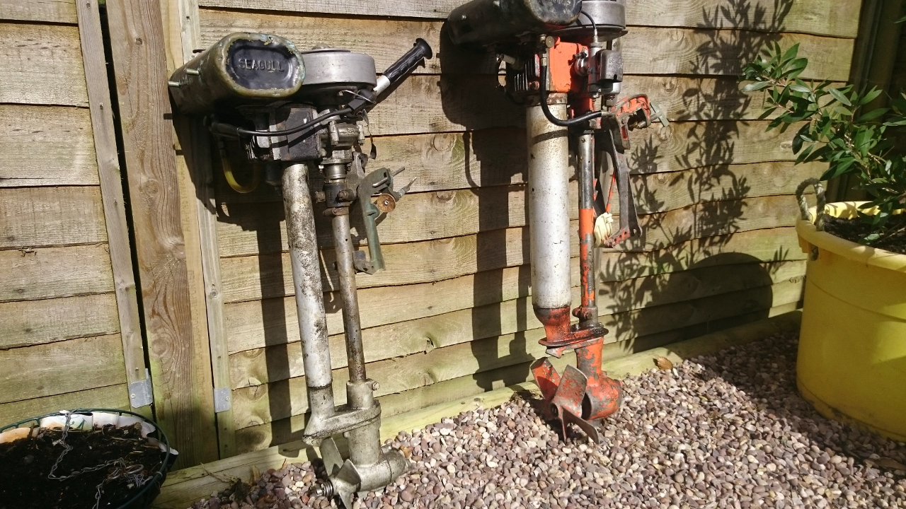

I've aquired a couple of seagulls and I have some questions.
The big one is a Century circa 1971 and the little one is a Forty Minus from 1956/7.
The little one appears (to my untrained eye) completely original apart from one thumbscrew cup which is steel (and rusted), the other is bronze.
The exhaust is aluminimum (with dents that I assume weren't put in at the factory), is this likely to be the original exhaust as I see images with the chromed brass ?

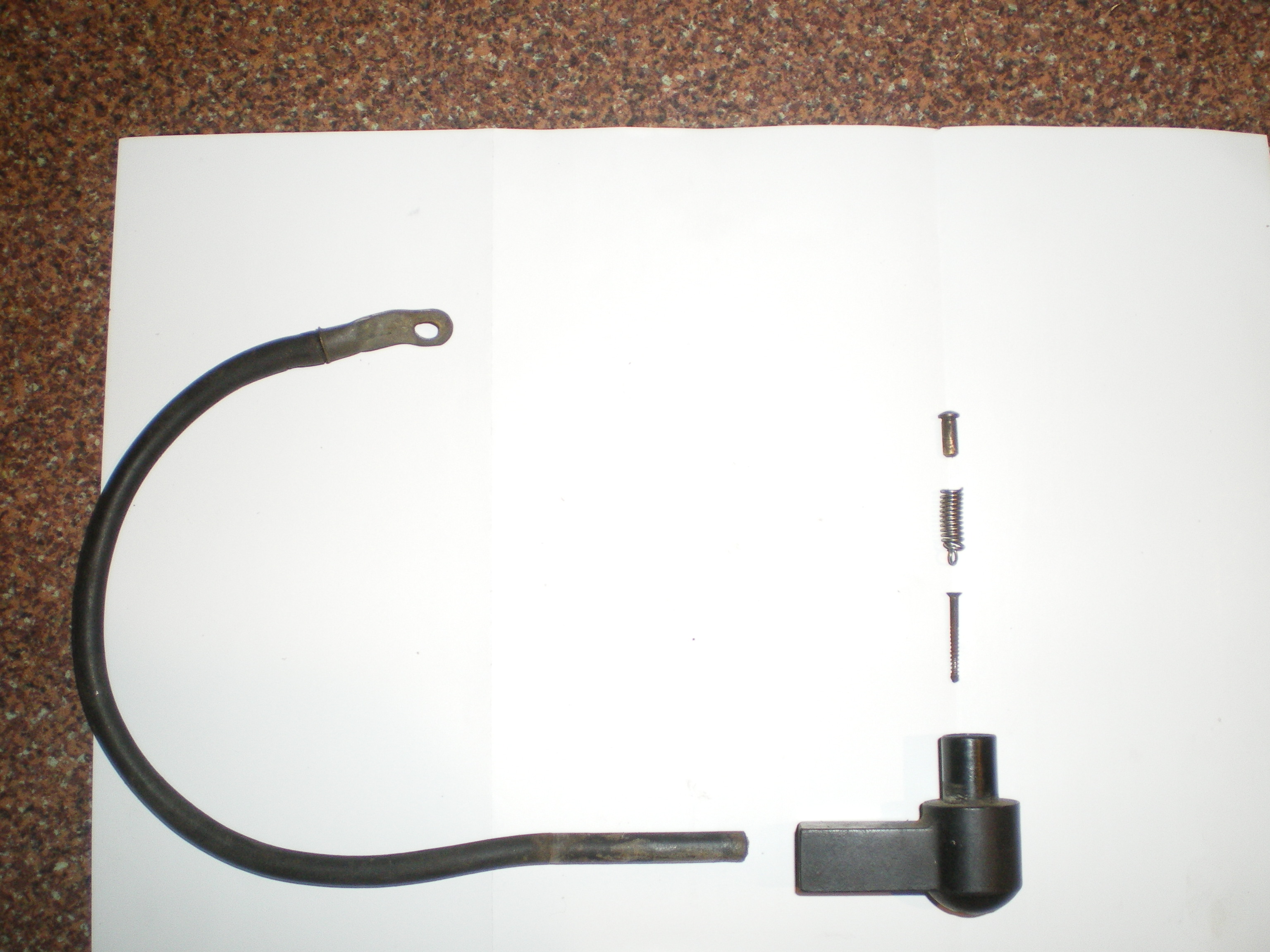

HT leads - the big one has a dead HT lead with what I assume is a resistor built in (2 inch bulge near plug end), the little one's HT lead has some restance but produces spark with both motors.
Any ideas as to what the resistance range for a good lead should be, I put a straight cable (almost zero resistance) cable on the big one and have big spark just turning the rotor by hand (I haven't tried starting it with this cable)

Re: New Owner, 1st Post
Hi and welcome,
Have a look at this thread.... I have already asked the question about the HT leads!

The bulge is probably a suppressor. It is to cut radio interference. I think they came out in about 1978 and where recalled by BS as a disaster. I'm assuming there should be next to no resistance. It is a solid wire from one end to the other. Any unwanted resistance would be at the connections either end. This screw might be rusty. Left click on picture to expand it.

Cheers for the info on the HT leads, the lead on the 40minus has some resistance (I will measure it again), the century was no connection, both motors run fine with the 40minus lead.
I used a lead from a dead outboard (crescent 4hp) with the connector from the century, this shows almost no resistance and produces a fat spark (much larger than the 40minus lead) just turning the top by hand.
I haven't run it like this just in case it the lead is supposed to have some value of resistance.

I need a motor for my old mirror dinghy and so bought this pair on ebay as non-runners.
When I got them I did a quick check, both had compression so plug out, bit of oil in the cylinders and a pull with a makeshift cord, no spark on either.
That was a few months ago, last week after reading up a bit I decided to have a look.
The 40minus was the first as it is easier to handle, the magnet didn't seem so strong so I wizzed it round for a few minutes (with a belt driven from the motor on my electric compressor as I don't have a socket big enough, the nut is about an inch and a quarter). Still no spark.
Took the top nut off, cleaned and set the points - bingo, Sparks !!!
Cleaned the carb, filters fuel line and tank.
Reassemble, hang it on the fence, put a bit of fuel in, tickle the carb, close the choke and give it a pull ... rrrrmmm it bursts into life with lots of blue smoke and spinning things...err..how do I stop it...hand on air intake and it stops...phew.
Cool, it lives.
I've tested it in a wheelie bin and it pumps plenty of water, ran for 20 minutes and switched fuel off, the motor stopped when the carb ran dry. I opened the fuel, tickled the carb, no choke and it fired straight back up first pull.

The Silver Century was a bit more challenging to get running (and a lot more eventful, fortunately there is no video).

The Century was a bit tougher to crack.
Lots of compression but no spark. I removed the black plastic cover, cleaned the points but when rotating the flywheel the points didn't open, tried adjusting but still no joy, flywheel has to come off.
Put nut back on, give wife big lump hammer, hold the flywheel with the motor above the grass and tell her to give it a whack.
Wife gives nut a gentle tap, 'no no, hit it hard, just the once'. Smack..flywheel loose, that was easy, wife pleased she can now remove a flywheel on a seagull.
On inspection it appears the back plate on the points is bent so I tried to straighten it and the spring flew off into the grass. I found the spring after 10 minutes of searching and reinstalled it on the now straight points.
Points back on and I can get them to open and adjust (although a new set is probably in order)
Reassemble and give it a pull, no spark hmm.
Off with the HT lead and test for continuity - nothing.
Test HT output when rotating flywheel and I can see current.
Try the HT lead from the 40minus and get a spark, excellent.
Clean the carb, lines and tank, put it all back together and bung it in the wheelie bin for testing.
Fuel in, tickle, choke and pull, nothing.
Because the motor is higher and has more compression it is a bit awkward to get a good pull.
2nd pull nothing, 3rd nothing.
4th try I give it a right good pull, motor fires up and wheelie bin falls over, through clouds of smoke I manage to right the bin and motor but how do I stop it, this carb has a cover with a gap so putting my hand over the bottom doesn't stop it, turn the throttle down and it still doesn't stop.
Rising panic, I switch the fuel off knowing that this probably isn't going to help, I would pull the plug cap off (like I do with my mower) but it is the old screwed on bakelite one from the 40.
Closing the choke with hand over the carb and it splutters to a halt.
Phew.
Try again.
Refill wheelie bin and with wife firmly holding both the bin and motor, one pull and it restarts.
Runs fine with plenty of water pumping, ran it for about 10 mins until the fuel ran out (I'd only put a bit in the tank).
The clouds of smoke on starting both of them was from the liberal amount of oil I had put in the cylinders whilst spark testing, once they had warmed up there was just a normal amount of blue 2T haze (I was a bit generous with the 2T, probably around 8 to 1).
The only thing missing from the 40minus was the fuel cap, other than that it was complete. It's very grubby, got character dents and the rust on the drive leg has blistered through the chrome, I'll be keeping this one.
The Century is missing the fuel cap (because it's now on the 40), drive spring and split pin and could use a new set of points, at some point the gearbox has been removed as there are two allen bolts holding it on and the seal doesn't look brilliant. It's also very grubby and the tank is dented (but not leaking). It was painted a delightful rotavator orange although most of that has flaked off.
I don't really have any use for this one as it is far too big for my dinghy but I'm happy that I got it to run.
