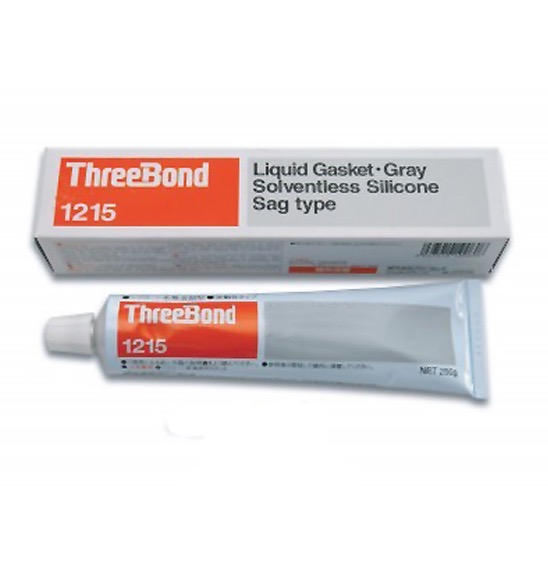

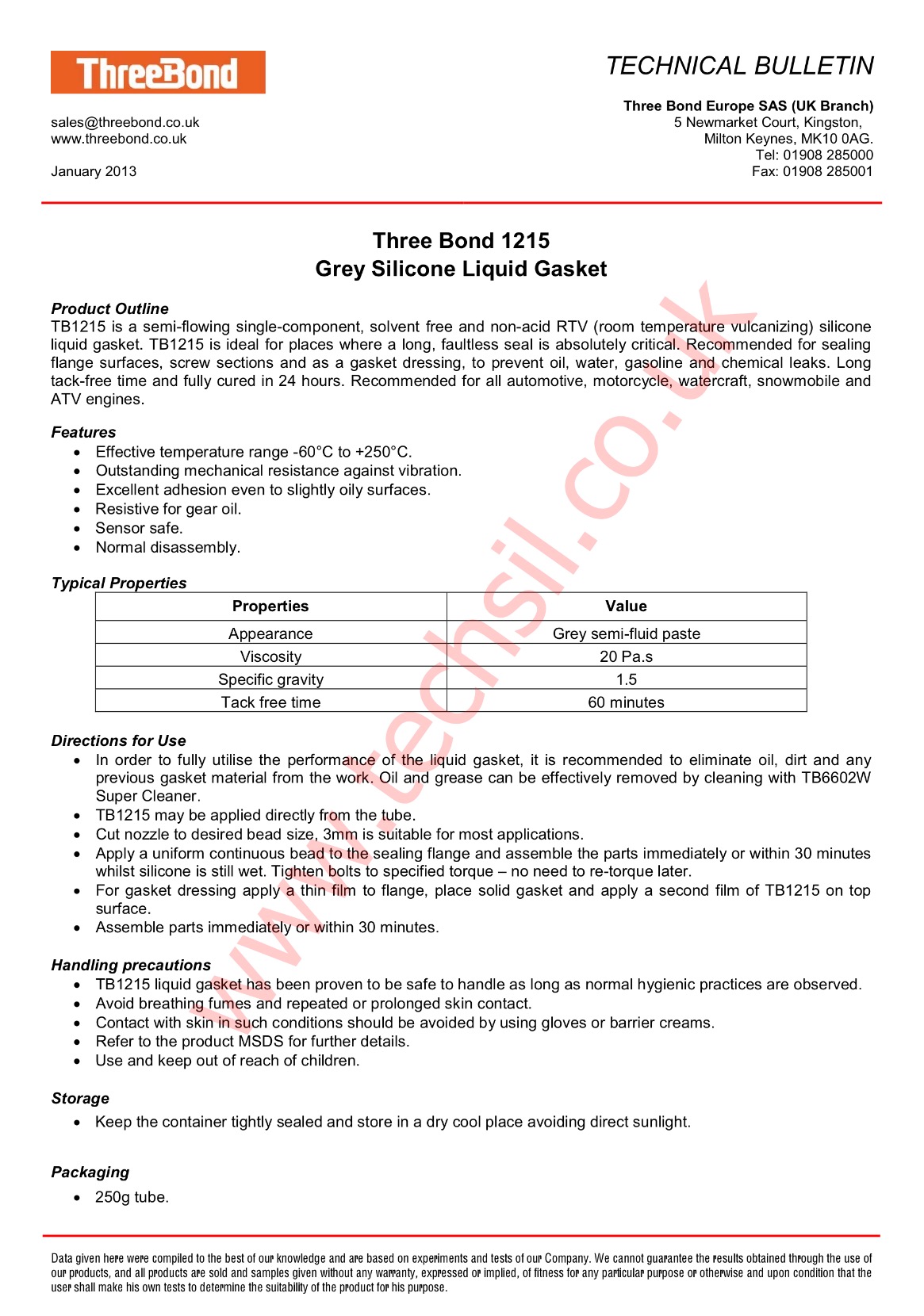

24 years in the motor trade and this is the best sealant I have ever come across, it's factory spec for most jap cars for water pumps and gear boxes where no gasket is used, for your application it would be perfect, high spec, easy and non permanent, it's even grey so you won't see it. Personally I don't mind the exhaust leaking a little onto the gearbox, makes them look used.

No it should not.Kevin O Connor wrote:Can anyone tell me, if the exhaust tube is supposed to be sealed where it goes on to the gearbox housing ?
It is a loose clearance fit, the only motor where they attempted a semi seal, was the 170 with its stepped plastic collar.
The rest are a rattle fit.
Re: 40 plus exhaust
Personally I would leave it well alone unless the hosing is really badly corroded. As H-A says it's a rattle fit.
- Posts: 758
Re: 40 plus exhaust
every one of my engines (16) have some blow by. plus all the 102's with the water line routing through the bottom will pass exh. its really not a problem. I certainly wouldn't try sealing them.
