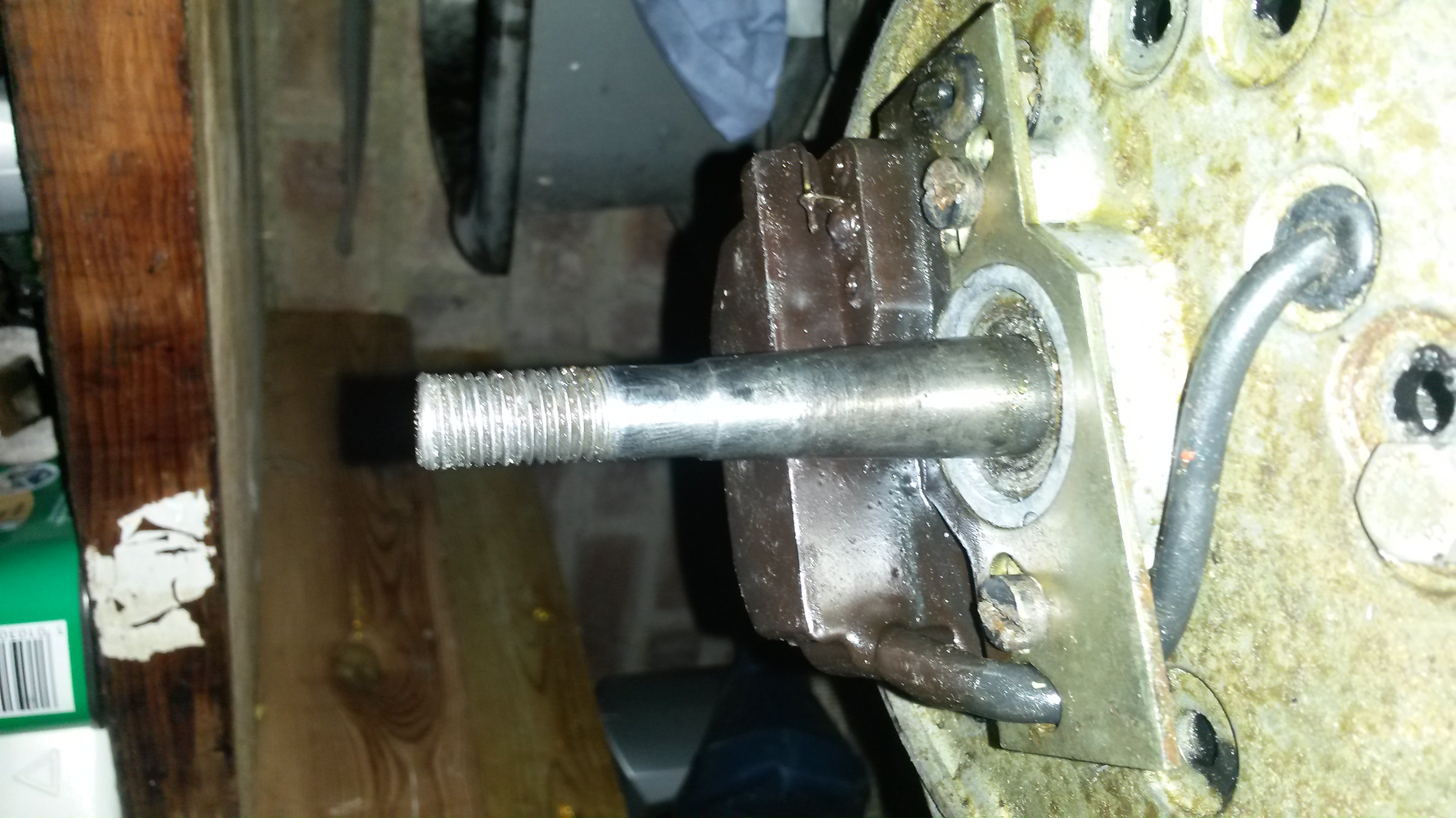

Any ideas of the thread before I go and buy a tap and die set anyone?
Its a silver century Ws1613bb5
I think it's bent...

Which thread are you talking about?
Re: I think it's bent...
1/4", 5/16", 7/16" BSF that covers it, other than the fuel tap and carb.

They do bend very easily on the CDI engines, I made a puller.
New crank time, you can try to straighten it if you have the equipment, but replacement cranks are cheap.

Thing is I'm not sure if it is bent or the thread is shot, I'm going to try and re thread it first I think...

Seagull solved the wobble problem by seating the flywheel onto the crankshaft with a 10 : 1 taper & this question was really about a damaged thread, which H-A correctly answered, it's 7/16 BSF.

I have had it before where only the threaded part of the crank was bent, as if it was clouted to remove the flywheel, once on the taper though and nut tight all was well with no flywheel wobble whatsoever, but then again why would there be, the threaded part is only there for the nut to push the flywheel onto the taper also I guess it stops the flywheel from being stolen
