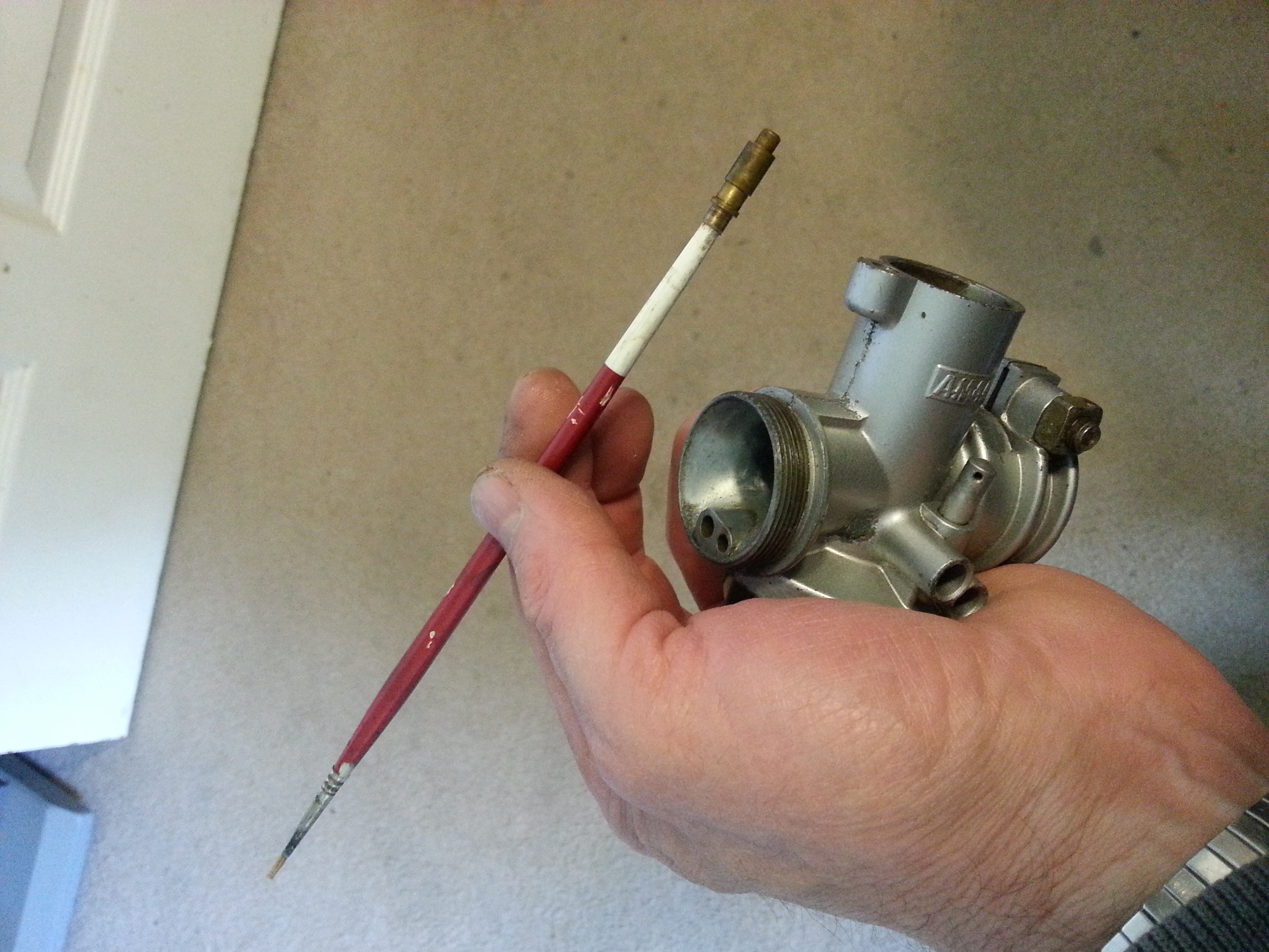

Thank you Naughtybits, I have just redone 2 3 4 with cleaner and 3 and 4 with a wire tooth interdental, they should be clean now
looking round for something to push out the brass atomiser I found this wood handle from an artist's brush its conical and fits inside the atomiser but even after gentle tapping with a hammer it shows no sign of popping out, how hard do you think I can hit it without damage?

The age-old question I think you'll have an easier time using an old drill bit or an allen key that fits snug inside - a sharp tap should do the trick.
Edit: I should have clarified to use the blank end of a drill bit against the tube, for the reasons pointed out by Charles...

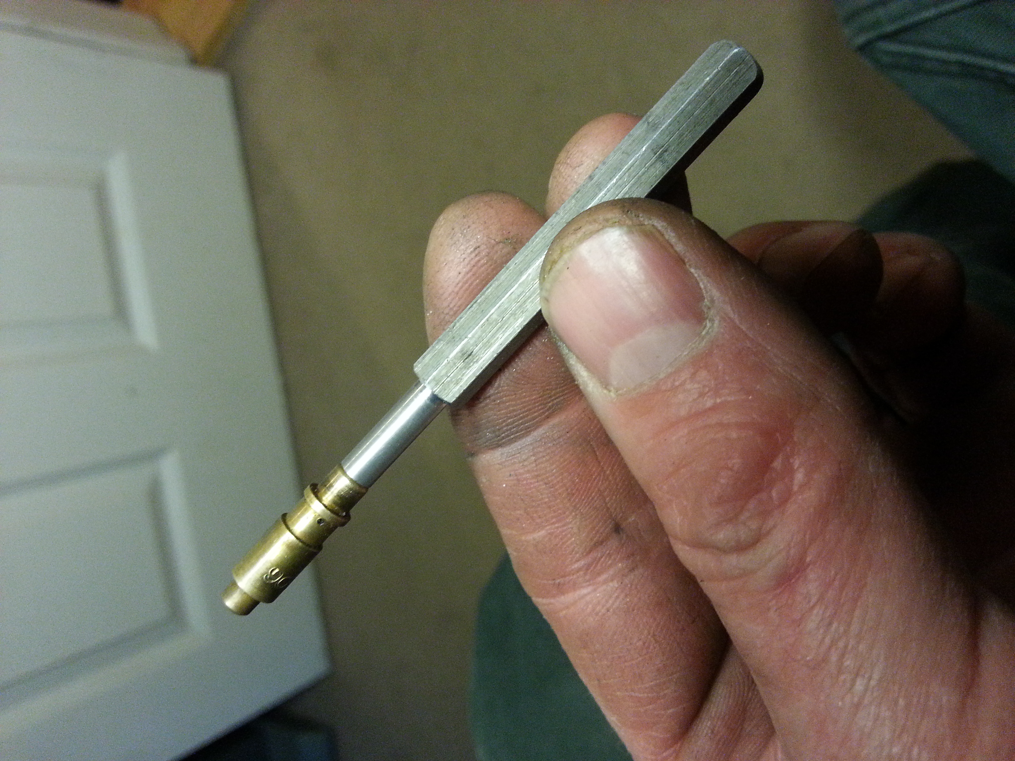

It sides down into the float chamber, the best way to extract is with a stepped aluminium drift, if damaged it can affect the fuel flow & the emulsion tube is not listed as a separate part in the parts book & it would mean buying a complete new bare carb body, mind you looking at the condition of yours that might best the best idea.
Re: instructions or Amal Carb
My thoughts exactly, you beat me to it.Charles uk wrote:It sides down into the float chamber, the best way to extract is with a stepped aluminium drift, if damaged it can affect the fuel flow & the emulsion tube is not listed as a separate part in the parts book & it would mean buying a complete new bare carb body, mind you looking at the condition of yours that might best the best idea.
I have already tested the paint brush method, and that worked on a non corroded carb.
If you have no success, and have no access to a lathe, I can turn a drift up for you.
Thanks both, with renewed confidence I gave the brush a harder tap and guess what?
yes the brush snapped inside I managed to poke out the wood with a cotton bud stick
still no luck in removing the emulsion tube, H-A, thanks, I will take up your kind offer of a Drift if I may. PM on its way
Got your P.M.
I have made you one, and tested it.
P.M. your address and I will pop it in the post.
You can pay me in beer.

The Drift arrived this Morning, I put it in place, 4 gentle taps and it was loose, another squirt with WD 40 and I pushed it out.
Charles you were 100% right, the flange was clogged with gunk, I am cleaning it up now with Brasso, the Carb is soaking in Carb cleaner, when the Emulsion tube is glowing I will start on the Carb.
you are amazing, thanks H-A for sending this magic wand
The Emulsion tube is bright and sparkling, I checked the little hole and its clear too, the "bit" it fits into has been cleaned and polished, I have just put it all back together and after my lunch it's going in the wheely bin
