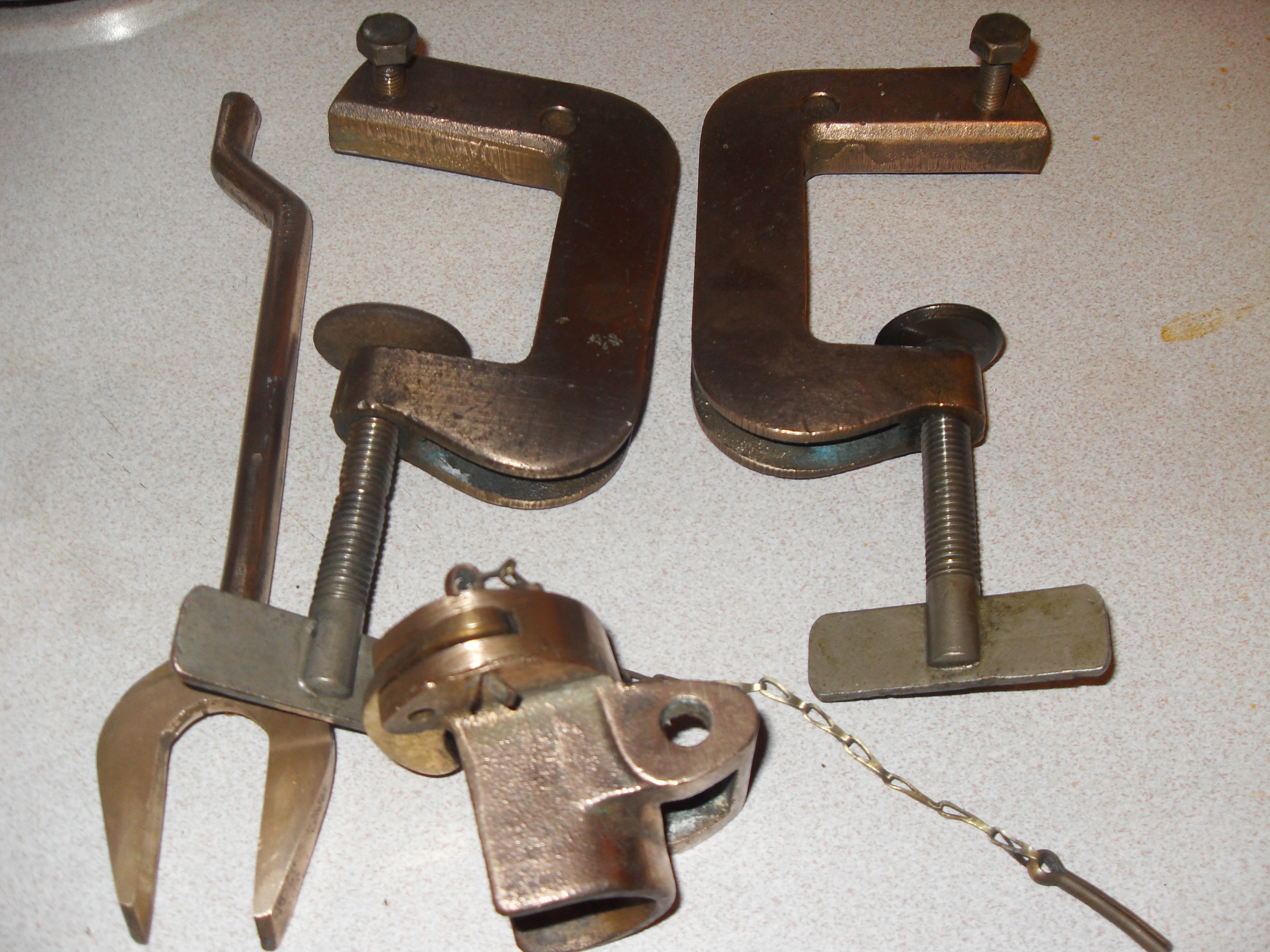

2 more things I am planning, I cleaned out the tank but I still think it needs more work so I bought Caustic soda and some rubber gloves I will be filling the tank with that and soaking it for a couple of days, I just wonder if the cork on the tap will withstand the Caustic?
Then I read about bright shiny transom brackets and how to clean them up so a Caustic treatment for that too

Transom brackets i've been tinkering with for the last couple of days.
After a soak in the caustic solution, i rinse with plenty of water and let dry.
Then attack it with a wire brush and/or some rough sandpaper.
Finish off with your choice of metal polish and admire!

Yes that's the look I want, thanks for the instructions
further reading on here says Caustic soda will strip the paint off the tank, that doesn't sound good, so maybe not a great idea after all
Re: Where should I start
If you leave too long in caustic soda metal goes black and is a shite to shine. Overnight dip and a wire brush on a drill works for me. Wish it did remove paint but haven't experienced that.
Thanks Hugs, Caustic soda is in the tank, I will be careful when I take it out not to get it on the paint, then tonight I will do the Transom
