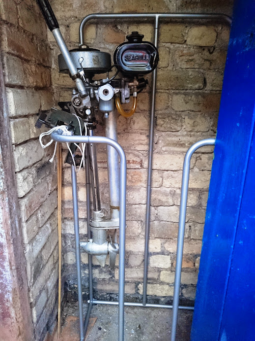

One thing I havn't yet done is check the points so I read up on how to remove the flywheel cover and I know this will sound stupid but when I take off the flywheel nut will everything else stay in place?
I got a stand to put it on to keep it upright in the outside Cludgie
