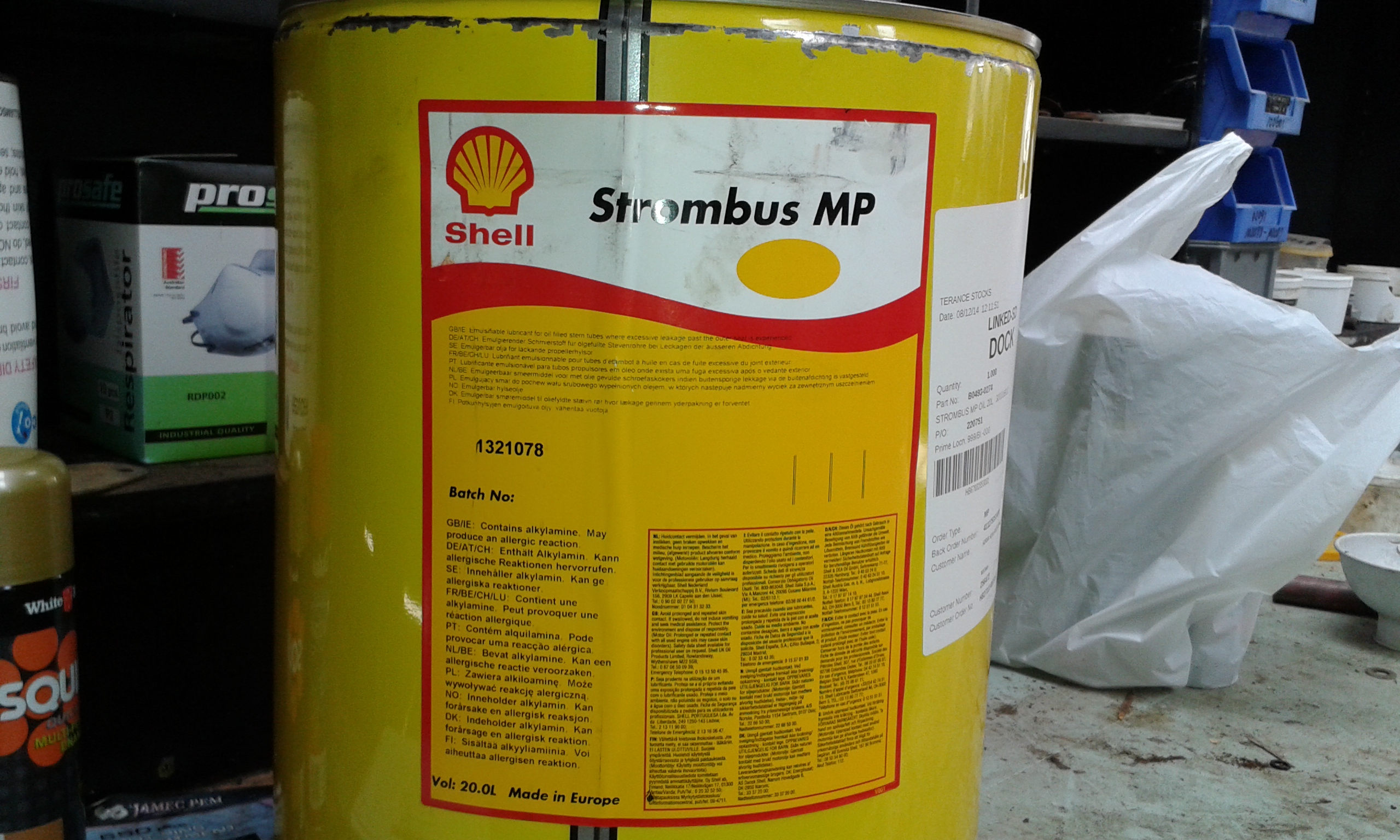

Post by Adrian Dale » Sat Jan 03, 2015 11:12 am
As you are in the UK you shouldn't have too much trouble sourcing the right oil but do make sure it will emulsify. Put a 100 mm in a flask then add 50mm water, whisk until all the water is in suspension then let it settle for a few days; the water and oil may part thus in the gearbox on the rack in the shed, salt water will be covering the lower half the gear wheel causing corrosion. next time you use it, even if you top up with fresh oil the damage will have been done and gear failure will rapidly follow. In a good tight emulsion the water won't separate even after a month or more thus no corrosion. Yes the oil is expensive but it will save you shed loads of time and money in the long run
I use my gulls for regular trips up and down the Chanel, stopping off at the odd shack on the way, often this means long running times in access of 4 or 5 hours with out top up or draining. Just in November on such a trip, I damaged a gearbox by the wrong oil and was faced with a rebuild and a spares order from SOS in the UK. That oil was Penrite 140. Penrite have actually stated that their oil is not suitable for gearboxes were water ingress may occur. Unfortunately I had not read the post that warned against its use.
It is my intention to do a 16+ hour non stop run later this month using just one fill of oil. I will post the results. The oil I am currently using is Shell Strombus MP

Post by Adrian Dale » Tue Jan 13, 2015 12:07 pm
Exactly, Penrite won't emulsify. see the two photos attached, both had 20% water added which was whisked to get a good even mix then left for 48 hours, when the photos were taken, the Penrite separated; the MP did not and in fact it remained as an emulsion in the same jug for over a month before I disposed of it. This is a tight emulsion and if I had left it for longer it would have remain in that state.

Post by Adrian Dale » Thu Jan 15, 2015 10:45 am
This is what I use now.
