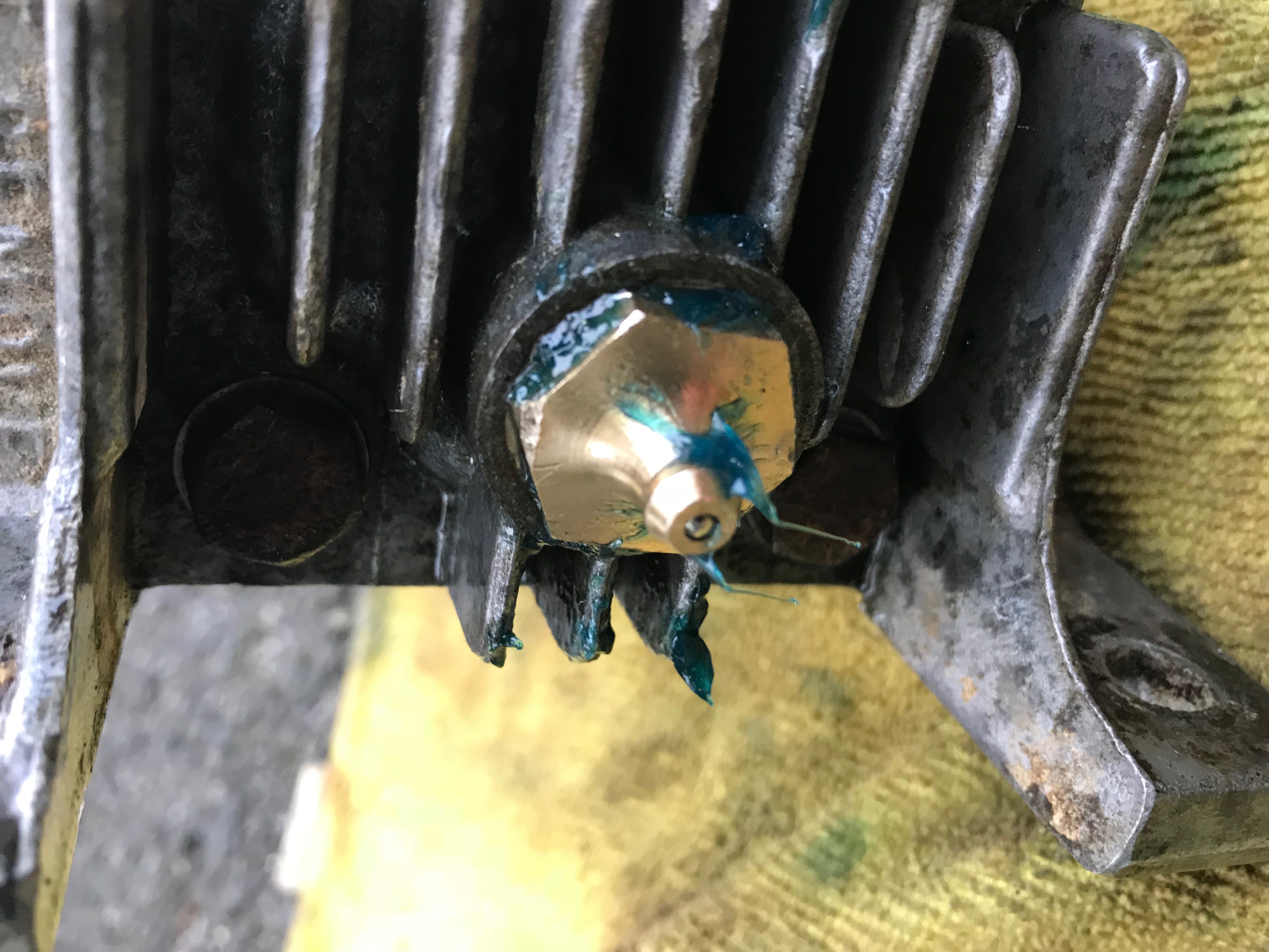

These are a perfect fit for the spark plug threads (ex 125/170/QB) and will absolutely unseize/move even the most stubborn piston with a simple handheld grease gun, as long as piston is high enough to cover the ports. My only recommendation in hindsight is to try to use the washer from a spark plug. It worked just fine without but I had to give a lot of torque to ensure it sealed, perhaps a plug washer would help alleviate any possibility of stripping the threads.
Here's a shot of one in action. I had previously given up on ever unseizing this piston, and bought the nipples on a whim for educational purposes really only to see if this technique worked. Can confirm it does and that the same piston/block is now back in service!

I fill the cylinder with a mix of 2-stroke oil & diesel before using a home made nipple (leaving the minimum air space), give a few pumps to increase the cylinder pressure & leave for a few days, this gets a little lube down the sides of the piston, with luck, before giving it the big pump!
