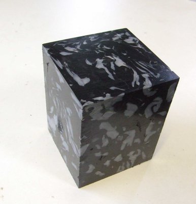

Hi All.
Just to let you know that I took Charles and Hugz advise and made a thrust block so I’m no longer looking for one.
Found the Delrin but it was much bigger than I remembered and it seemed a pity to cut it down so I made a block out of recycled plastic (HDPE) oil cans and fashioned the thrust block from that.
Thanks again to you all for your help
Dave.

Re: Thrust Block.
Thanks Tam,
Here is a photo of the Block before machining. And the finished Thrust Block.
IOutboard 066.jpg[/attachment]
t’s going on to a raked transom so I made it to reduce most of that angle.
