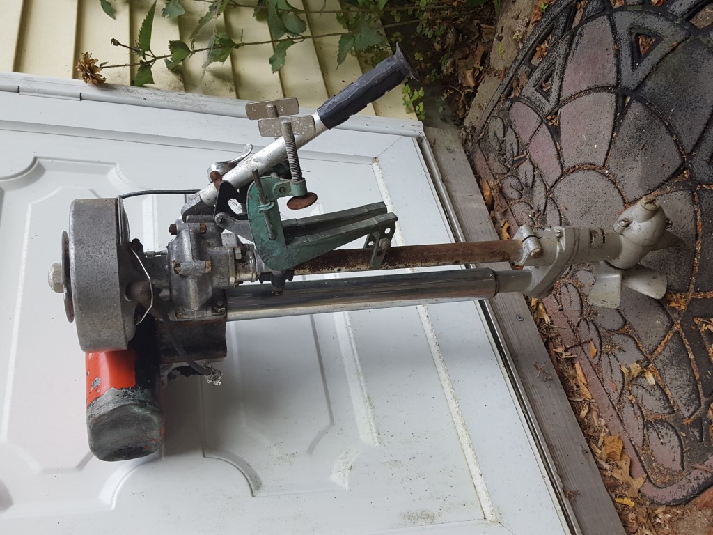

Saw this Forty Minus on Facebook Marketplace about three weeks ago but put it off for a while since I recently bought a Century 100. Did I really need another one Seagull since I have two others that don’t run? Decided to bring it home last week anyway. The seller was local and was only about 20 minutes from my house.
Sorry for sideways pictures. They display properly if you click on them.
Have to go with what I have.
The serial number is SJM 50761.
There is an alphanumeric string impressed lightly on the flywheel “R82A80 9/61”. This Seagull appears to be complete and only missing the (plastic?) thrust block. The biggest problem is the motor does not turn over. Took out the spark plug and poured some Kroil inside the cylinder.

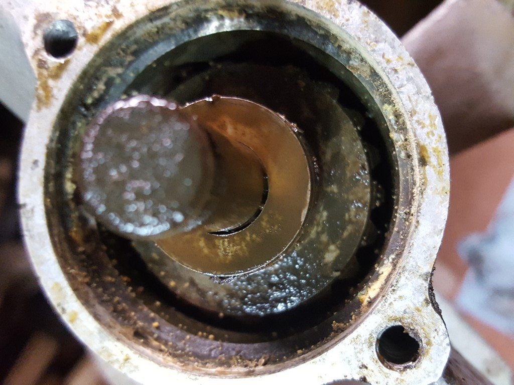

Started the disassembly from the bottom up. The two front end cap screws came off with no problem. Removing the end cap revealed an oily interior and nothing poured out like I’d expect. At least it wasn’t dry and rusty so that's good.
Gearbox looks clean
So far the gearbox is looking hopeful.

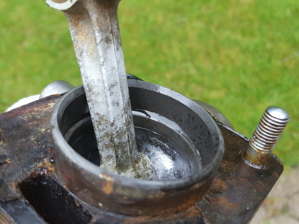

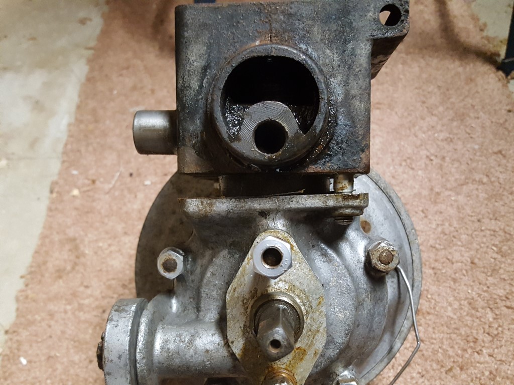

Got the drive shaft off the crankshaft and found the pinion turned but it is stiff. Poured some Kroil penetrating fluid into the drive shaft and put it aside to soak. Also removed the silencer tube to get a closer look at the piston rings.
Not looking good

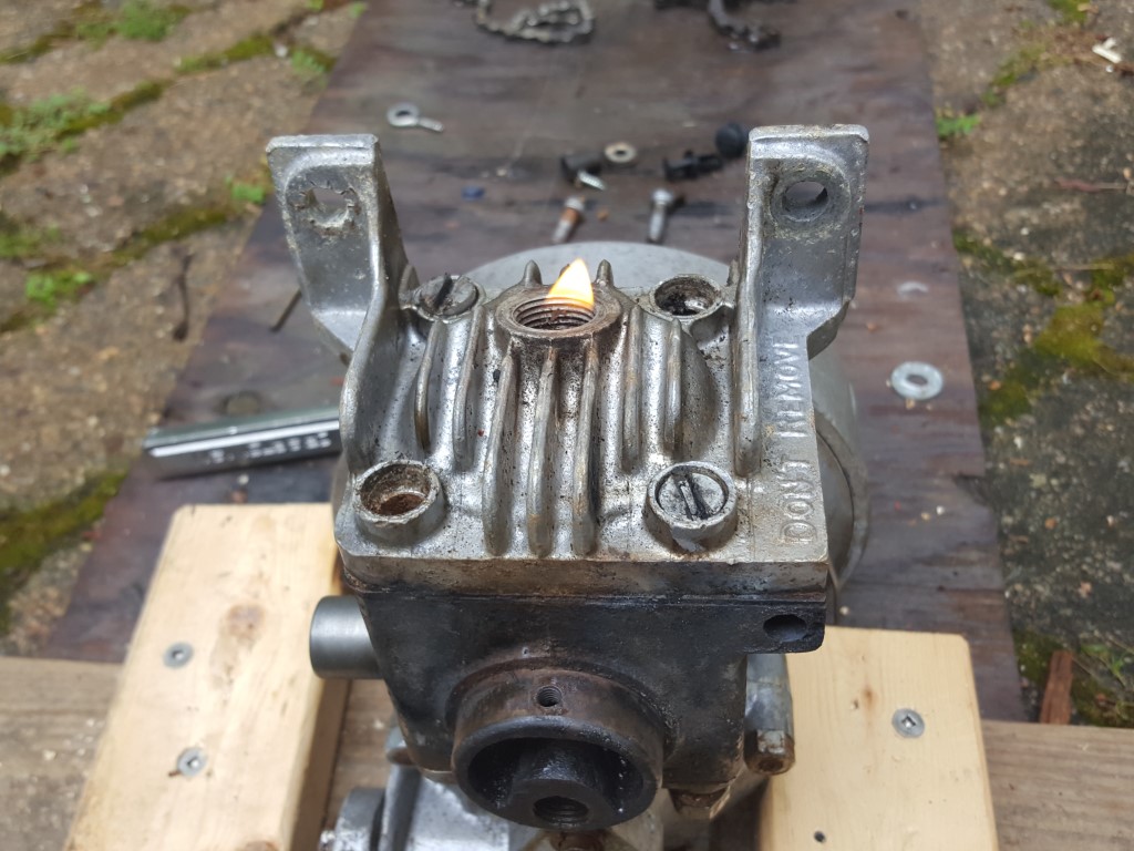

The biggest challenge now is the frozen piston. Took the time to find a large slotted head bit to fit the cheese head cylinder head screws. Used an acetylene torch to heat each screw head and the cast iron corners in the area of the screw threads. Most broke free but the most difficult was the one near the water exit.
Got the block hot enough to start a fire

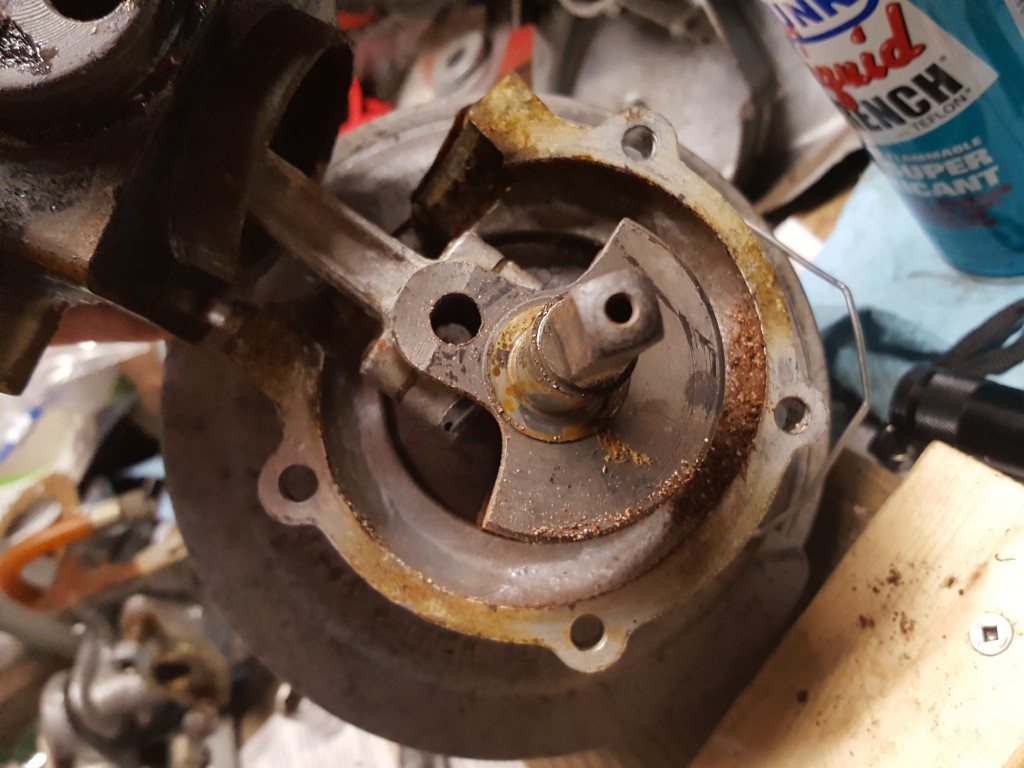

I was able to lift the block partially from the crankcase assembly.
The crank turned enough to give enough room to clear the two studs that attach the block to crankcase.
Even better
Open crankcase with access to the connecting rod screws
With the lower crankcase half open, I was able to remove the connecting rod screws. Made sure the connecting rod cap spacers were put back into their original location.
Now I have the block free and can work the piston problem without risking damage to the crankshaft. Soaking the lower cylinder in Evapo-Rust to clean out the surface rust as this will be (hopefully) the piston exit. Doubt this will be the last soak in this area. Next I'll do some scraping and more soaking.

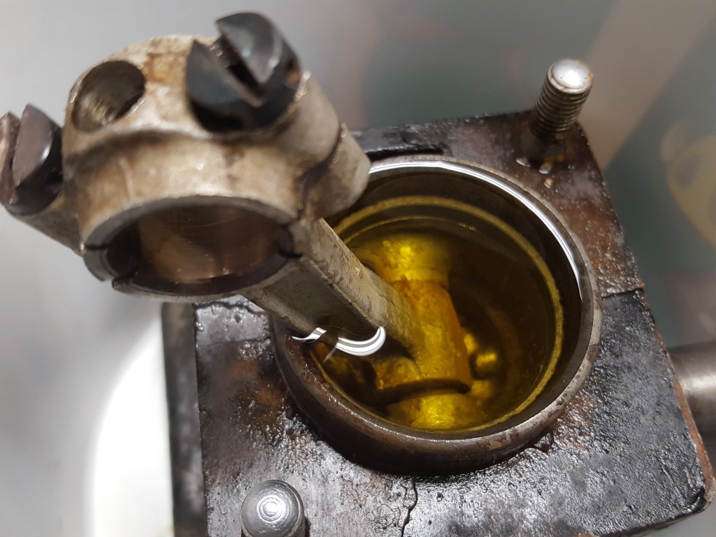

The Evapo-Rust soak worked really good. After 24 hours the cylinder walls below the piston were smooth and I only wiped the inside with a cloth. The dark spots don't feel like pits. After a water rinse, I dried as much as I could with a shop towel then sprayed it with WD-40.
Lower area of the cylinder walls after the rust has been removed.
