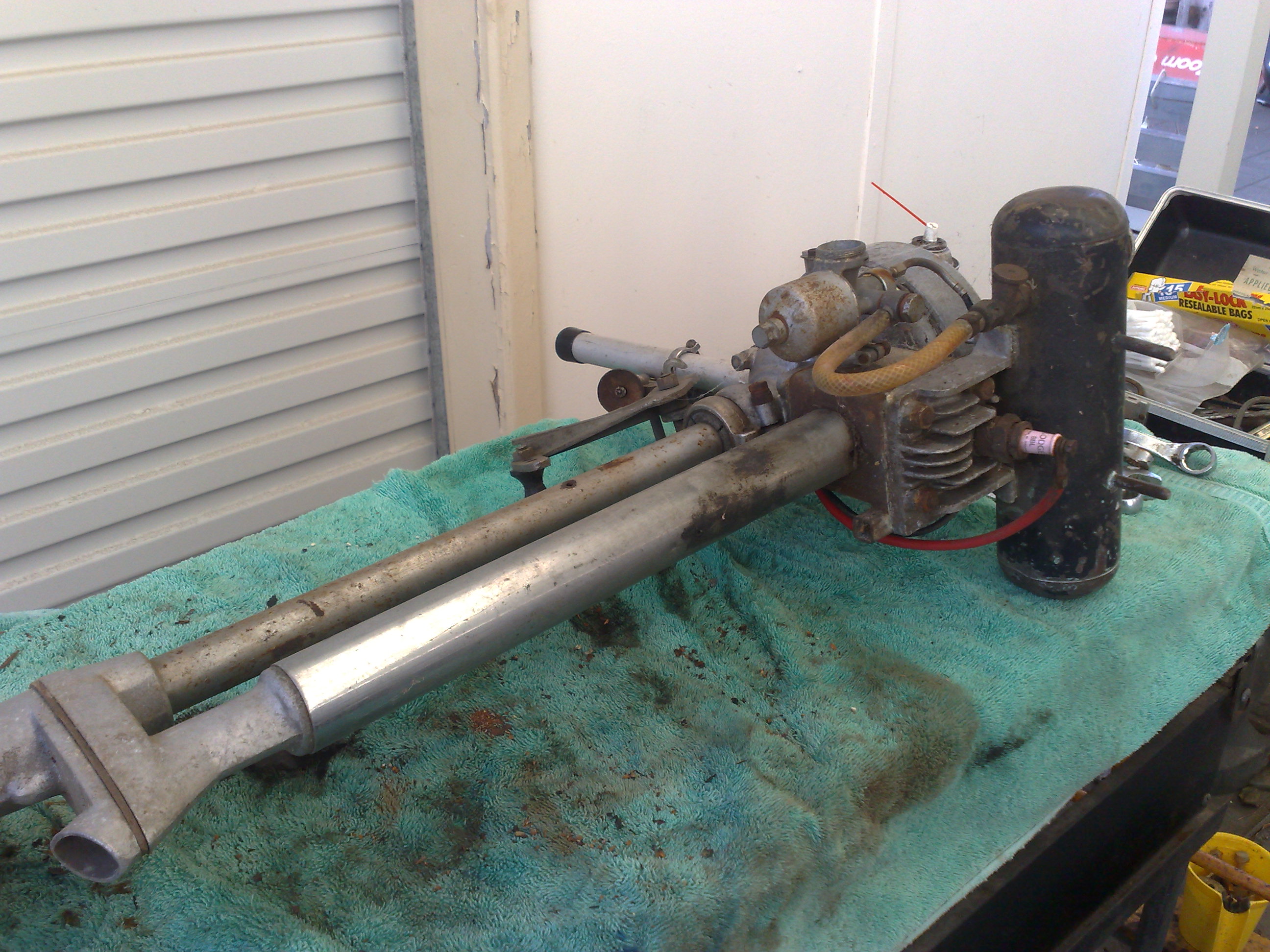

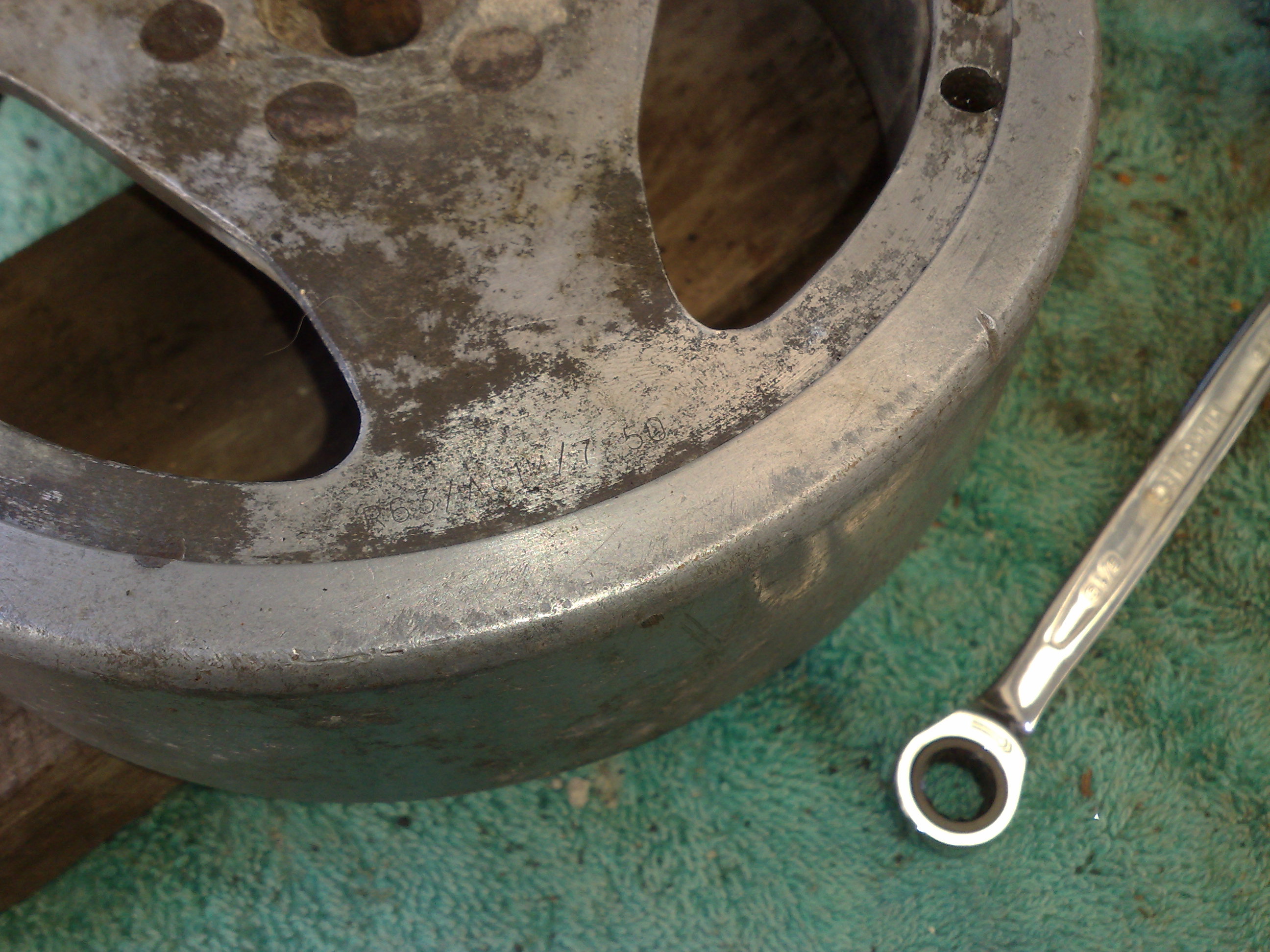

On to the operating table with it and a lovely day 20c to boot.

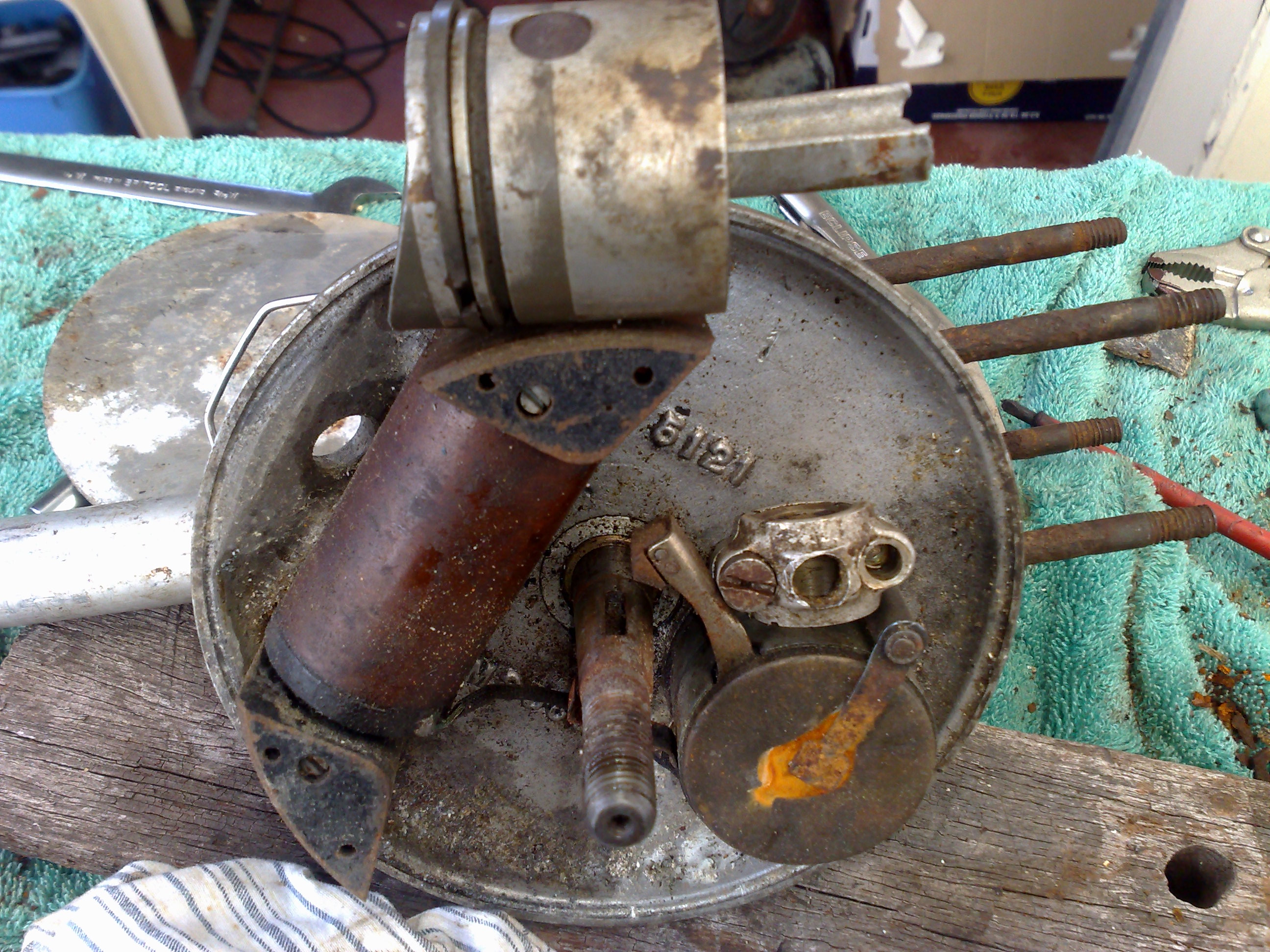

Came apart with no real fuss but what a surprise inside
Only one ring. Only one big end fastener. No key for flywheel. Missing big end bearing spacers.
And off course it broke stuff!
Head is an easy weld up.
Flywheel says 1950.
I may have a con-rod but which bloody box or drawer means while looking I will find other bits for something else along the way. That may be a plus.
ATMO I can make one from two (3302)

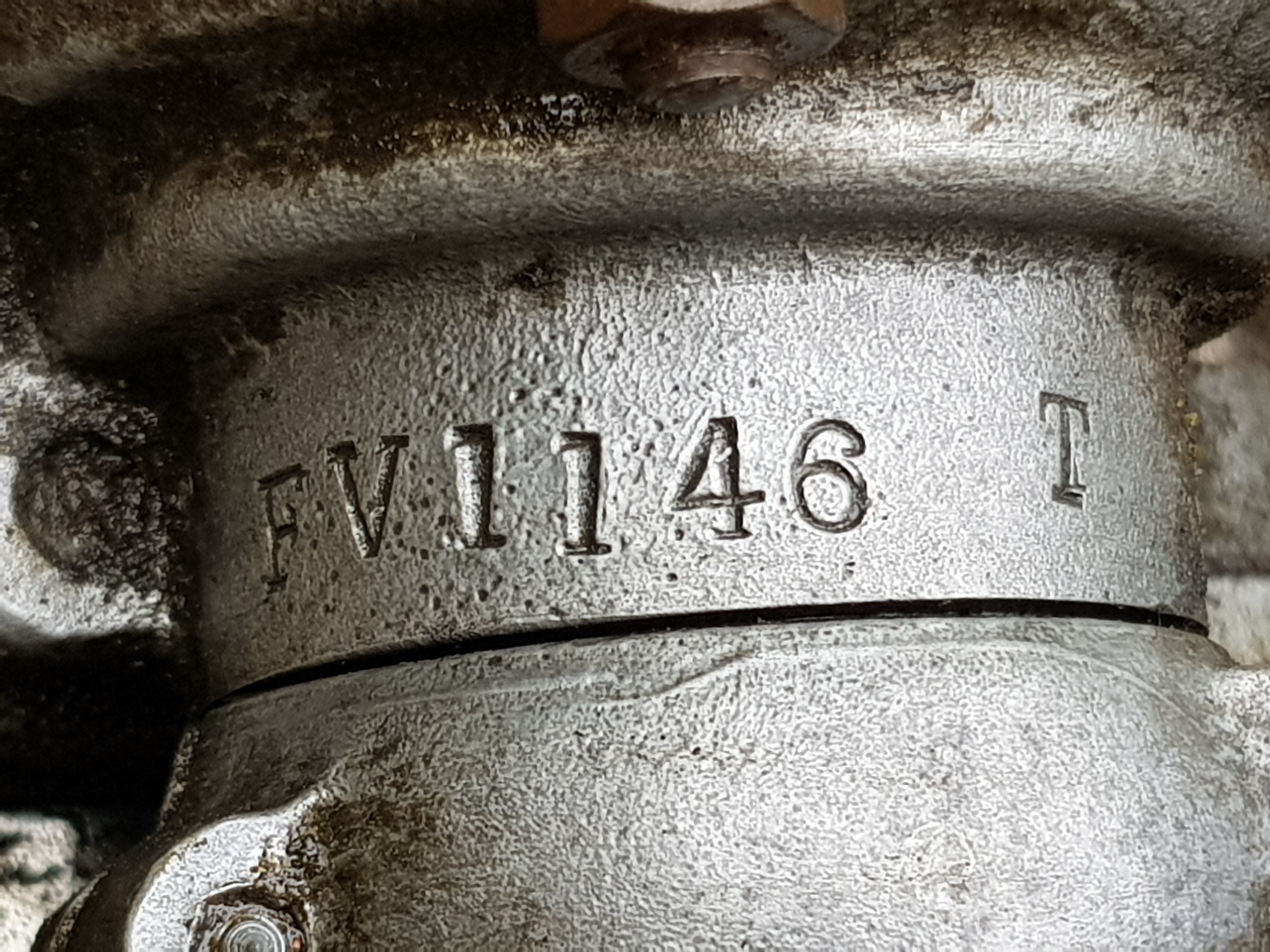

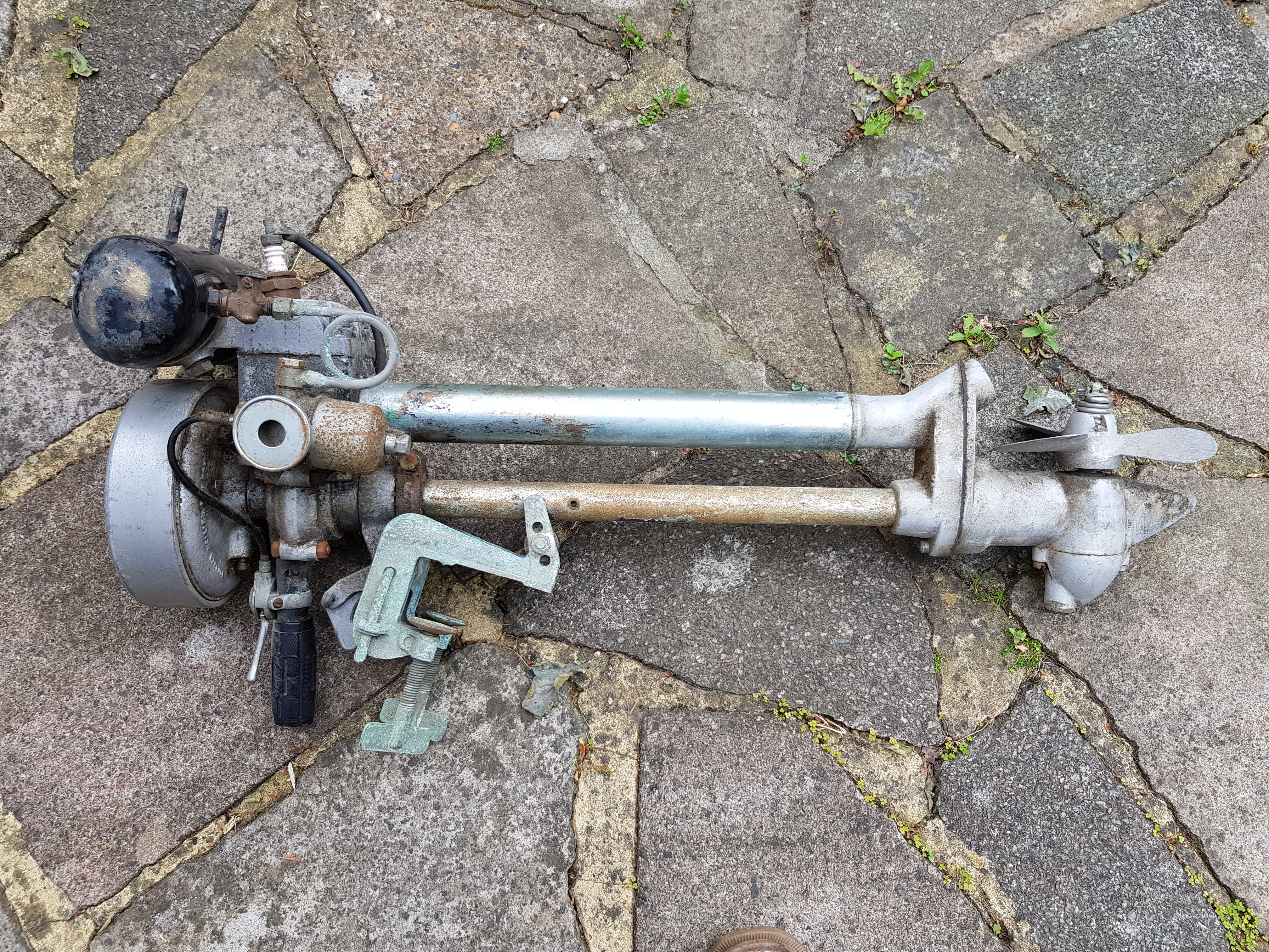

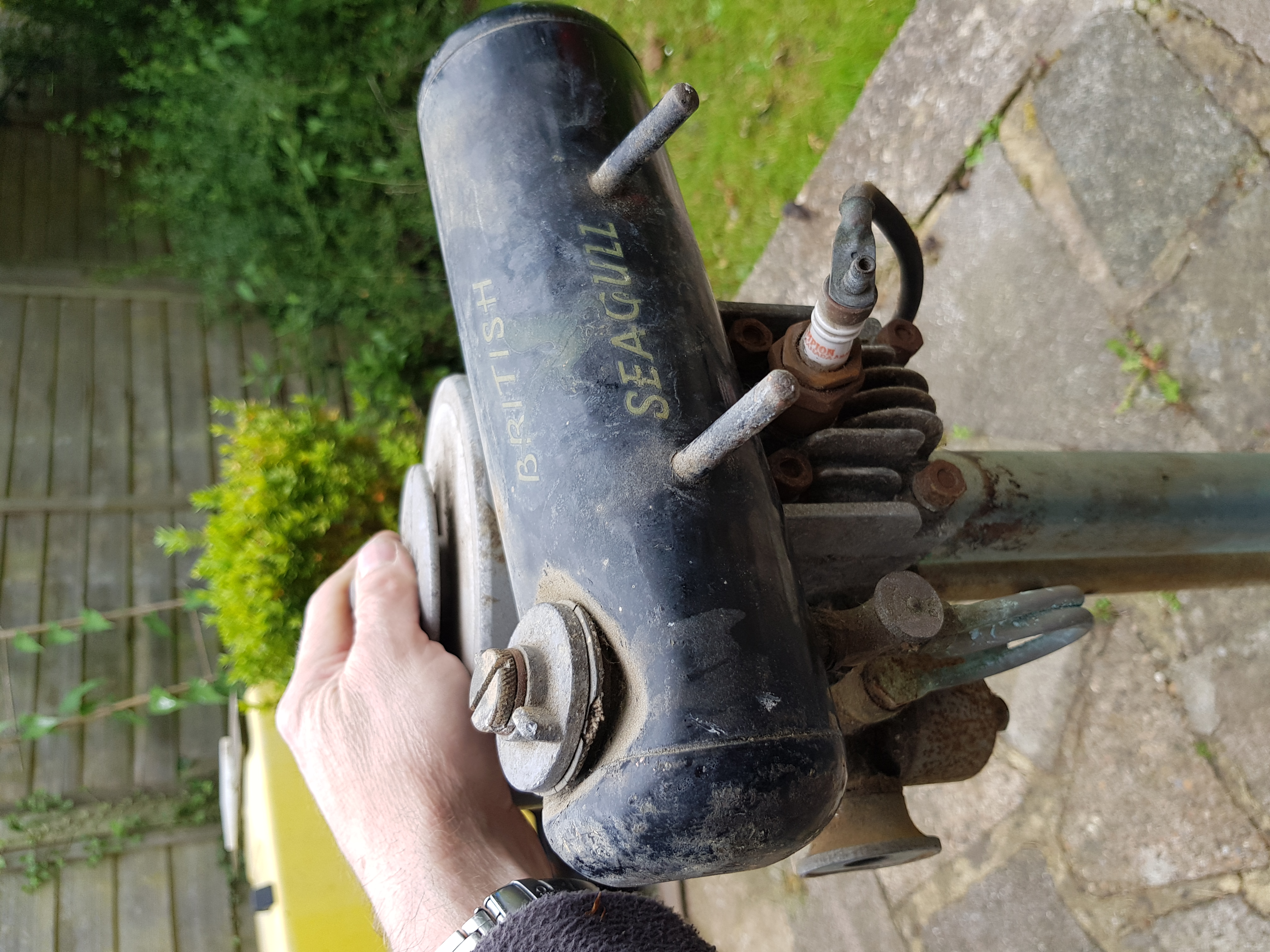

I am about to start on FV1146 Which I believe could be the earliest number FV surviving
tank is a bit bashed but decal is good so should be challenging, currently engine is seized.
