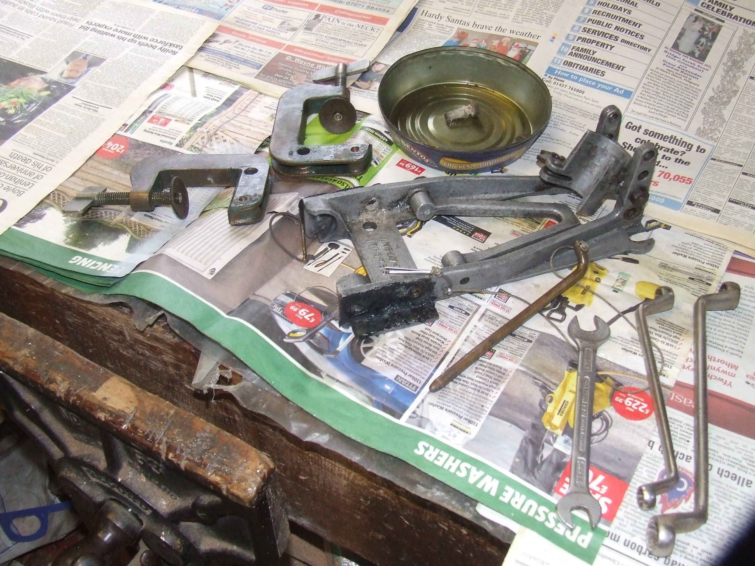

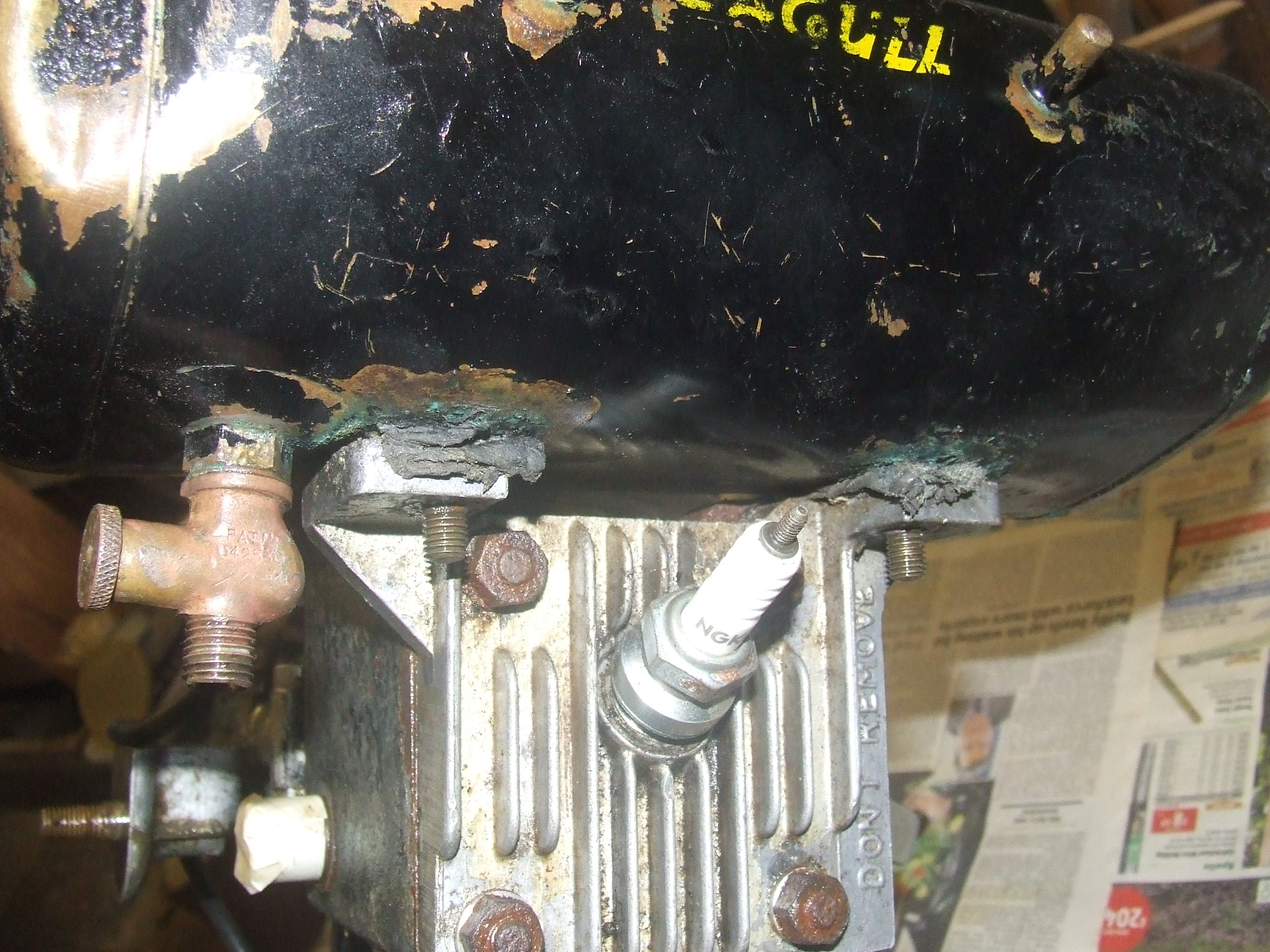

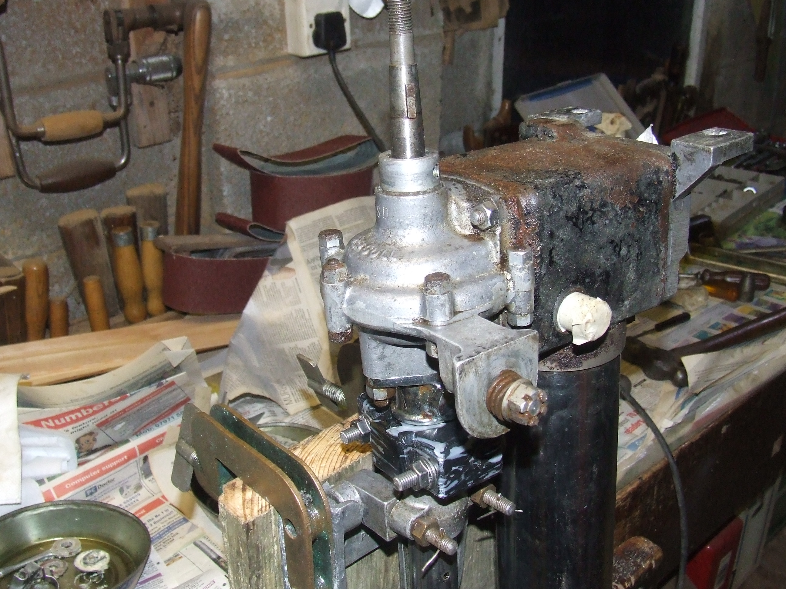

My 1956 Century runs well and I used it last year back and fore to the moorings and a couple of trips on the Haven, it seams to have been looked after but decided to strip and check things and generaly tidy it up before the spring.
For some reason a previous owner has bedded. every thing down in what looks like Sikaflex. Managed to separate the clamps from the transom bracket but the tank is another matter. Looks like the fibre pads have also been bedded in Sikaflex, will try to cut through the pads.
The HT lead fitting going into the base plate also looks to have been sealed into place!
Was expecting the usual seized parts due to corrosion but not this self inflicted problem!

Yes BnC, it would stop things from vibrating lose and also prevent dissimilar metal corrosion.
But the inability to strip things down is a big drawback, it took me most of the afternoon to get the tank off, luckily with out damage, that high pressure steam gasket is tough stuff!
Dave.
Dave.

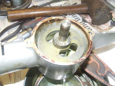

So drained and striped the gear box and found it in as new condition not a hint of corrosion.
Any one know what gasket goo was used at the factory in 1956, think it’s possible it’s never been opened before.
Everything seems to be original.
Dave.
Just a smear of the old shellac based gasket goo, the gasket is still usable. Any one know what gasket goo was used at the factory in 1956, think it’s possible it’s never been opened before.
Dave.

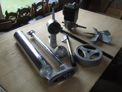

Everything cleaned up and ready to asemble.
Dave.

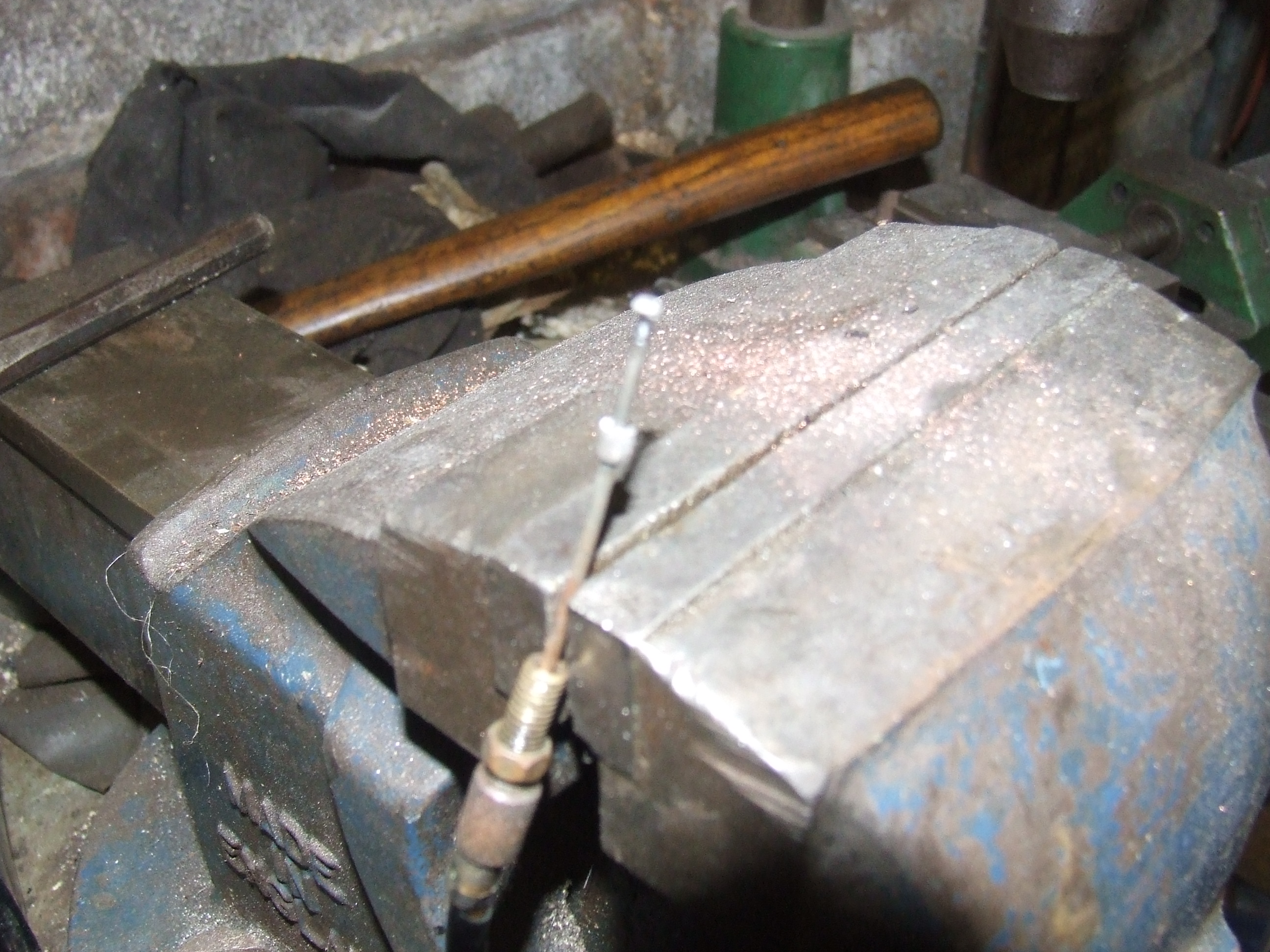

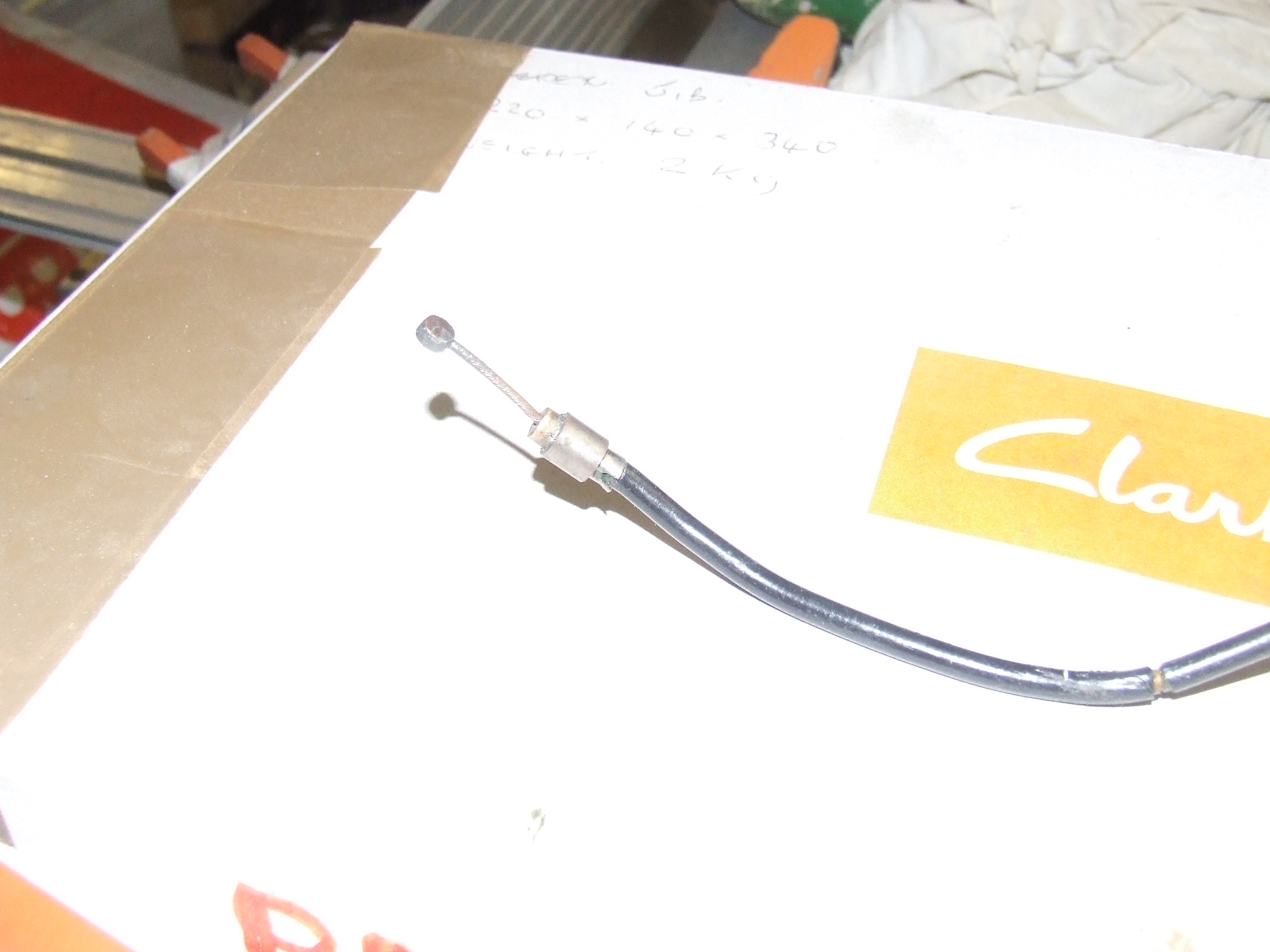

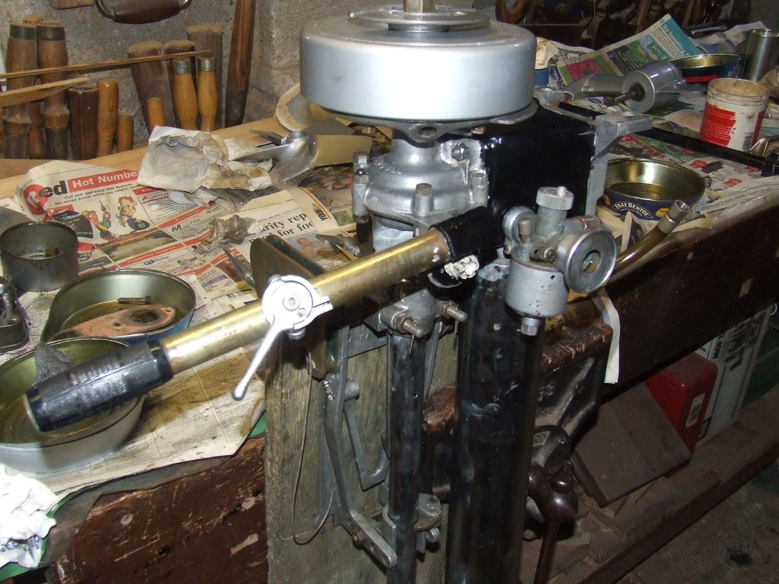

With most of it back together it’s time to make a new Throttle Cable.
Tiller, Lever and carb fitted so I can measure the outer cable.
The old cable is crippled and the outer is starting to split up.

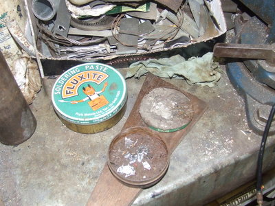

Time to find the old Flux with the solder in the lid.

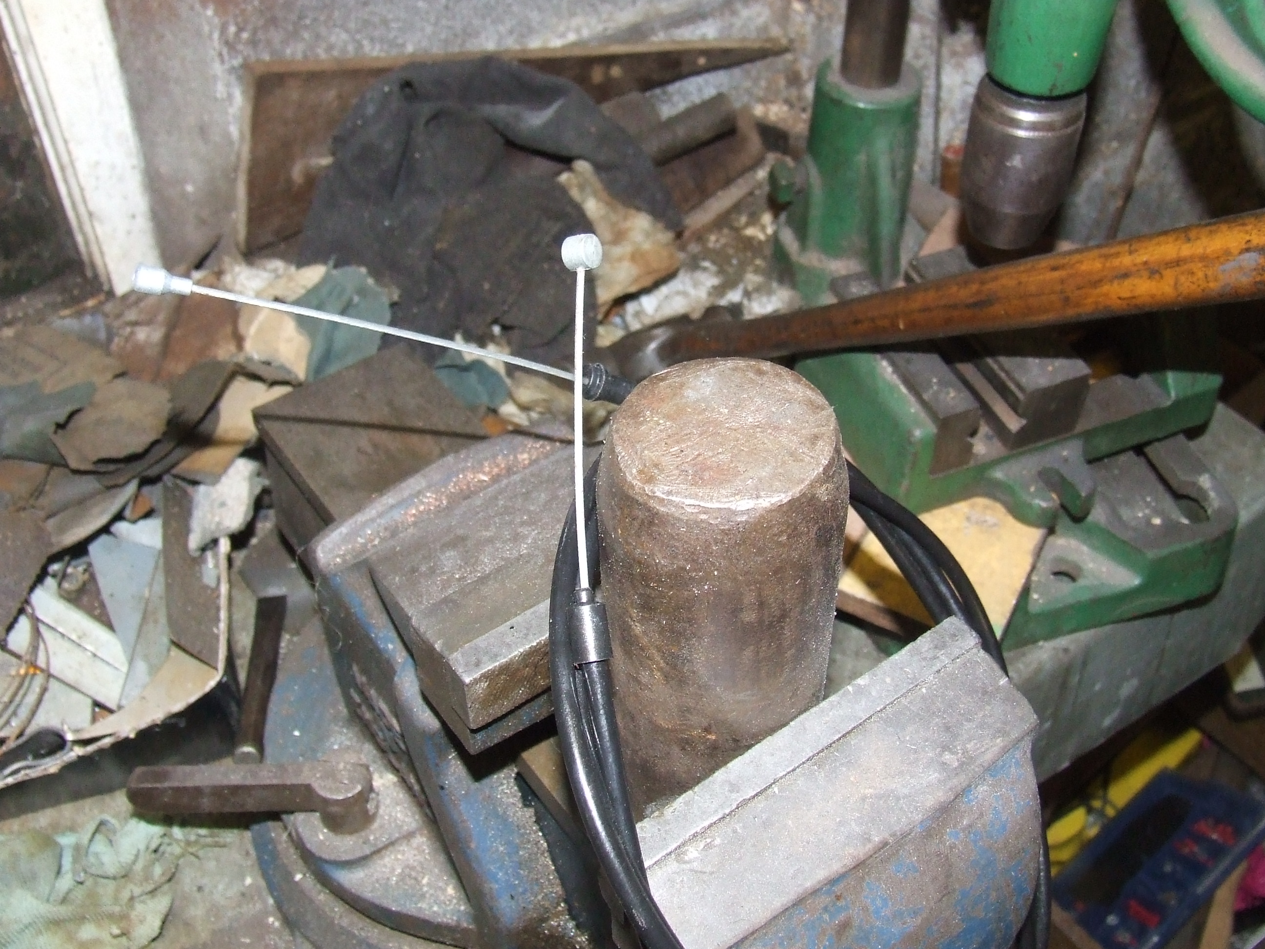

Using a bit of shaft as an anvil I’ll use a cold-chisel to cut the ends off this bike cable and cut the outer to length.
The nipples on the old cable will drop down the inner when heated with a large soldering iron, they can not be pulled off because the wire will have been flared out at the top of the nipple. Once both nipples are lose the wire can be cut and the nipple removed.
