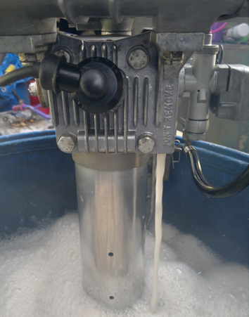

This is my 1974 Century, I have not used it for about five years and after some cosmetics I started it today.
The water flow to start was slow, I stopped the motor, then used a high pressure air line on the water exit on the block, lots of bubbles later I restarted and the water flowed as normal.

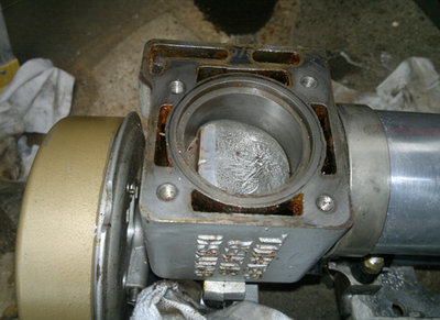

This is an example that has had little use.
Clean waterways look like this

Thanks, and very nice too!Horsley-Anarak wrote:This is an example that has had little use.
