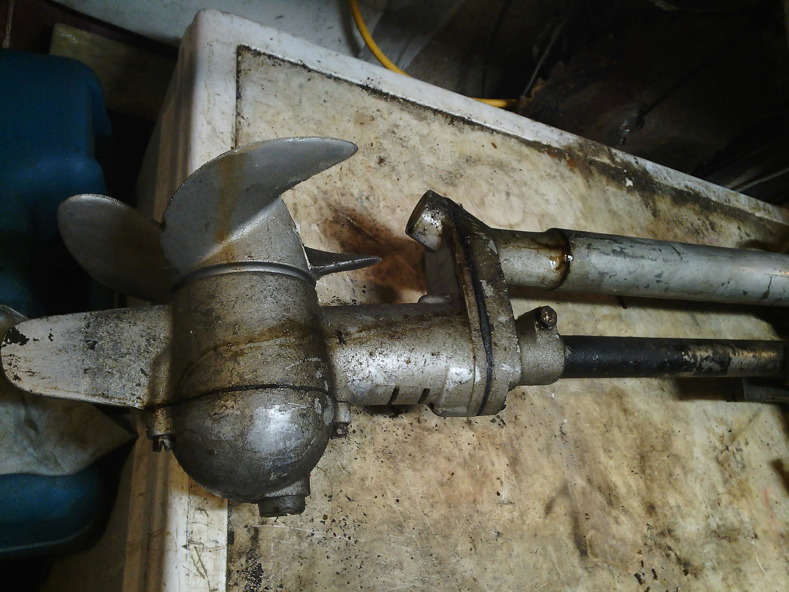

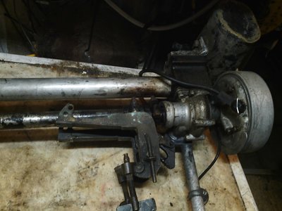

Recently purchased little forty

The prop doesn't look like its spent much time on Swannay or Harray.
I have a little forty and they are nice motors

John,
Thanks for posting the photos. I have added some of the details visible in the photos onto the List.
What do you plan to do with it? I am sure that you are aware that it has been 'modernised' with some later parts, but nice to see another LS around.

Hi Jeremy
I'm pretty sure the prop isn't original , what other parts shouldn't be on it ?
I think I emailed you more photos

John,
I am reluctant to say what shouldn't be on it, as you ( or in this case the previous owner) can put whatever parts on it that you want.
If however you want to return it to its original specification, then the following parts will need removing:-
1. Gearbox. It should be an earlier polished version with round inlet holes. Probably with 3 inlet holes.
2. Pump housing. it should again be an earlier one with the clamp bolt on the forward side of the casting.
3. Tiller. This should be a 10" brass one.
4. Throttle lever. This should be the earlier long lever type. I cannot comment on the carb, but quite often when a later throttle lever is fitted, a later carb is also fitted. The original would have had a 7/16" venturi. The later are often 1/2".
5. Tilt hook. This looks like a black plastic one, whereas originally it would have been aluminium.
6.Transom bracket. I think I am right in saying that it should have the security bar on the port side and not on the starboard side.
But enjoy it in whatever spec floats your boat!

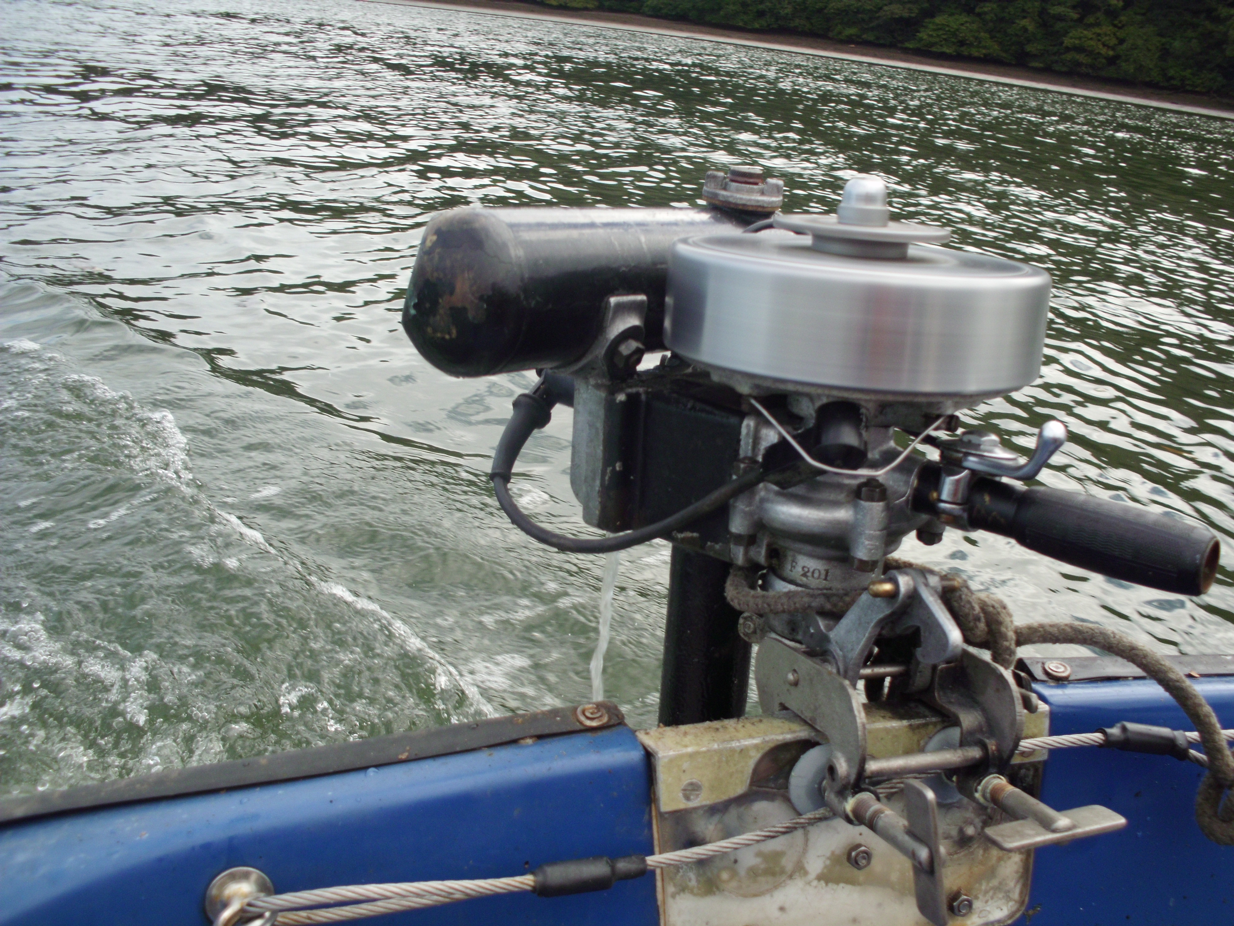

John,
You asked for a photo of a Little Model Forty. Here is F201 on the back of my dinghy in the Yealm estuary, South Devon.

Thanks for the pics , thats a different animal altogether ! I'll keep my eye open for one ! cheers
