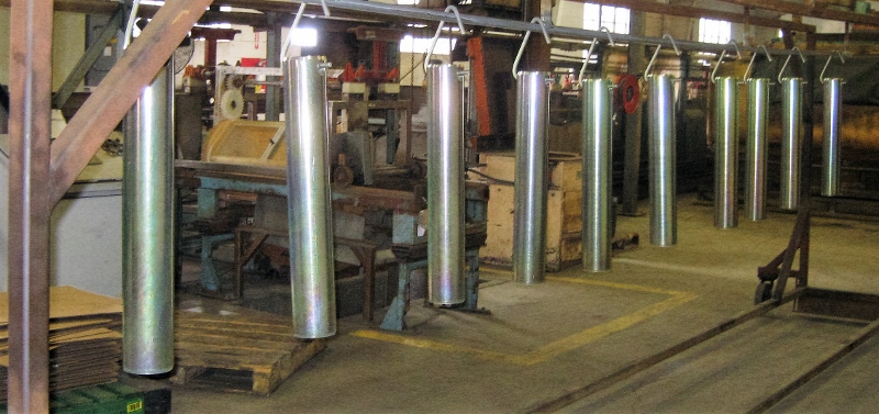

Were the holes multi purpose, at what stage of the process were the exhausts plated? Did the exhaust tube arrive in plated in full long lengths and was then cut or, did the steel arrive in bare and was then cut and plated? I don't want to derail the thread, just curious if anyone knows.
Could the holes have assisted in the plating/hooking process?
