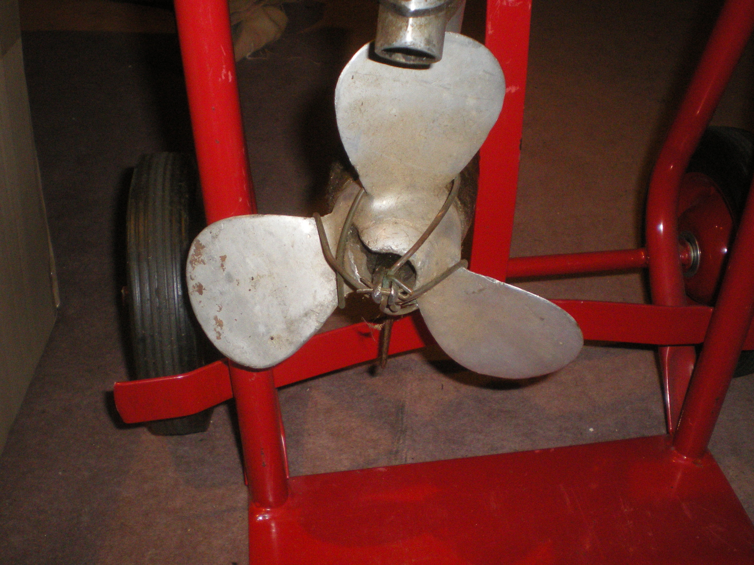

Tis older than me. Seems to be missing any decent dents in the tank, not to worry easy fixed. Must be thicker gauge brass than later tanks.
Shear spring? Bugger that, a bit of fencing wire will do.

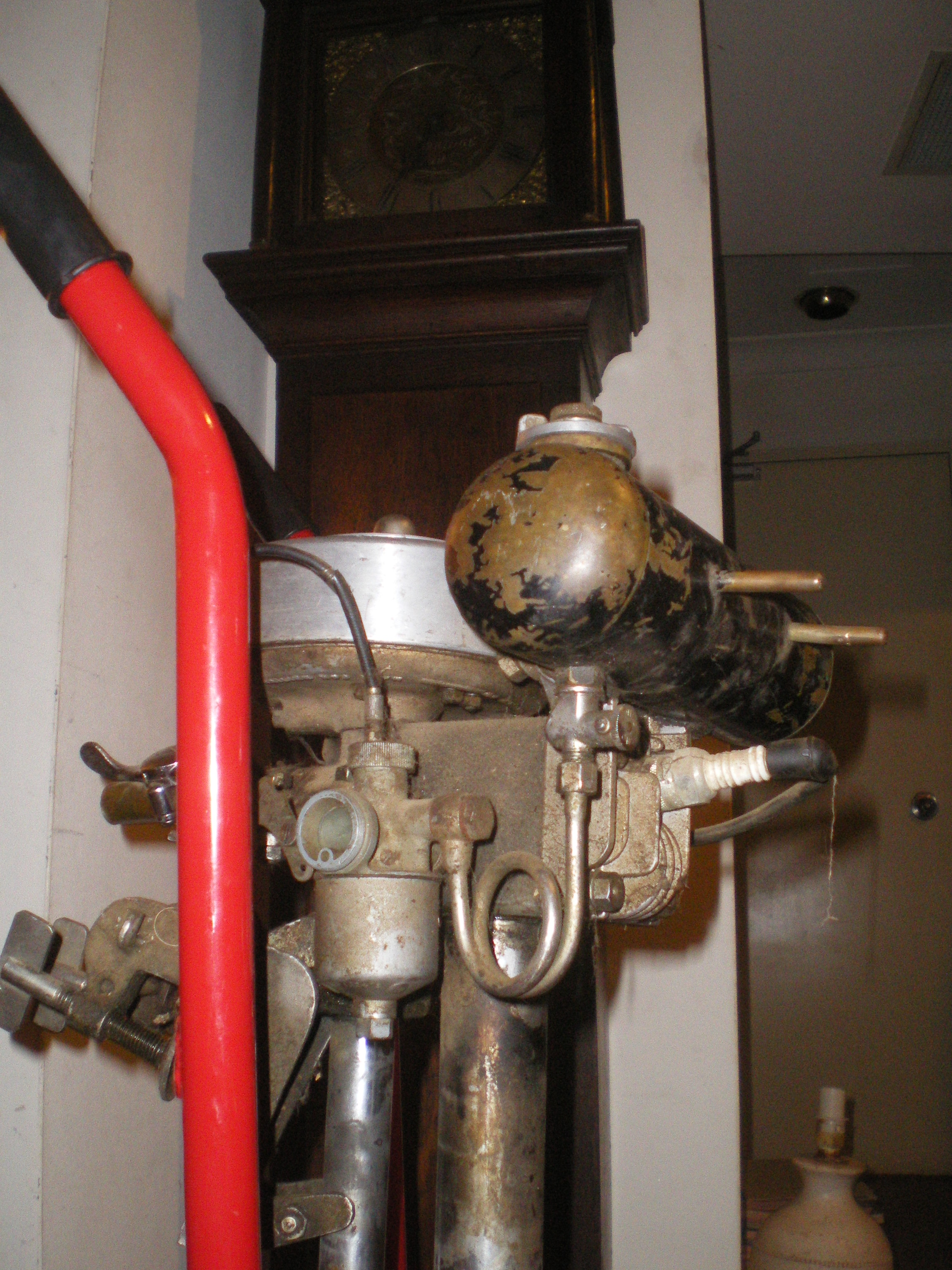

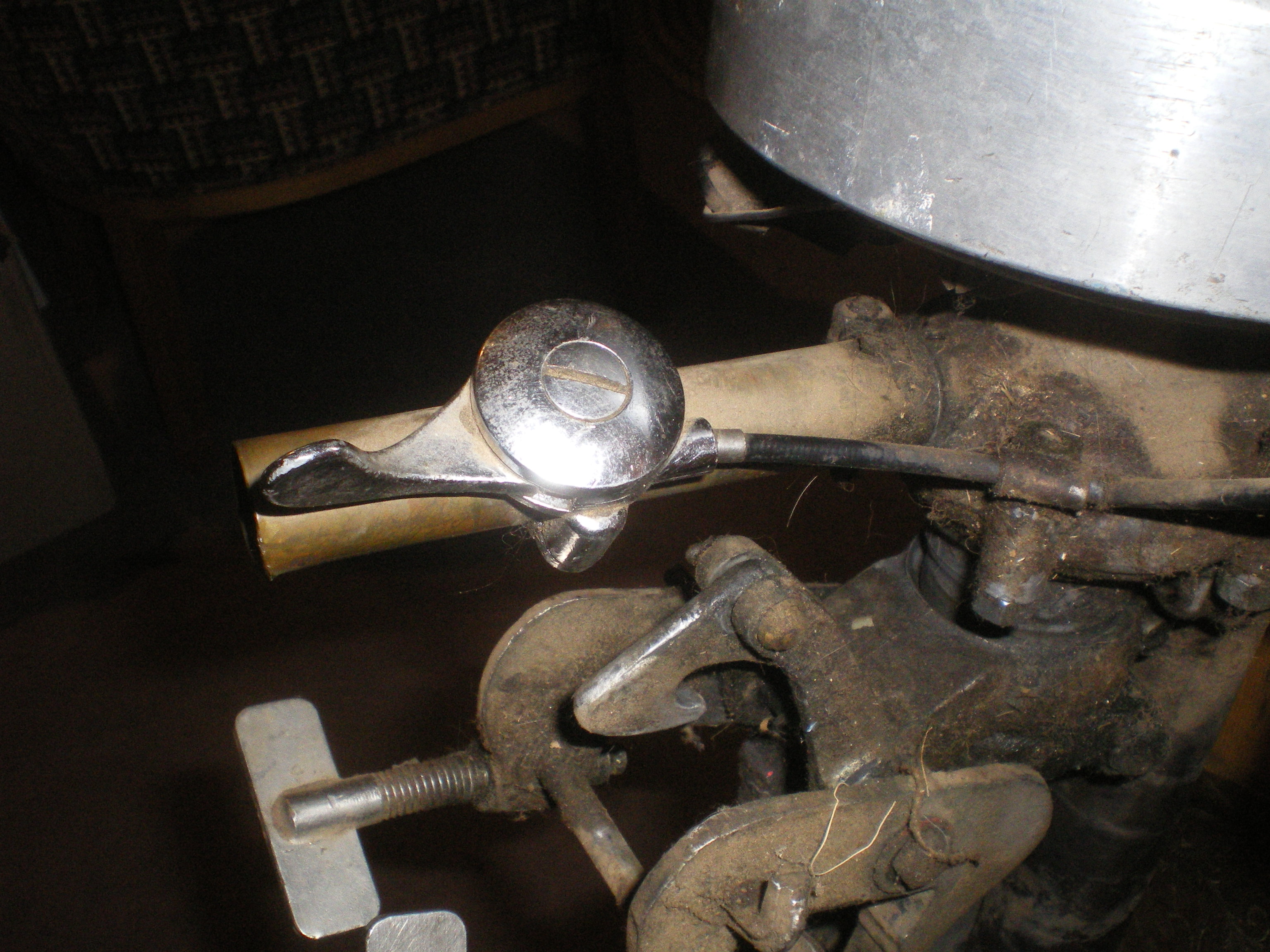

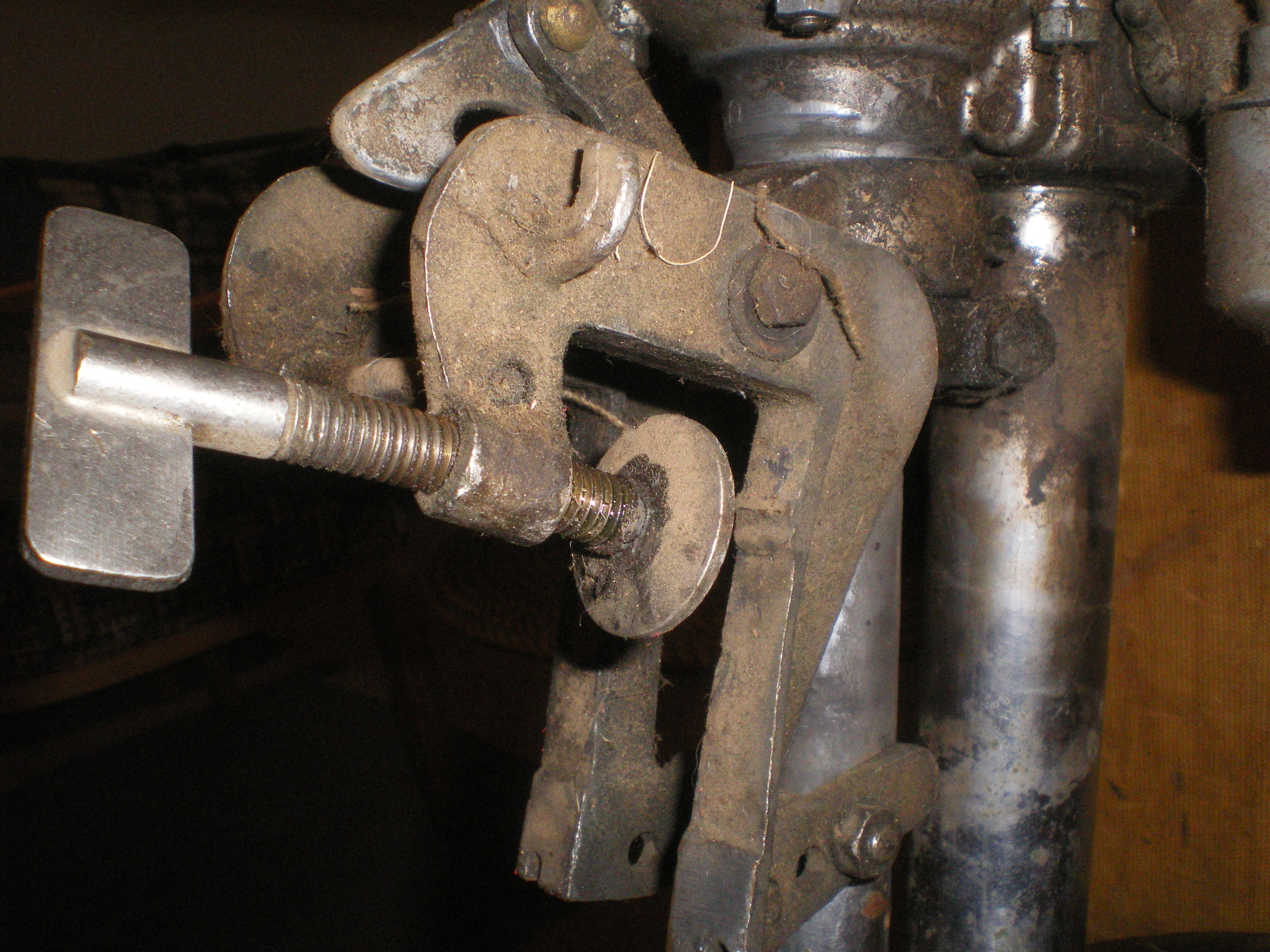

Transom bracket looks good. Requires a clamp washer, 90degree tilt pin and thrust block (cotton wheel type), availability of parts?

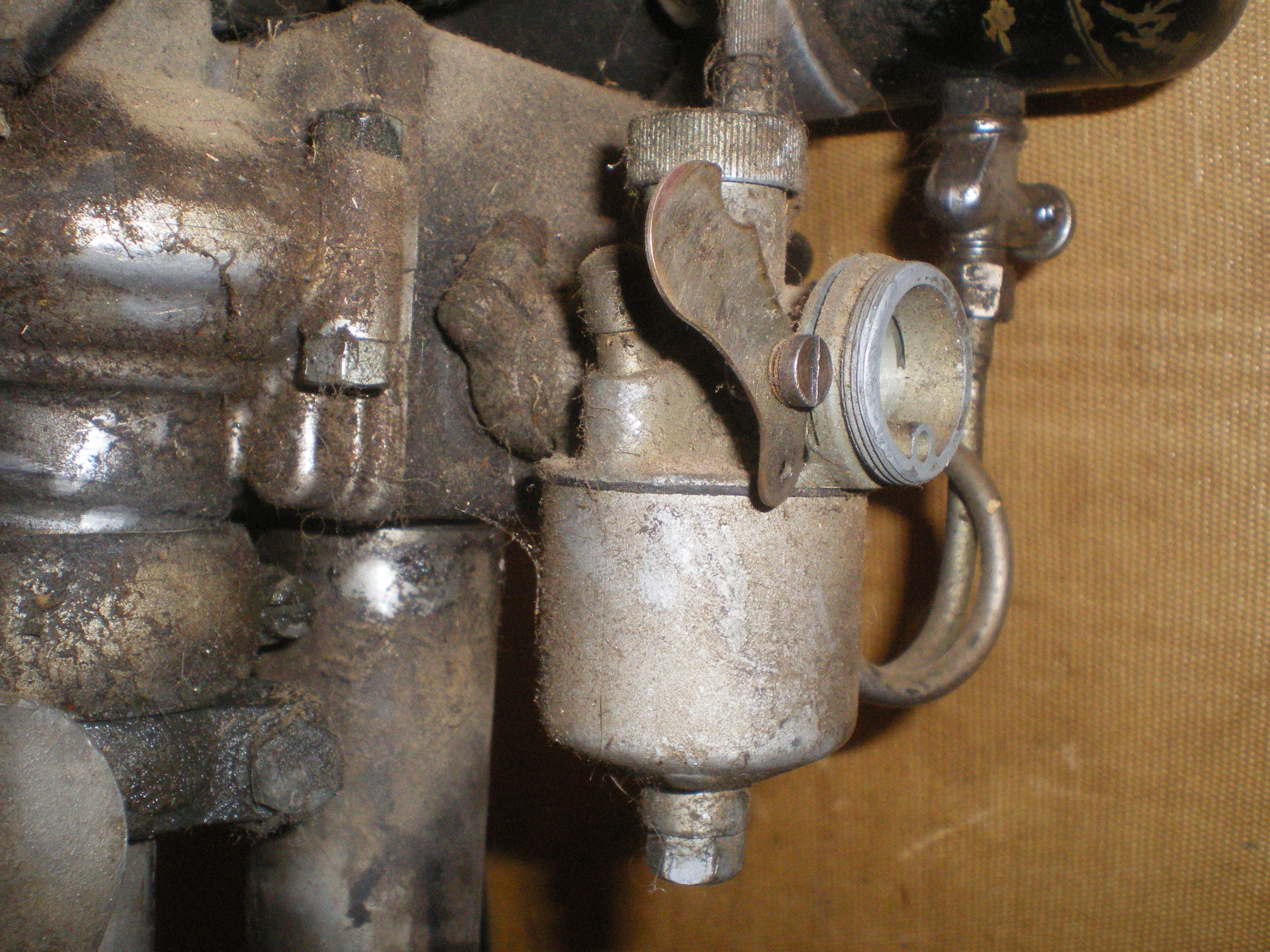

Carb inlet missing. They are a round one me thinks.
Yep, short brass tiller arm. Did they have a grip?
Slotted brass box filler cap.

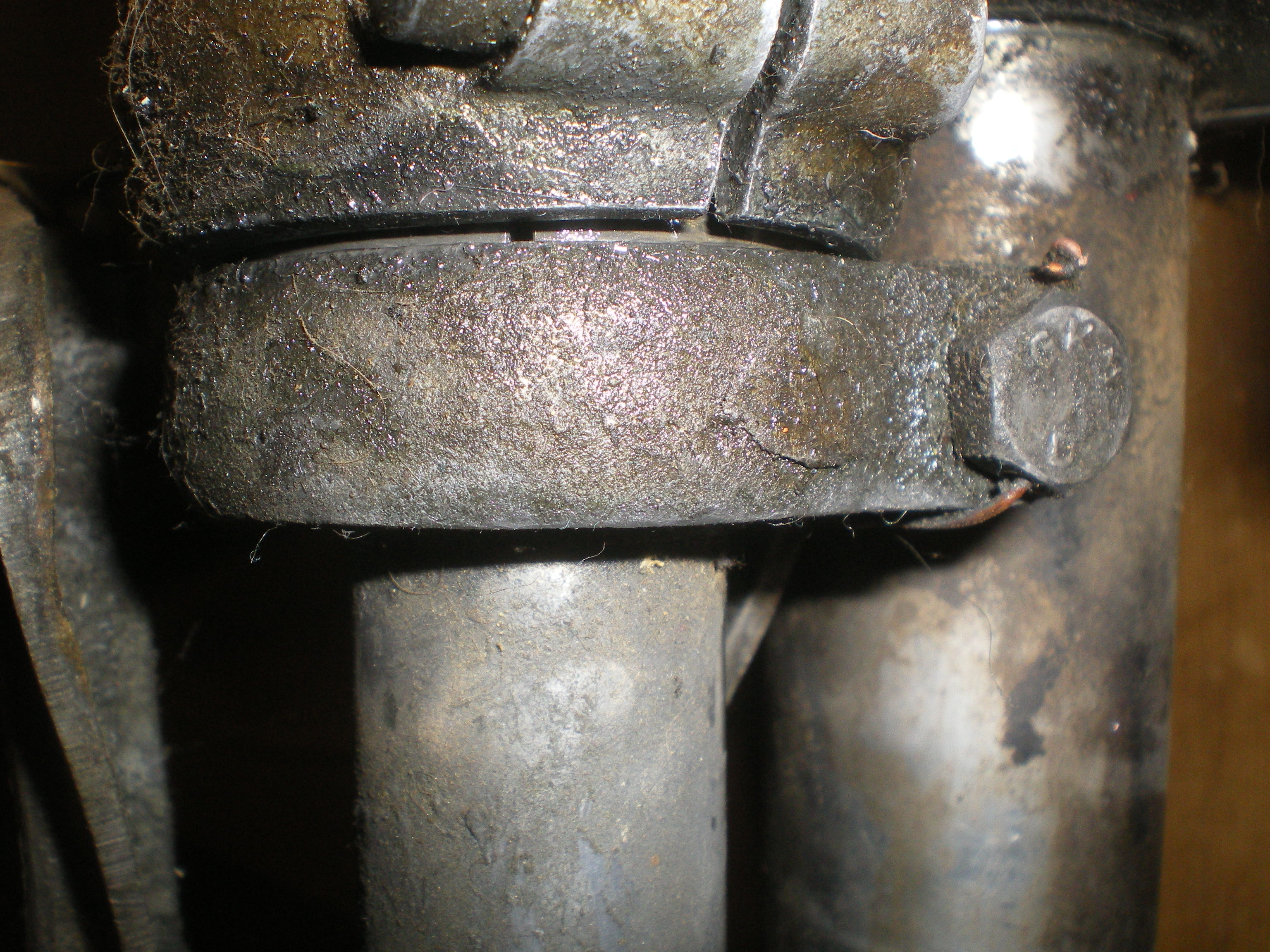

lookee here... A height adjuster with locking wire through the stud head. Is that rare for forties?
5 pics per post. Is that more than the last server?

Hi Hugz,
You have a good one there.
Yes, it should have a 'cotton reel' thrust block. There are plenty around, but if you get stuck, I have got a spare. These small 4" plated transom brackets were just used on FV/FVPs. The security bar (at least on early ones) was a plated (nickel?) brass one with a flattened end.
It isn''t a height adjuster. The clamp ring stops the leg falling off! Although by now it will be probably difficult to pull out when the clamp ring is loose. The locking wire was i think, apart from its usual function, to discourage owners from undoing it it in order to loosen the steering friction. This should be done by undoing the screw above it. The effect of loosening the clamp ring when on a dinghy might be surprising!!
The stub tillers on the FV/FVP should be about 5" long and fitted with a 'Dover' grip. The throttle lever should be one of the long spindle Villiers. I am never sure whether Villiers or BS bent them up slightly or whether it was subsequent owners.
The carb, as you indicate, should have an inlet. I can see that the throttle shutter doesn't have an air hole. This is correct. The bowl probably won't have the later drain hole near the top. It should have a throttle stop on the top cover.

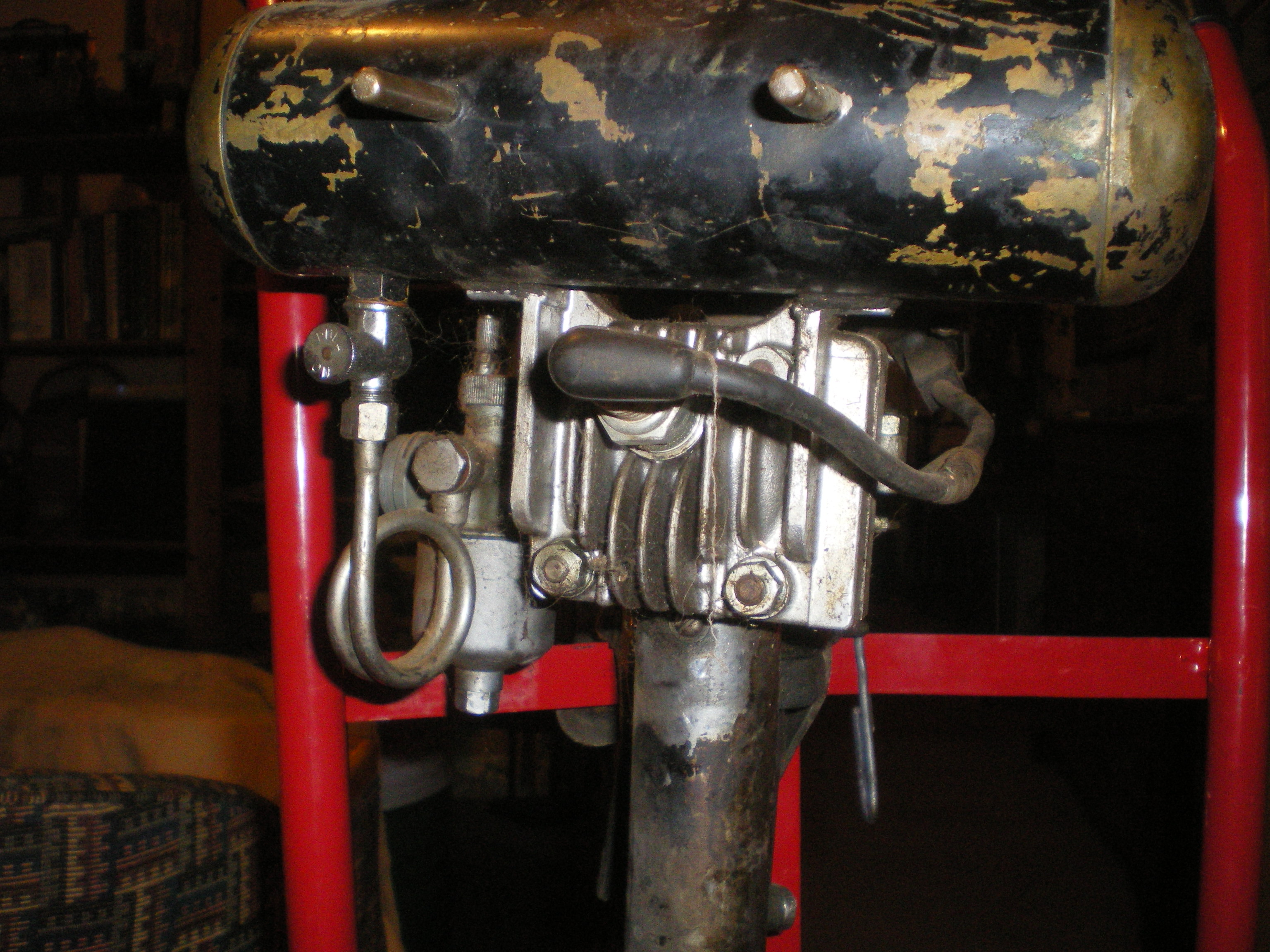

The looped fuel pipe looks in good order and is correct for this FVP. Later on they were changed to a simple 'U' shape.
Well done for getting this nice FVP.

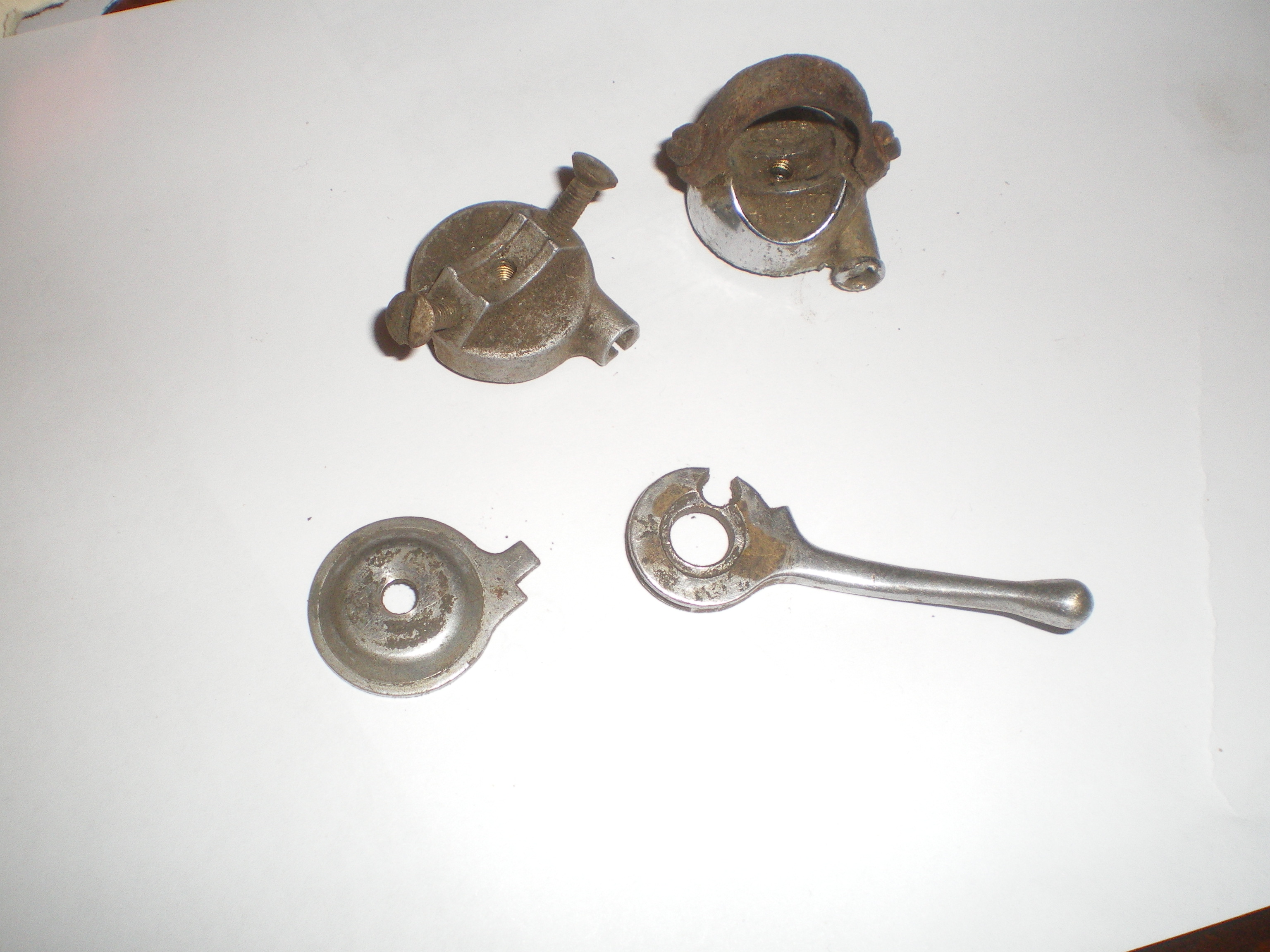

Oh goody... dont you love it when you buy a box of bits and years later you find the bit you want. Ok, anyone prepared to pull their FVP throttle apart to see what I'm missing apart from the spring? I'm thinking a washer or two and the shape of the middle fastener.
