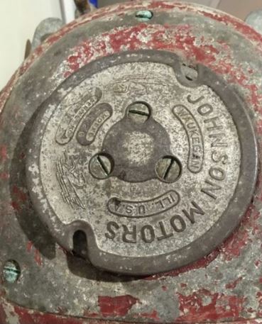

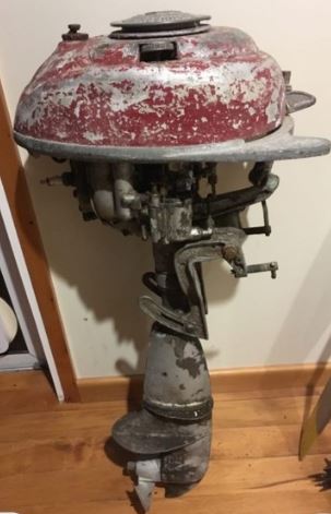

I got me another outboard! :roll:

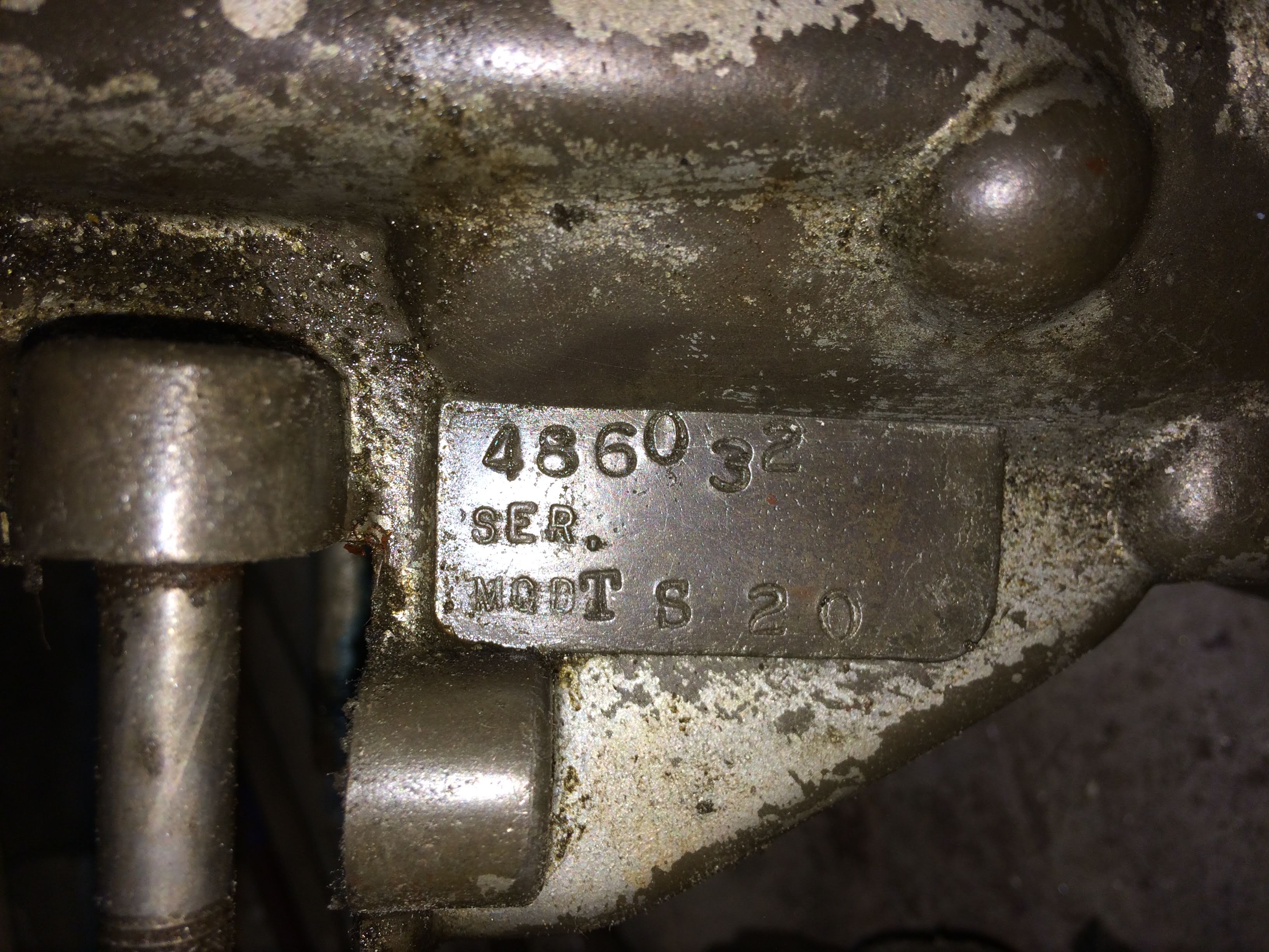

As far as I know it is 1946, I don't know a lot about it yet...Other than it is seized! twin cylinder and I think it's 5hp
The prop is the strangest I have ever seen!
It looks like it has hit the ground and rolled up (I don't think that is the case!)
Anyone got any info about them (I think the TD 20 is almost the same) Paper work, anything!

You have a genuine war bride. Your motor serial number is American and comes up during a period of the war years when records are sparse. Serial numbers 460783-491736 were produced from 1943-45. During this period outboard production was only for the war effort and not available to private citizens. Since your S/N is close to the end I would assume you have a 1945. The difference between the TS and the TD is the recoil starter. The D is for deluxe. It is missing the lower cowl. This is an extremely common antique outboard in the US and Canada. Spares will not be expensive, but shipping may be an issue. PM me your email address and I’ll send you some literature.
The T series began life in 1937 with the introduction of the 4.2 hp L series. Horsepower was boosted to 5 hp in 1940 before getting the-redesign that is the T series. They are a very good outboard. The dial on top of the motor is the high speed jet and primer plunger. The primer seal is leather and must be in working order to run properly. What’s interesting about this motor is that it actually has two carburetors. The second “carb” is actually a mixing valve that adjusts air flow for the idle circuit. The literature i’ll send you will explain things.

It is a very interesting looking carb/ motor setup with all of the copper pipes going everywhere. The pipe from the Y fitting at the front of the engine will need one of its fittings replacing (the pipe is a bit loose and the fitting has been rounded off)
I have got most of it freed up ,the tilt is still very stiff and the bolt wont budge! (and I don't want to use a a big hammer or heat unless there is no other way) So far I have been putting WD40 on it every day (I will have another look at it tomorrow if I get time.
