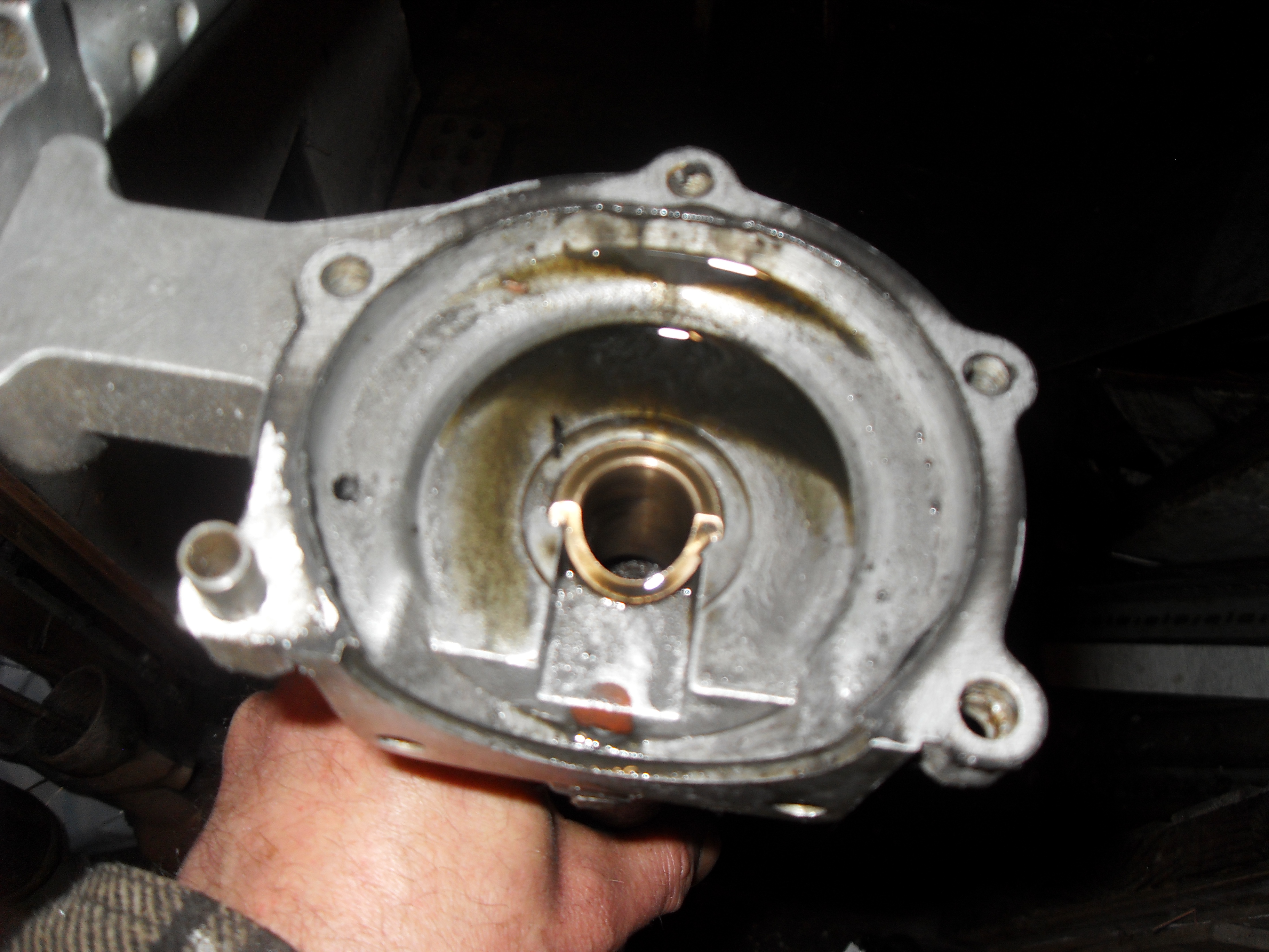

Well, it's stripped down again and.....well it's very oily in the bottom case,so much so that it's what i would call excessively oiled! (too much crankcase pressure perhaps) Total running time for this motor so far has been 5 mins. to give you some idea. (pics below)
Also just by looking at the joint face of the cases to cylinder base it's definitely not square at all (as you said loading the crank on one side) and the crank shows "shiny" spots with a slight hue of blueing! (something somewhere causing either friction and/or heat build up through the bushes)
No matter, i'm starting again from scratch using a stock pair of cases from a WSPC which i reckon will be of similar age to the cylinder i'm using.
I did pay particular attention to make sure everything on the crank/rod was in it's correct place so i'm confident that nothing is amiss here.
IF, later on i find that the crank is slightly bent somewhere, i can swap out with a choice of 5 others. No worries.

That's what you'd expect, petrol/oil particulate spray enters crankcase from carb hits the high temperature parts & the petrol evaporates leaving the oil which doesn't evaporate behind lubing the crank well, but not the upper cylinder.
