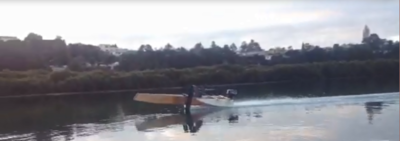

Paris Mk3 out for a test on Sunday.
She's ultra rough and a bit thrown together, but she goes well enough for a first attempt.

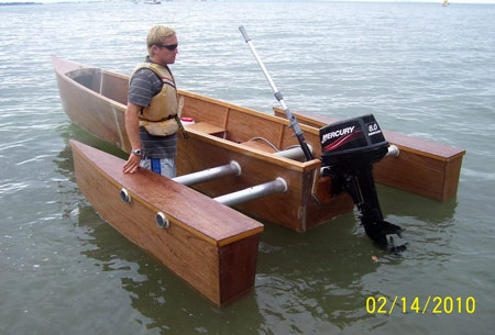

Reminds me of something else. Saw it on duckworks a few years ago.
Thought it might be worth a try but never got to it.

It should be ok. We’re only really wanting the pontoons to be in the water when the boat is stationary, so I’ll trim 100mm off the bottom before our next test. At speed, the narrow hull is plenty stable enough.

Will try for another test this weekend with the reduced pontoons. She's leaning on them quite a bit underway, which I don't want. There should be enough form stability in the main hull when she's on the plane. We have some moulds coming for new pontoons next week, so that will be a big step forward.

To the casual eye she looks heavy, could lose a lot of weight in the pontoons, after all they only need to give minimal support when stationary? also the cross members look quite massive.
