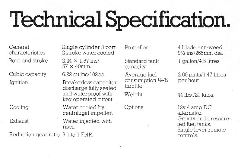

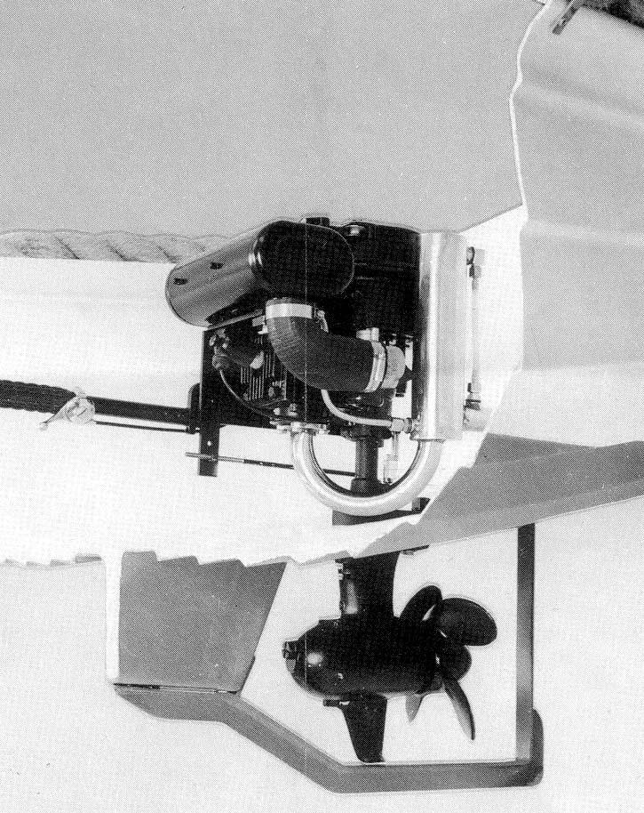

Technical Spec. - Click to enlarge  In situ Picture - Click to enlarge  Plan - Click to enlarge

The two models were the 110 and the 160.  The 110 used the common motor head from the Silver Century Plus and Model 90/110. The FNR Gearbox from the 110 was used.  (In those years it was still called the 110 outboard.)

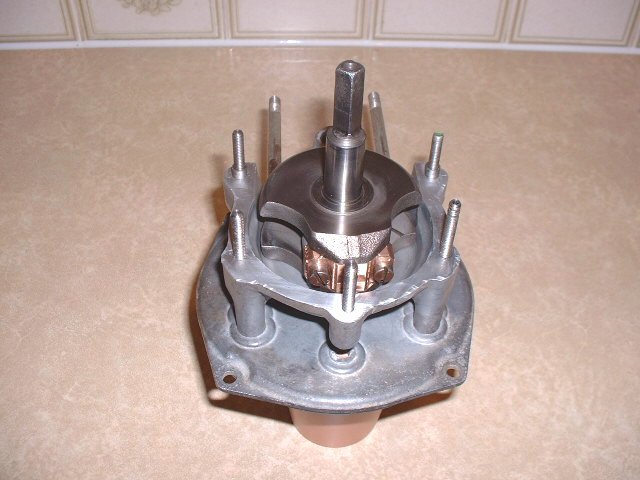

However!!  The 160 model used the ill fated 170 power head, with the problem of the weakness in the con rod, so many of these otherwise excellent little engines, have been scrapped through lack of a spare con rod.  If you have one of these 160 units, do not rev it out of gear!!
Martyn Sandbrook has sent in pics of a new con rod cap he has made from bronze.  It is hoped this will cure the problem with his inboard 160. The 160 is the same engine power unit as the 170 and 125. Photos below.
      I think you will agree the new one is a bit beefier than the old.!!  Martyn is a little concerned about engine balance, he may have to drill the flywheel to counter that.  We will see.
    More pics of the rebuild from Martyn.....
    Latest pics, looks better than new!
