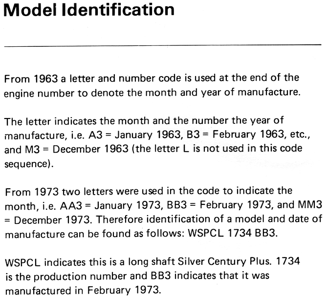

Engine - Letter Code - for Month/Year Manufactured
Model Identification - Month & Year Defined
From 1963 a letter and number code is used at the end of the engine number to denote the month and year of manufacture.
The letter indicates the month and the number the year of manufacture, i.e. A3 = January 1963, B3 = February 1963, etc., and M3 = December 1963 (the letter L is not used in this code sequence).
From 1973 two letters were used in the code to indicate the month, i.e. AA3 = January 1973, BB3 = February 1973, and MM3 = December 1973. Therefore identification of a model and date of manufacture can be found as follows: WSPCL 1734 BB3.
WSPCL indicates this is a long shaft Silver Century Plus. 1734 is the production number and BB3 indicates that it was manufactured in February 1973.

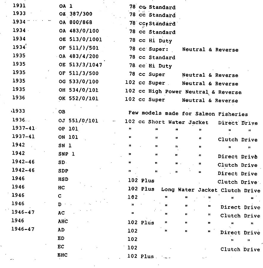

Engine - Letter Code - for Early Models, including the Marston Seagulls.
Year Manufactured |
Engine Lettering Code |
Engine No. |
Engine Size (cc) /Name |
Series |
| 1931 | OA | 1 | 78 | Standard |
| 1933 | OA | 387/300? | 78 | Standard |
| 1934 | OA | 800/868? | 78 | Standard |
| 1934 | OA | 483/0/200 | 78 | Standard |
| 1934 | OE | 513/0/1001 | 78 | Hi Duty |
| 1934 | OF | 511/0/501 | 78 | Super: Neutral & Reverse |
| 1935 | OA | 483/4/200 | 78 | Standard |
| 1935 | OE | 513/3/1047 | 78 | Hi Duty |
| 1935 | OF | 511/3/500 | 78 | Super: Neutral & Reverse |
| 1935 | OG | 533/0/100 | 102 | Super: Neutral & Reverse |
| 1935 | OH | 534/0/101 | 102 | High Power: Neutral & Reverse |
| 1936 | OK | 552/0/101 | 102 | Super: Neutral & Reverse |
| 1933 | OB | Few models made for Salmon Fisheries | ||
| 1936 | OJ | 551/0/101 | 102 | Short Water Jacket - Direct Drive |
| 1937-41 | OP | 101 | 102 | Short Water Jacket - Direct Drive |
| 1937-41 | ON | 101 | 102 | Short Water Jacket - Clutch Drive |
| 1942 | SN | 1 | 102 | Short Water Jacket - Clutch Drive |
| 1942 | SNP | 1 | 102 | Short Water Jacket - Direct Drive |
| 1942-46 | SD | 102 | Short Water Jacket - Clutch Drive | |
| 1942-46 | SDP | 102 | Short Water Jacket - Direct Drive | |
| 1946 | HSD | 102 Plus | Short Water Jacket - Clutch Drive | |
| 1946 | HC | 102 Plus | Long Water Jacket - Clutch Drive | |
| 1946 | C | 102 | Long Water Jacket - Clutch Drive | |
| 1946 | D | 102 | Long Water Jacket - Direct Drive | |
| 1946-47 | AC | 102 | Long Water Jacket - Clutch Drive | |
| 1946 | AHC | 102 Plus | Long Water Jacket - Clutch Drive | |
| 1946-47 | AD | 102 | Long Water Jacket - Direct Drive | |
| ED | 102 | Direct Drive | ||
| EC | 102 | Direct Drive | ||
| EHC | 102 Plus | Clutch Drive |
The question Marks mean the numbers either were missing or do not make sense. For instance the 1933 engine numbers seem to indicate just a few motors were made, or is the 3 really an 8? Which would make sense. However what happened to 1932? Lumped in with 1933 maybe? No one will tell me, no one seems to know. I hope shortly to get a definitive list of Early Seagull Models, from the first Model 'A' to the first Seagull 102's. I will create a special page just for the Marstons and transfer all the info on them to it. As far as we can gather, from the motors surviving, not many were indeed made, maybe as few as 1,000. John
The 1949 to 50's Model 'F' was doubted for a while, but in March 2007 I had pics of one sent in by Mike Williams. I was right not to doubt the Seagull info! John

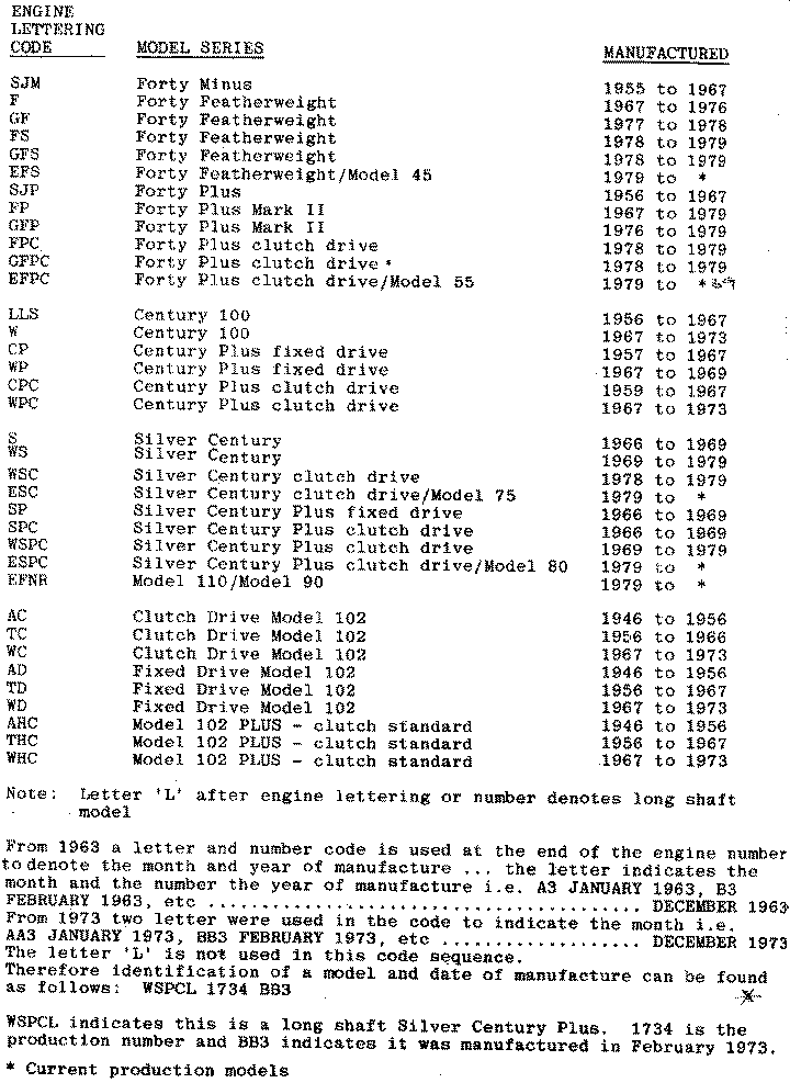

Year Manufactured |
Model |
Series |
| 1955-67 | SJM | Forty | Minus |
| 1967-76 | F | Forty | Featherweight |
| 1977-78 | GF | Forty | Featherweight/Bing Carb |
| 1978-79 | FS | Forty | Featherweight |
| 1978-79 | GFS | Forty | Featherweight/Bing Carb |
| 1979-84 | EFS | Forty | Featherweight/ Model 45 |
| 1956-67 | SJP | Forty | Plus |
| 1967-79 | FP | Forty | Plus Mark II |
| 1976-79 | GFP | Forty | Plus Mark II |
| 1978-79 | FPC | Forty | Plus clutch drive |
| 1978-79 | GFPC | Forty | Plus clutch drive
Bing Carb |
| 1979-89 | EFPC | Forty | Plus clutch drive/ Model 55 |
| For a couple of years the G
prefix denoted the Bing Carb, instead of the more normal Villiers, I have
heard conflicting reasons for this, suffice to say they went back to
Villiers till they replace it with the Amal 416, motors had an 'A' prefix
then!
Year Manufactured |
Model |
Series |
| 1956-67 | LLS | Century | 100 |
| 1967-73 | W | Century | 100 |
| 1957-67 | CP | Century | Plus fixed drive |
| 1967-69 | WP | Century | Plus fixed drive |
| 1959-67 | CPC | Century | Plus clutch drive |
| 1967-73 | WPC | Century | Plus clutch drive |
| The Villiers Carb was used on all the models above. the same carb on 102 cc and 64cc, no difference? How that works no one has ever explained, but it does make it easier to swop carbs about! John
Year Manufactured |
Model |
Series |
| 1966-69 | S | Silver Century | |
| 1969-79 | WS | Silver Century | |
| 1978-79 | WSC | Silver Century | clutch drive |
| 1979-* | ESC | Silver Century | clutch drive/ Model 75 |
| 1966-69 | SP | Silver Century | Plus fixed drive |
| 1966-69 | SPC | Silver Century | Plus clutch drive |
| 1969-79 | WSPC | Silver Century | Plus clutch drive |
| 1979-* | ESPC | Silver Century | Plus clutch drive/ Model 80/ |
| 1979-1996 | EFNR | Silver Century | Model 110/ Model 90 |
| The Amal 416 carb was used on some WSC and WSPC models, all ESC, ESPC and EFNR models. john
Year Manufactured |
Model |
Series |
| 1946-56 | AC | 102 | clutch drive |
| 1956-66 | TC | 102 | clutch drive |
| 1967-73 | WC | 102 | clutch drive |
| 1946-56 | AD | 102 | fixed drive |
| 1956-67 | TD | 102 | fixed drive |
| 1967-73 | WD | 102 | fixed drive |
| 1946-56 | AHC | 102 | Plus - clutch standard |
| 1956-67 | THC | 102 | Plus - clutch standard |
| 1967-73 | WHC | 102 | Plus - clutch standard |
| * Current production models (as of 1989?) Some of these models carried on till the early 1990's, the EFNR till the end in 1996. The 102 used the Amal 2 jet carb exclusively. However, the replacement if it failed, in later years, was the 416, so some may have been changed. Strangely enough that carb will run reasonably happily on 10:1, which older, pre 1968, motors should run on. John |

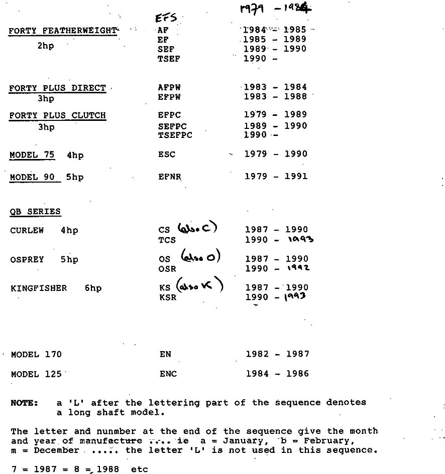

Year Manufactured |
Model |
Series |
Gear Oil |
| 1983 to date | GEF | Forty | Featherweight/Bing carb | SAE140 |
| AF | Forty | Featherweight/Amal 416 | SAE140 | |

| Note a 'L' after the lettering part of the
sequence denotes a long shaft model. 7 = 1987, 8 = 1988, 9 = 1989, 0 = 1990, 1 = 1991, etc. |
Sealed box Seagulls can be recognised by an extra screw in the gear box casing just above the top gearbox cap screw. This screw secures the bearing assembly.

| 1979-84 | EFS | Forty | Featherweight/CD ign | 1-2 |
| 1984-85 | AF | Forty | Featherweight/Amal carb/CD ign | 1-2 |
| 1985-89 | EF | Forty | Featherweight/CD ign | 1-2 |
| 1989-90 | SEF | Forty | Featherweight/Sealed box/CD ign | 1-2 |
| 1990- | TSEF | Forty | Featherweight/Twistgrip/CD ign/sealed box | 1-2 |
| 1983-84 | AFPW | Forty | Plus - direct drive/Amal carb/CD ign. | 2-3 |
| 1983-88 | EFPW | Forty | Plus - direct drive/CD ign | 2-3 |
| 1979-89 | EFPC | Forty | Plus - clutch drive/CD ign | 2-3 |
| 1989-90 | SEFPC | Forty | Plus - clutch drive/sealed box/CD ign | 2-3 |
| 1990- | TSEFPC | Forty | Plus - clutch drive/Twistgrip/sealed box/CD ign | 2-3 |
| 1979-90 | ESC | 75 | Clutch/CD ign/sealed box | 4 |
| 1979-91 | EFNR | 90 | FNR/CD ign/sealed box | 5 |
| 1987-90 | C | Curlew | Clutch/CD ign/sealed box | 4 |
| 1987-90 | CS | Curlew | ditto | 4 |
| 1990-93 | TCS | Curlew | ditto plus twistgrip | 4 |
| 1987-90 | O | Osprey | FNR/CD ign sealed box | 5 |
| 1987-90 | OS | Osprey | ditto | 5 |
| 1990-92 | OSR | Osprey | ditto but roller big end | 5 |
| 1987-90 | K | Kingfisher | FNR/CD ign sealed box | 6 |
| 1987-90 | KS | Kingfisher | ditto | 6 |
| 1990-93 | KSR | Kingfisher | ditto but roller big end | 6 |
| 1982-87 | EN | 170 | FNR/CD ign/Sealed box/weak big end! | (Approx 7.5) |
| 1984-86 | ENC | 125 | Clutch/CD ign/sealed box/weak big end! | ? |
| *HP represent the manufacturers HP model
