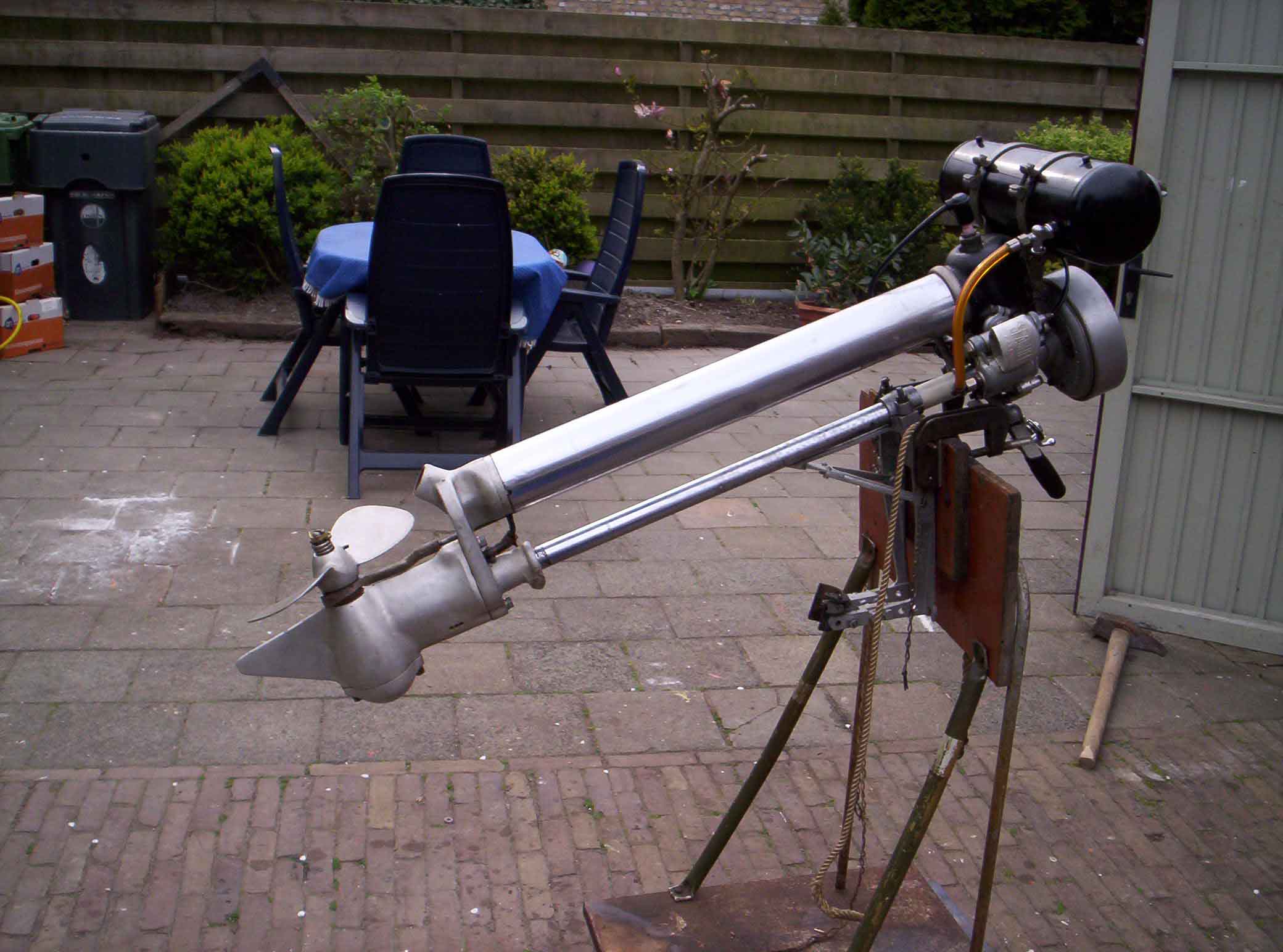

  this pic shows what I believe to be a 102 AC series.  Kees Jan Weigmans sent this one in, note the two bladed prop. I think the carb bowl is back to front, but it looks to be all intact.
